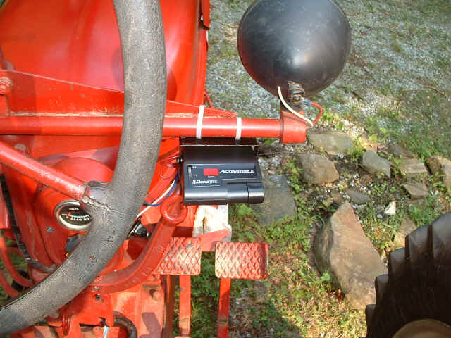

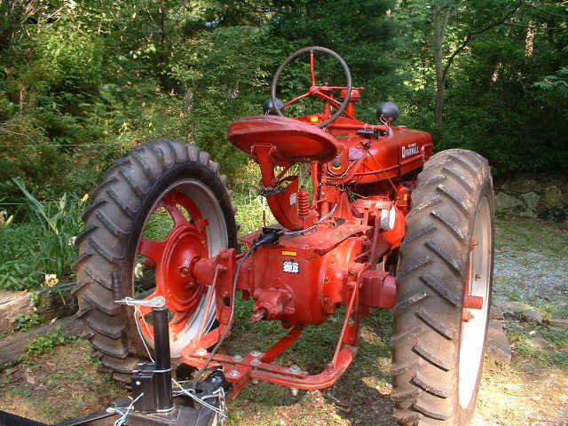

/ Subcut Maximum Towing Capacity #9
tow capacity has to take into account braking. I'm sure most tractors can pull more then they can relaibly stop.. :)
soundguy
So when you're pulling something heavy and precious you have to take extra precautions.
Wm
