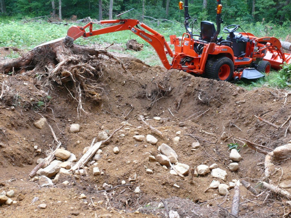

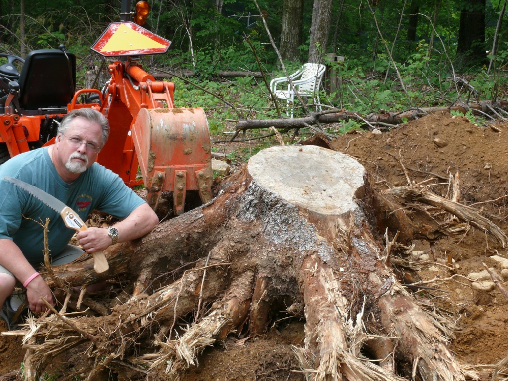

Some guys like having a picture taken with their Black Marlin, or a big elk. For me, this has been my personal "white whale". I've worked on this stump for several days trying to get it to budge. Several times, I was tempted to push the dirt back in the hole and give up on it. I finally had to get in the hole with a digging bar and expose the tap roots that were under the large support roots that provided good shielding. I then got my trusty limb saw and cut as many as I could get to. Then using the hoe, I literally twisted the stump in the hole breaking the remaining small roots and dragged it out of the crater that I created. I have a few more of these, only larger, and I'm debating whether or not to take them on.

Breaking roots that size can be tough on our smaller backhoes. I'd suggest the ripper sold by bro-tek.
/ Stump pullin'..... #3
I would go rent a L39 pull 1 stump with it.
Then you could show the boss that you need a bigger machine
And more $$$$$$$$$$$$$$$$$4
/ Stump pullin'..... #4
After tackling a couple of pine stumps a lot smaller than that I called the stump grinder in and had the rest ground off a few inches below ground.
Unless you just want to make a time consuming hobby of stump pulling I would consider a stump grinder.

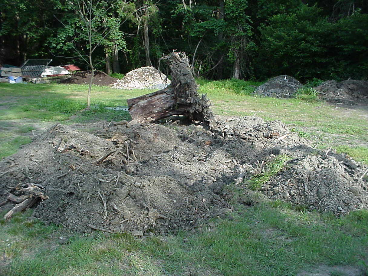

Here's a stump I pulled last weekend. Took about 2 hours from start to finish, with help from my chainsaw. Worst part was pulling it out of the ground, gave the BX fight. Felt good to get it out :D

Slow and steady win the race they say...in your case its true,sure hope that's the last biggest stump you needed to remove.
/ Stump pullin'..... #7
Don't it feel good to see that thing laying on top of the ground. After a victory like that it doesn't make much difference how much fight was in that stump, you had more determination and you won!
The amasing thing is how small of a root can keep a stump in the ground.
Good job.

The first day I used my new bx24 stumps were high on my list. After 45 minutes spent on two stumps. One really small hardwood still partually a live cut flush last year, another heartpine old, dead a year. I realized the bx24 backjhoe is best for digging dirt, stumps are mostly out of its league.
The best strategy is did out around it (by hand is faster) and cut flush with chain saw or just hire someone with a stumpgrinder.

As the excavator was in the shop, I used my trusty L-39 to yank 6 stumps ranging from 6" to about 13-14". The worst pair were about 36" apart on center, one was say 13" diameter and the other 8"-9" with roots all grown together. I could not get the stumps from 360 degrees, maybe just 220 degrees. While the smaller ones came out reasonably quick, those two took about + 1-1/2 hours. Finally came out as one root ball. I had to wack the dirt off it to make it light enough to pull them out of the hole and toss them down the gully.
There are two stumps remaining, about the size of the one in the photo. I plan on leaving them where they are as they are at the edge of the drop off, not near the pad. Even my excavator would have to work at them, so let them rot.
The little BX should not be used to pull stumps the size or bigger than what is the photo.
