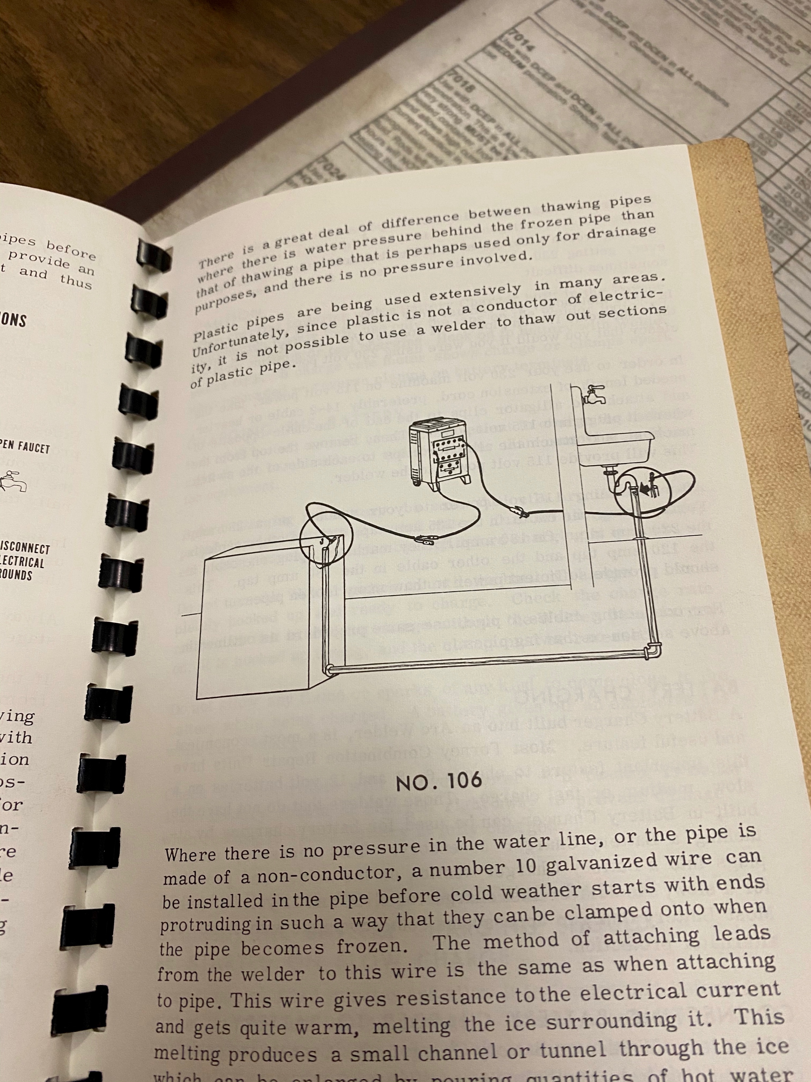

I was once offered an ice melting transformer, and am kicking myself that I didn't take it. For putting current through steel pipes to thaw them. It makes me wonder what it would take to heat a pin like that with electricity?
/ Stuck backhoe pin #46
The old Fourney welder owners manuals had a page on how to use a welder to do that.
/ Stuck backhoe pin #47
/ Stuck backhoe pin #48
Could one make a pin red hot or would the leads and welder fail first? That is a terribly low resistance to put energy into.
Power (Watts) is equal to Voltage times Amperage. The voltage over the pin will be almost zero. The power (heat) in the pin will be almost zero Watts. There is more resistance in the leads/clamps than the pin, that is what will heat up.
/ Stuck backhoe pin #53
That is what I feared. I remember when we bought our JD with 640 loader. It featured cylinders which were "induction" welded. I never did find out what that process entails.
