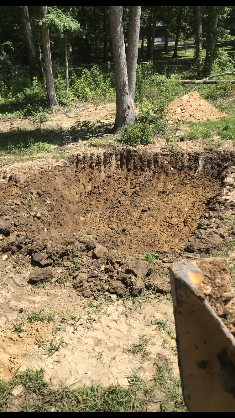

You should be in good shape then. You really need 2 operators. Start digging with the backhoe and moving the dirt with the bobcat. Cutting 1000 square feet a foot deep is only about 40 yards. That won’t take long. I dug and moved 5 loads ( 8 loose yards per ) out of this hole in a couple hours. IMG_7946.JPGIMG_7955.JPG
