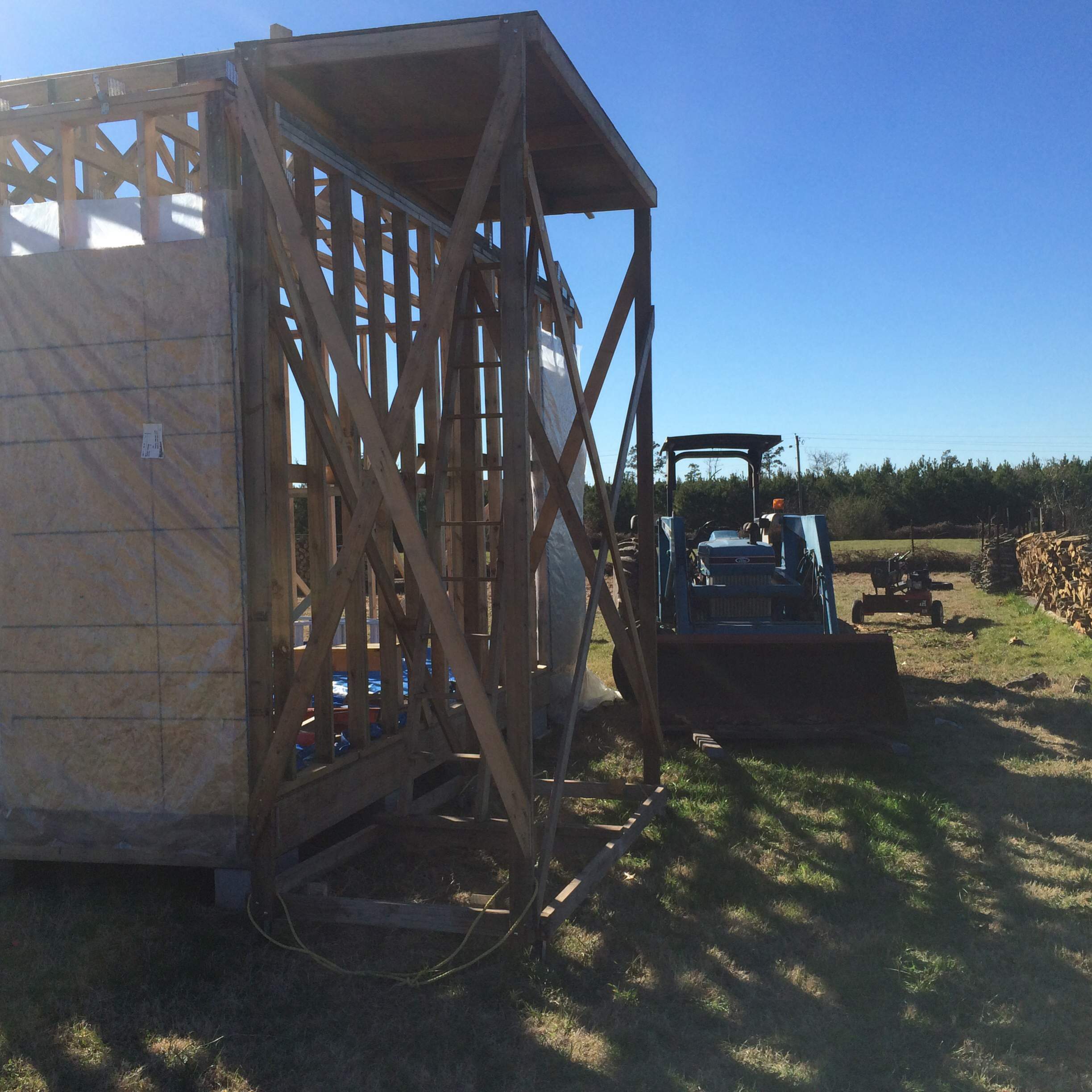

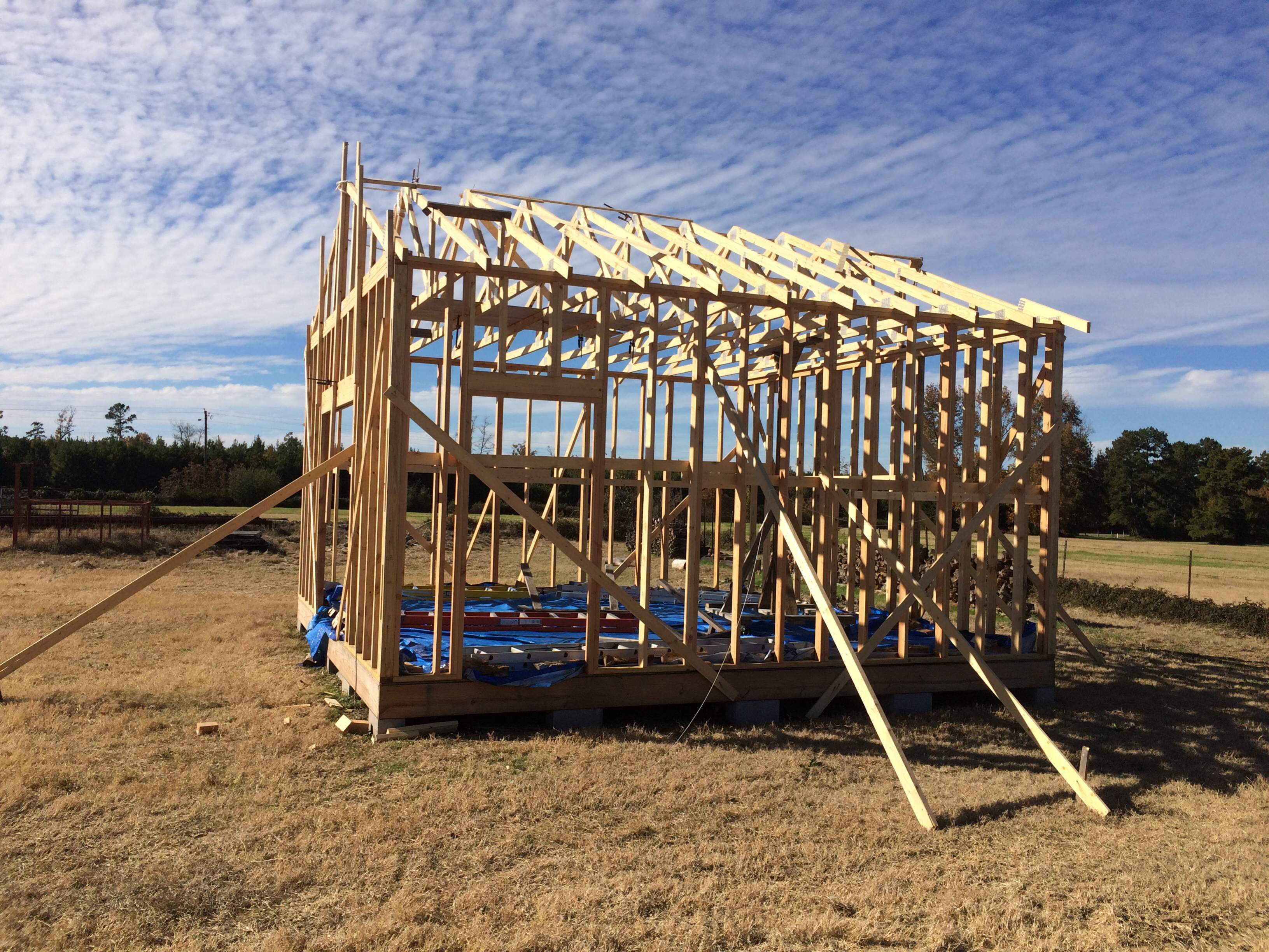

Farmer, no I do not have a build thread. Just to many projects going on to keep up with a build thread. Here are a couple of pictures. The first is just after I finished installing the roof trusses. Since that picture was taken I have straightened and braced the trusses, added the 4x8 corner bracing which you can see in the second picture.
The second picture shows two of my helpers. One is my tractor with FEL with forks. I could not have done this project, myself, with out it. Two is my portable scaffold. This allows me to work safely topside. It is on wheels and has ropes at each end. I can move back and forth along the wall. Depending on how it sets on the ground, I may tie off to the wall. I use the tractor to move it from wall to wall.

Et. What are the dimensions of your building? Looks good.
   / Stroage Building #37
It is 20x20x10. I am hoping to start the roof next week. I have to let a couple of rain days pass by.

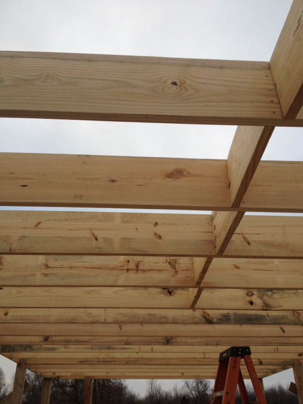

Got started putting up the floor joists. I was surprised by how much this thing has moved over the winter. We are having to pull and spread just to get things straight. The joist are up at the post. Going to try to finish them tomorrow. Maybe they will go up faster.

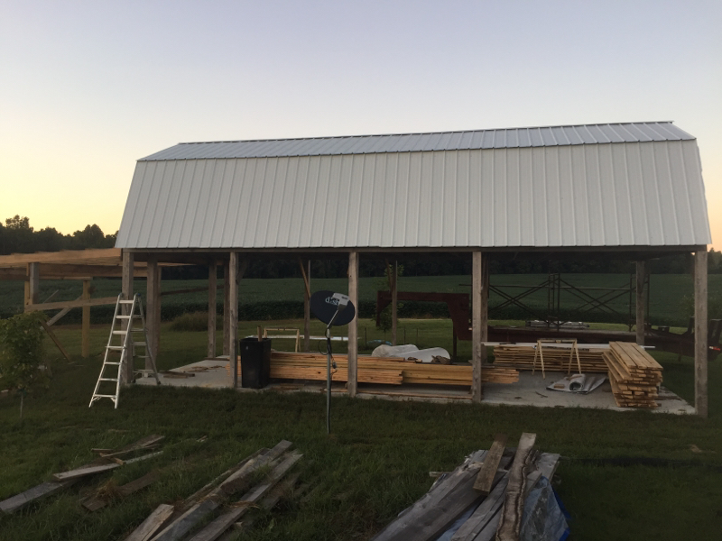

#40
All floor joist are in and joists hangers are installed. Did start on blocking the joists today. Have about a half a row done. I do have a question for you guys. How many rows of blocking would you put in? It's a 16 foot clear span with 2x12's. My original plans was for 3 rows. But after just installing part of the center row I was surprised at how stiff it became.
Latest pic.
