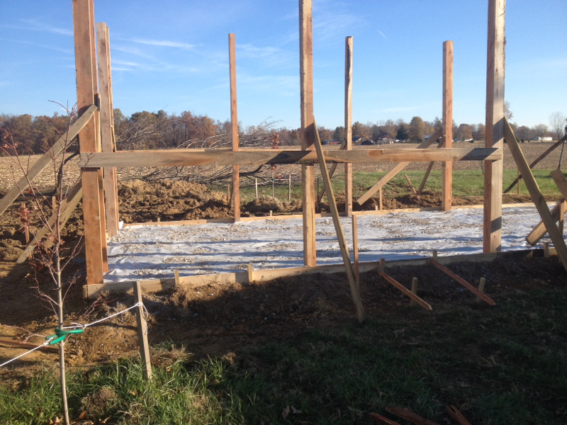

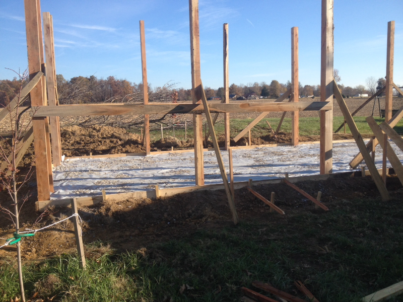

Had a break in weather and found time to get started on this again. Have the 2x12 ledgers up around the outside. All notched in. Some corner bracing in to keep the top somewhat square. And started to place the joist hangers. Although not particularly happy with the way they are turning out. Couldn't get them even and the little tabs that I thought were to hold it in place till you could get a nail out of your apron don't hold. Was trying to use a small block to set the size and position. Was hoping Eddie was still around. What am I doing wrong? Would I be better off nailing the joist up from the outside then going back and installing the hangers?

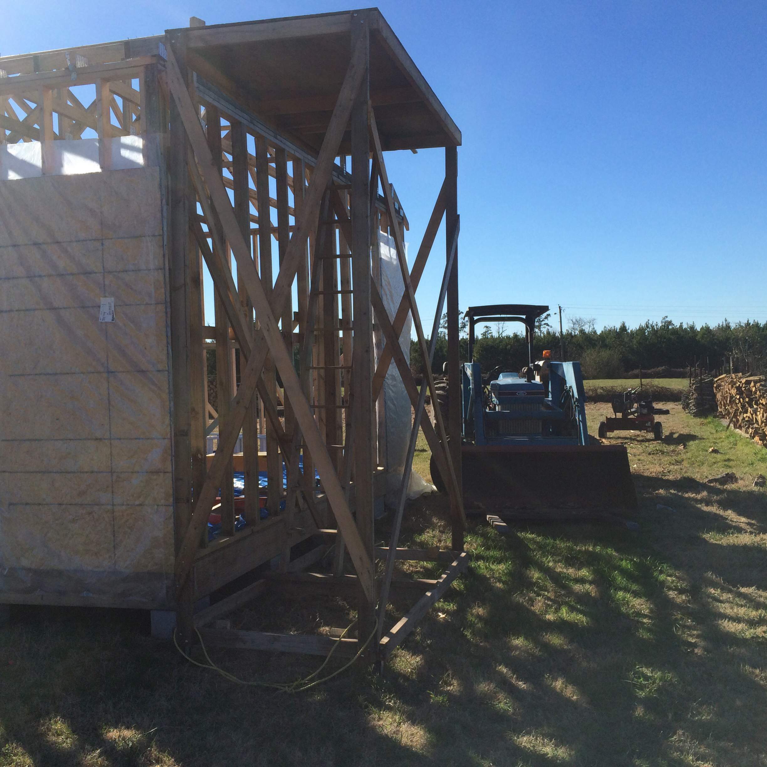

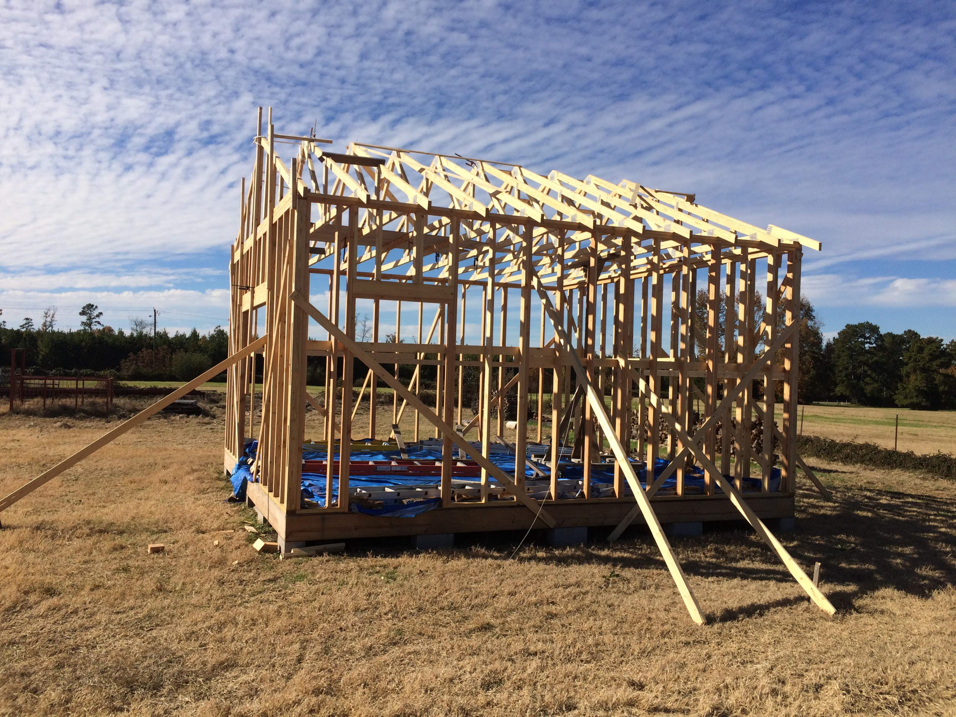

Farmer, no I do not have a build thread. Just to many projects going on to keep up with a build thread. Here are a couple of pictures. The first is just after I finished installing the roof trusses. Since that picture was taken I have straightened and braced the trusses, added the 4x8 corner bracing which you can see in the second picture.
The second picture shows two of my helpers. One is my tractor with FEL with forks. I could not have done this project, myself, with out it. Two is my portable scaffold. This allows me to work safely topside. It is on wheels and has ropes at each end. I can move back and forth along the wall. Depending on how it sets on the ground, I may tie off to the wall. I use the tractor to move it from wall to wall.
