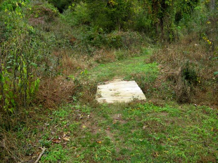

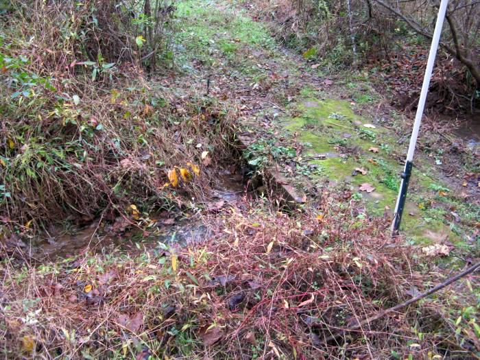

We've 2 stream crossings over a small stream that flows into Ivy Creek, which runs along most of the east side of our property. The little stream is mostly along the north side of the property.
I put in a tractor crossing and a people crossing. We had to move the people crossing when the territorial neighbor moved in and almost had to move the tractor crossing after all the floods of it in 2018.
Here's attached the tractor crossing, which consists of 5 or 6 four inch PVC pipes underneath some cemented rocks with tiles on top and a 4x4 across the upstream top to keep stuff in place. It survived the 10 to 12 foot deep flood in 2018, but my wife had to go down many times during 2018 and scoop muck from the upstream side of the PVC pipes. Because of this, we were entertaining moving it near the relocated people bridge, with 4 railroad ties all tied together with some 2 bys across. Friends at church had built tractor/truck crossings using 3 railroad ties. After 2018, the crossing has, again, posed no problem to maintain.

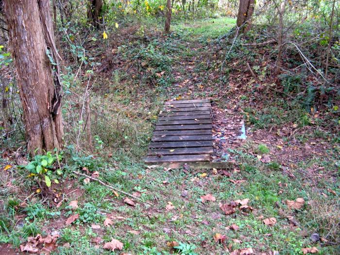

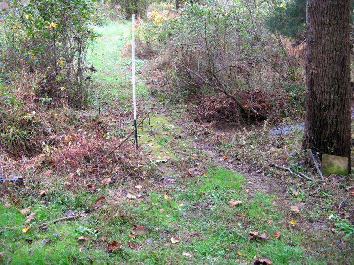

Here is the people crossing that was moved because part of it encroached upon the territorial neighbor's property corner. The people crossing is just 3 4x4s with 1 bys tying them together on top. One could just raise the 4x4s vertical and let them drop to the other side. Then work ones way across from one side to the other by screwing the 1 bys in place.
The other shot is of a people bridge my wife drug down from that territorial neighbor's property because it was across a dam overflow channel on his property. We put it where shown because that area kept staying mucky after a big rain.

/ Stream Crossings #3
How wide is the stream at the widest point of the crossing?
How deep is the stream at the deepest point of the crossing?
/ Stream Crossings
The stream at the new people bridge is 8 ft wide. Think it's a 5 or 5 ft deep trench but water depth is only 6 or 8 inches, normally. We'd had 2 big floods down there. One in 2004 was 6 or 8 ft deep over the bridges. The one in 2018 was 10 or 12 ft deep over the bridges.
The tractor crossing is about the same except that the trench is only a couple feet deep.
Ralph
