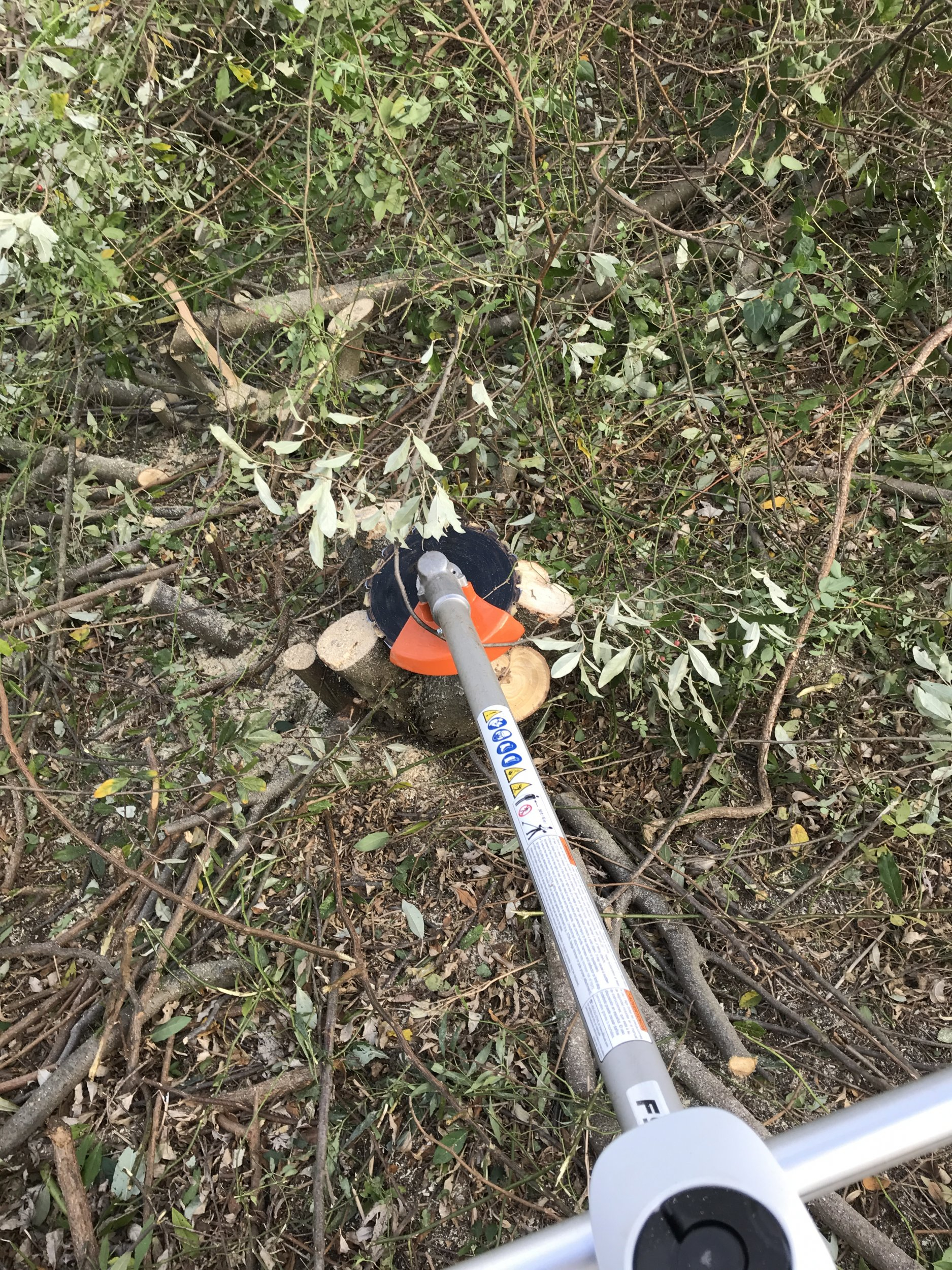

I have the big Kombi (131, IIRC). It's very good, but, as others have said, it's heavy for smaller jobs. It's a BEAST on the string trimmer. Ridiculous amount of power to do what you could do with 1/2 (or less) the HP and torque. Makes quick work though, if the string can take it. I have a string trimmer, pole saw, hedge trimmer and a blade trimmer for mine. The last one is the most used for clearing. I bought a string trimmer head and put a blade on it. This is what I have:
https://www.amazon.com/gp/product/B01AZZSQQO/ref=ppx_yo_dt_b_search_asin_title?ie=UTF8&psc=1
Now, let me say, this isn't an approved combo. Everything fits perfectly, but, you do this at your own risk.
This is by far the most terrifying tool I have. The Kombi has so much power, and that blade moves so fast. And there's no stopping it, I wear Kevlar, but I'm not convinced it would stop that like it would a chainsaw blade. The whole setup just gives me nightmares. But OMG, what a clearing tool. Any tree up to 3" or so, it cuts through like it's not there. Just swing it into the tree and its through before you can blink. I often cut the tree 5-6 times in a row to wind up with smaller pieces, I can do it before you can make the first cut with a hot saw. It's just so fast and so good that I brave the danger. It's the kind of setup that makes OSHA cry when they realize you can fit a circular saw blade on a string trimmer. And that people actually do it!
Stihl also has a forestry cutter, which is basically the thing that I built, but has a handlebar mount instead of string trimmer. I'd MUCH prefer that, but, the price is outrageous and I don't use my "blade of death" that often. But if "brush" in your world has 1-3" trees in it, well.. This is fastest (note, I did not say BEST, just fastest) way to get it gone outside of a mulching head on a 100HP skid steer. I'm very, very happy with the combo, it works wonderful for me, and the Kombi motor is great. The only person I wouldn't recommend the Kombi setup to is a professional because they are probably "hour limited", IE, they will use it enough to wear out the engine, so you might as well just get more tools and spread the usage out. For a homeowner? I think it's better because you run it more often, you'll never put enough hours on it to wear it out, but you sure can break it by letting it sit too long if you had 5 tools/engines instead of 1!
