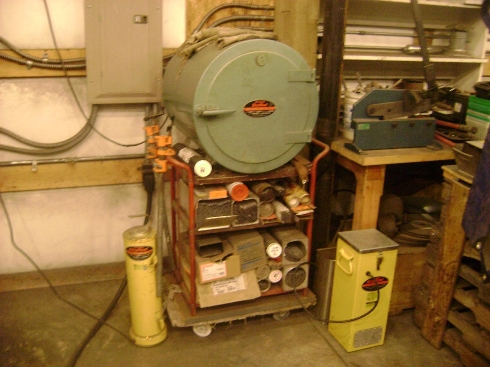

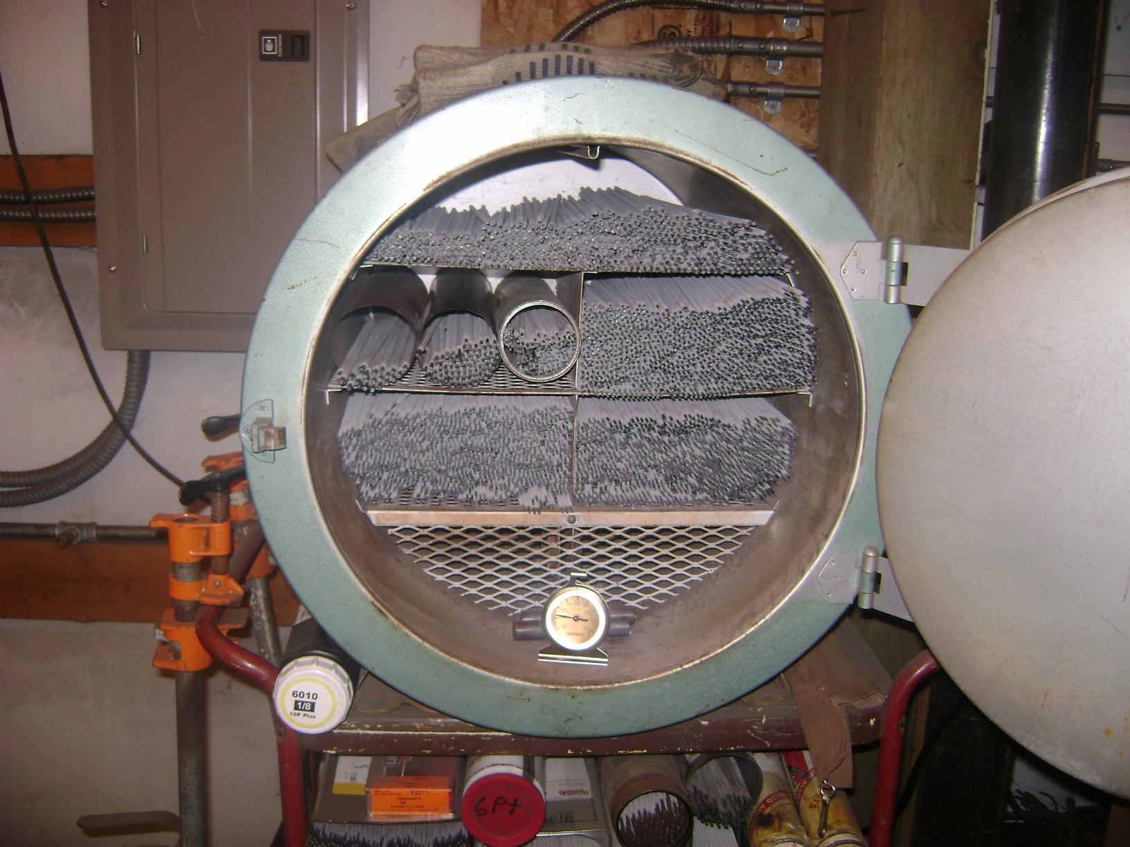

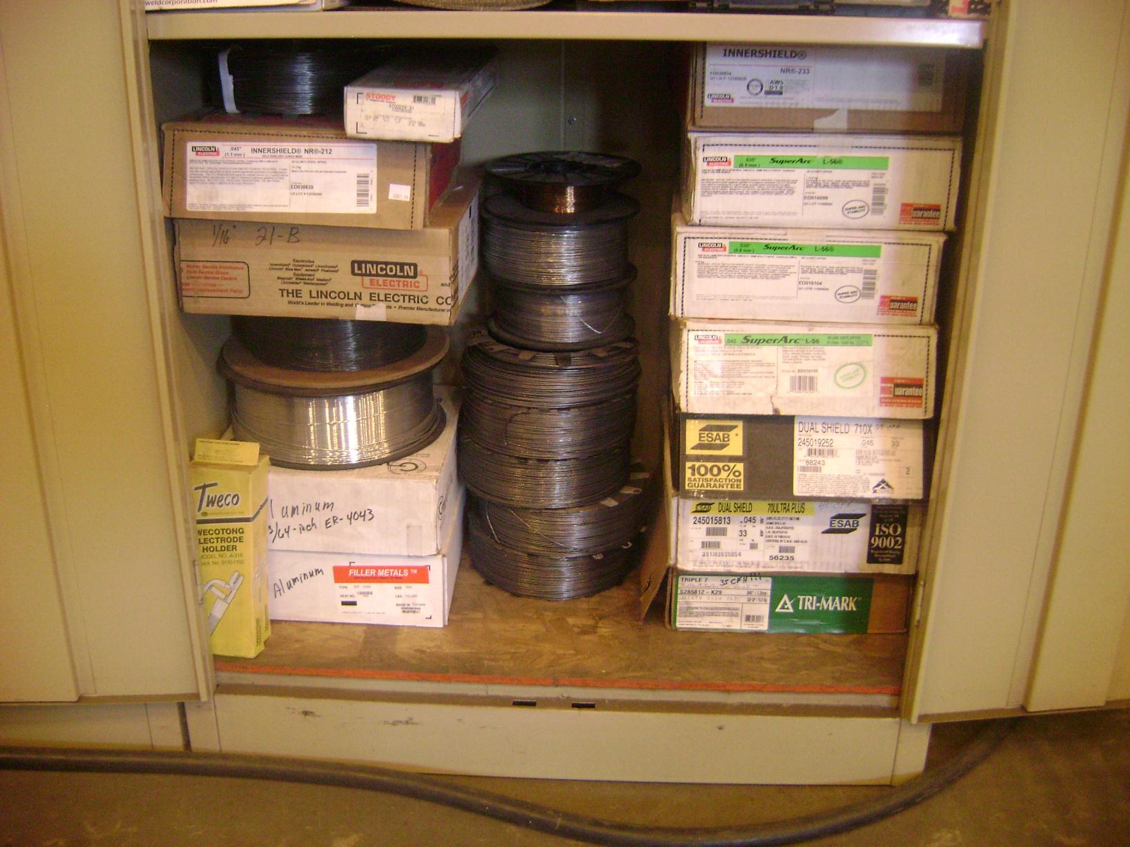

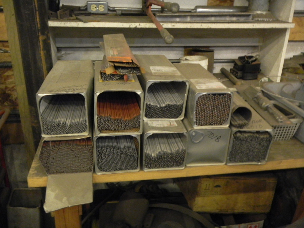

I'd say unless you're working to a WPS, there are no rules! It's what ever you can handle. But when you get out on the job site and everybody is running 5/32 7018 vertical up hill and you're running 3/32 you'll have to work through lunch, and stay late to keep up!:laughing:
I think my hobby shop is pretty well set up, I have maybe a 5# box of 1/16 rod under the rod oven, and maybe 15 #s of 5/32 7018 left over from a project. I mostly have 3/32, and 1/8 6010 / 11, and 7018. But I do have a can of 3/16 6010 to wake up those SA-200s when they've been setting awhile.:D
