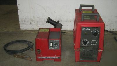

Are you sure it is virtually the same welder now? Seems I rember reading somewhere that Miller actually bought the PowConn's out and used them as the basis for their first generation Inverter platforms.
Yep. Miller bought powcon. In the late 90s the founder of powcon started making arcon welders, using the same technology as the old powcons. (this was after the patents expired) They are build exactly the same as the old powcons. Here is a link to their site. ARCON Welding - Portable Arc Welding Equipment

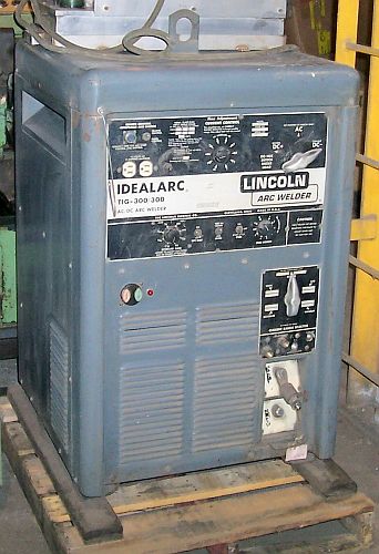

Any recomendations about $3000 less then that? :laughing: I dont mind waiting for a while until I get enough cash for something good, I live by the policies ''buy it once'' and ''find the most you will ever need, and get the next model up'' :laughing: Another machine I have been thinking of is a used miller xmt 304. The only reason I am looking at inverters is I am short on space, and only have 30 amps of power. I always prefer old tools, and if my current shop wasnt the size of a garden shed, with 30 amp power I woudnt even think about getting an inverter. Something more like this.
Or this.
Oh well, just a few more years until I move out, and set up my own shop.

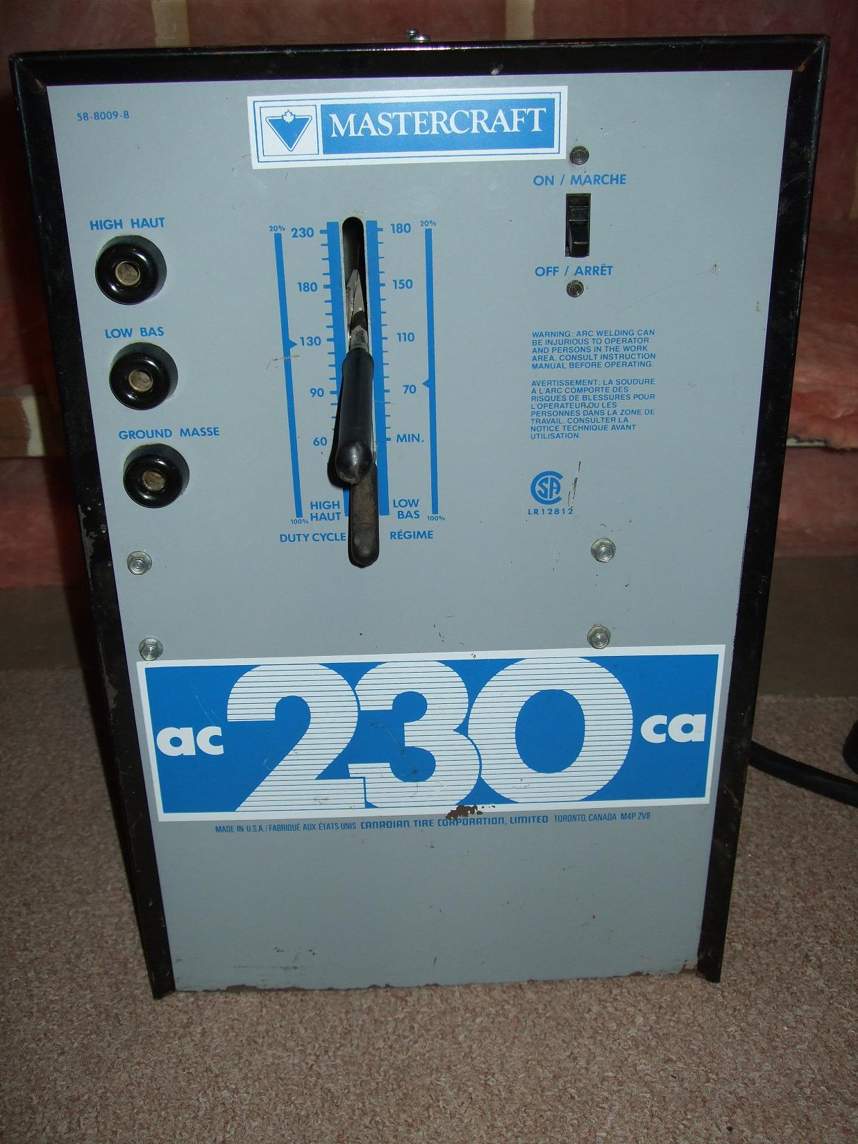

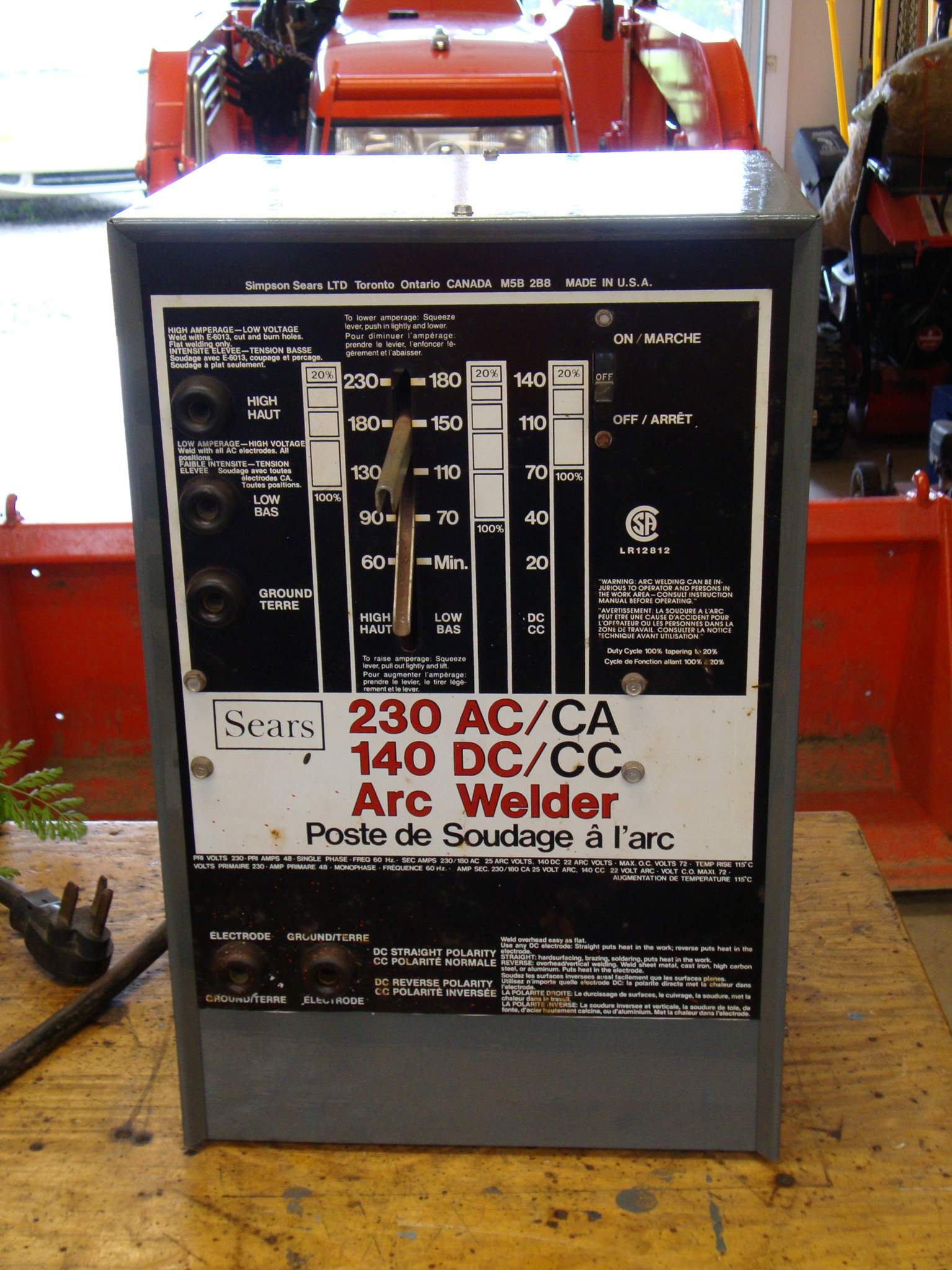

I've got one of the Sears branded Century AC/DC welders as well. I got it well used, and the price was right. Nice little machine for the money. About the only complaint I'd have about it is the adjuster. It's a nuisance.
Sean

i never used a century.but i have used both tombstone and thunderbolt.i would always choose a thunderbolt over the tombstone.i do not remember any arc difference ,that crank on the thunderbolt makes it better.they need a 50 amp breaker for full power.i have used a xmt 304 it works good it has digital display .i would not hesitate to recommend a acdc thunderbolt for a farm shop welder.you could add a 110 Lincoln wire welder for thin stuff.those 2 welders should cover most farm welding needs but no aluminum .
/ Stick welding question #55
With most of these little buzzbox machines you often do not even need a 50 amp breaker. Most of them specified a 50 amp fuse because a fuse did not have time delay capabilites like a breaker can have. Most of these will only pull 37-40 amps at WOT, but there will be very brief milli-second spikes at higher amps hence the bigger fuse recommendations.
Another nice thing is that any of these can be easily powered with 10 gauge wire at up to lengths of 95 feet from panel. (Heck Miller manuals permitted even 12 gauge wire on shorter runs but I would never go that small. First thing I did to both of my buzzboxes was remove the small 14 gauge 4' factory cords that came on them and replace with 10 gauge cords salvaged from used clothes dryers) While 10 gauge wire is only rated for 30 amps continuous load it is NEC code legal to oversize the breaker with 50 amp breaker for a welder like these due to these particular units low duty cycle. (That said, oversized breaker on undersized wire means that safety steps are also required to ensure that the circuit is used for the welders like these only - IT CAN NOT be used to power any other equipment or even other bigger welders that may have higher duty cycles).
With either a 115 mig or an AC/DC buzzboxes then some very crude welding of aluminum is possible. The mig requires a teflon liner be installed in the whip and keeping the whip as straight as possible to avoid wire bunching - do expect wire feed problems and lack of oomph though out of a 115 volts mig on aluminum. There are also aluminum rods for DC arc welder that can work decent too for some aluminum applications. Either will produce somewhat crude results but if we limit to farm shop applications then it can easily work in a pinch although neither would likely be acceptable to a true welding professional. That said, in a farm shop we are often dealing with repairs so the weld only has to be strong and sound - looking pretty is just a secondary bonus item.

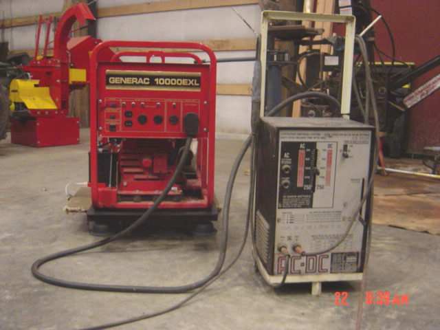

Well I popped the breaker with my tombstone today. 30 amp breaker, welding at 130 amps. I had just been welding at 145 amps and it was fine. I think the issue was either a really bad ground, or I did the impossible and killed a lincoln tombstone.
