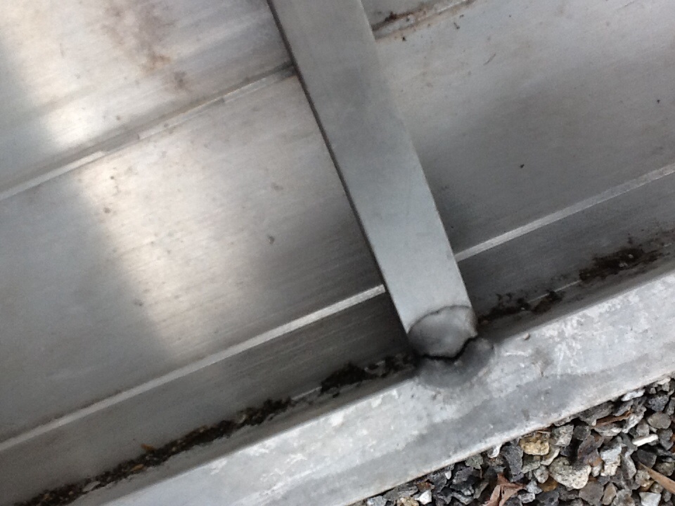

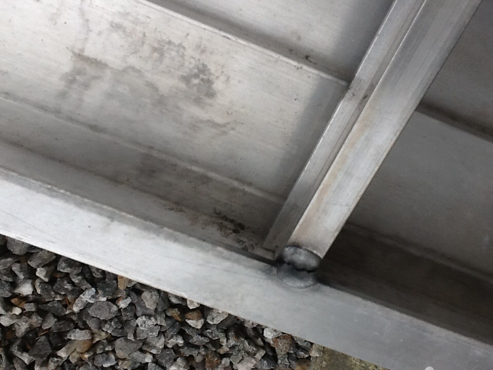

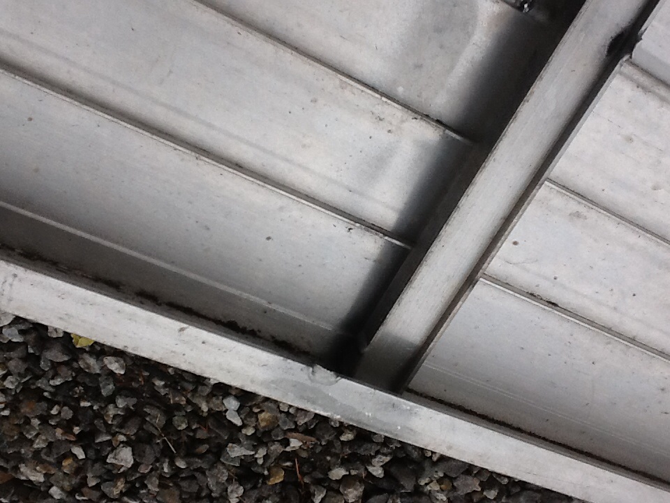

Figured it was a good thing for a newbie to try.

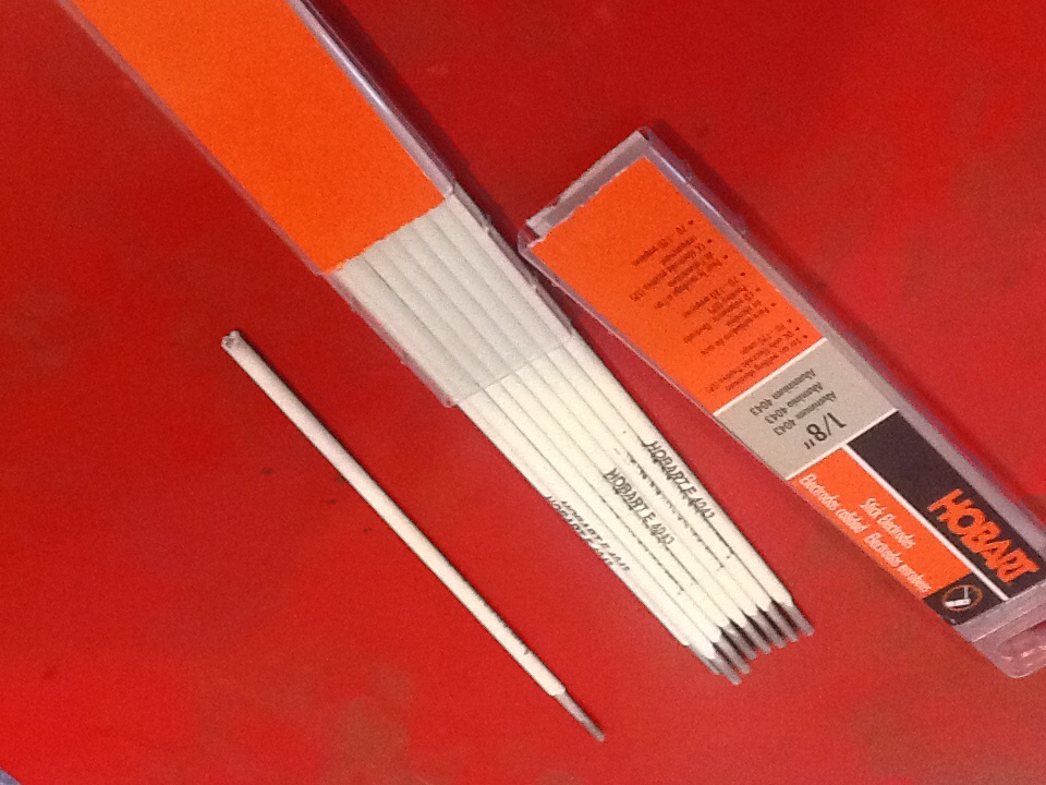

Here's the broken wheelchair ramp. Probably about 20 broken or cracked welds. And the hobart 4043 stick rods that I got on amazon for $15 delivered.
It took 2 and half rods to fix the ramp. So about four bucks. Saved over $150 vs having to replace it :) as this ramp was beginning to be not safe.

Yeah it's not ideal. But better than nothing.

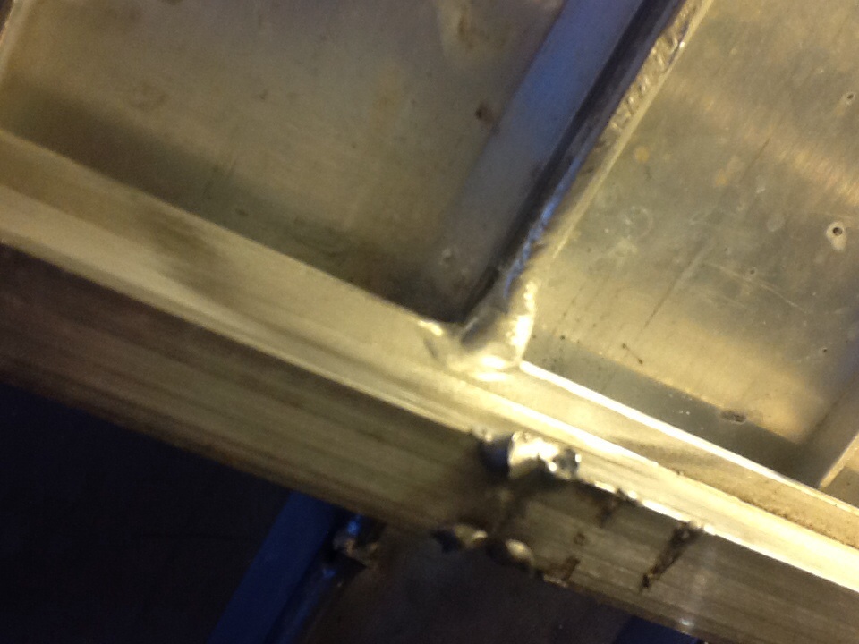

/ Stick welding aluminum

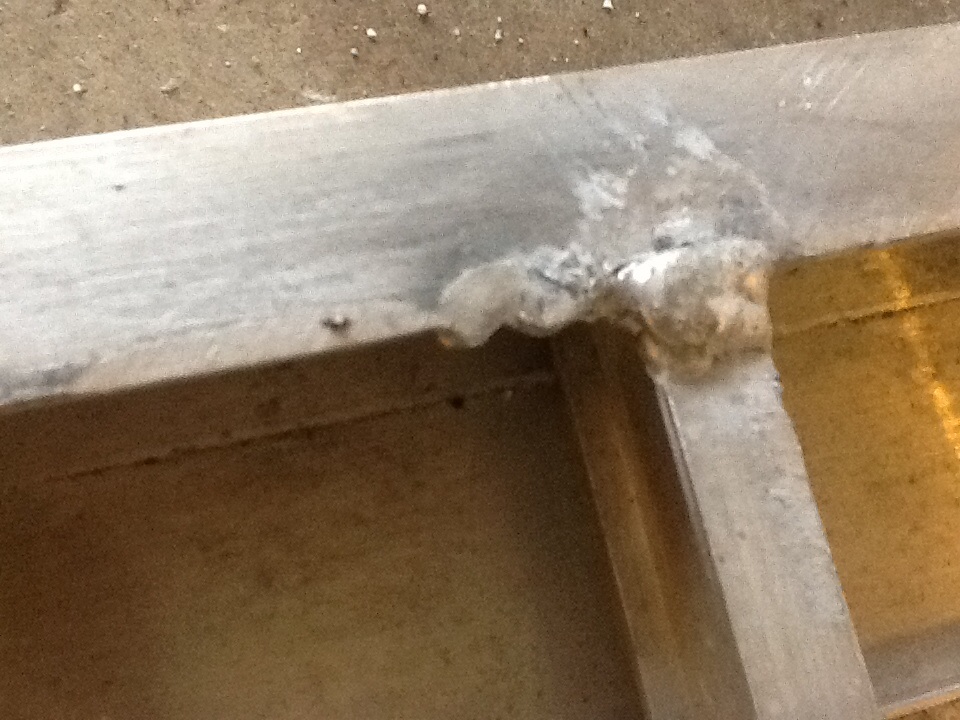

105 amps
Before I wire brushed the flux off. The mess to the left is the original weld

I have done some pretty decent welds on aluminum with a stick welder. You just have to follow the rod a lot faster and not be distracted. Ed
Up to 110 with better results
/ Stick welding aluminum #8
...and you most likely used a ferrous metal wire brush (which makes it even worse). Always wire brush an aluminum pre prep joint with a stainless steel wire brush no matter what process you use....

Yep, guilty as charged :(
Not really set up with the right stuff for aluminum. But the ramp is back in service... Jumped on it a few time and no broken welds. Much more solid then it was.

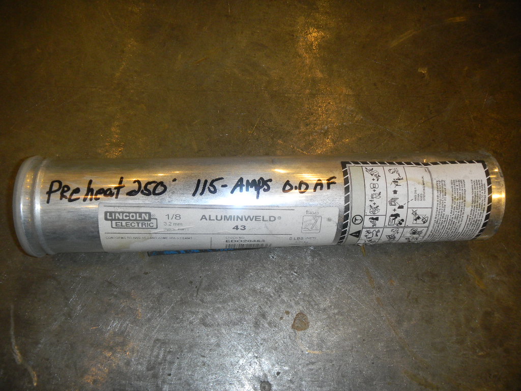

Couple things I learned. Just before welding use a stainless steel wire brush on the weld zone. And a little preheat helps too.

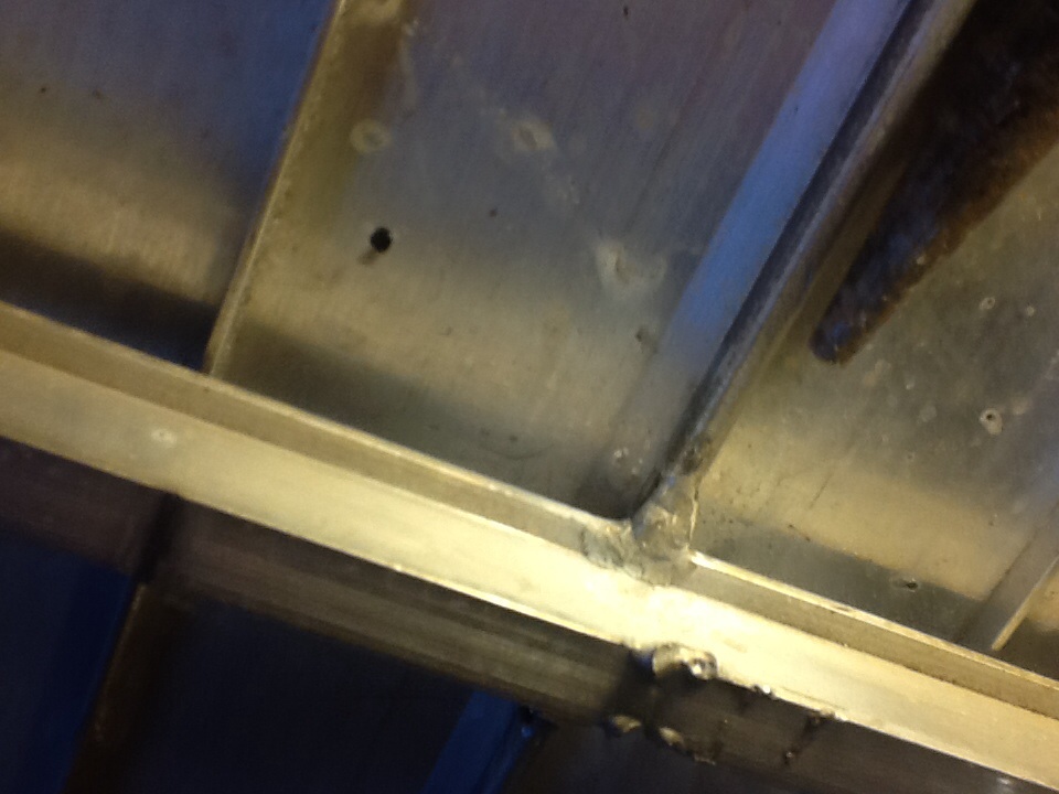

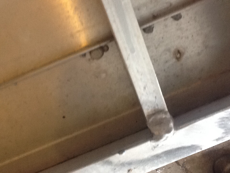

It's interesting you have it labeled 0.0 arc force. This was the first time I was wondering if I could have benefited from adjustable arc force.

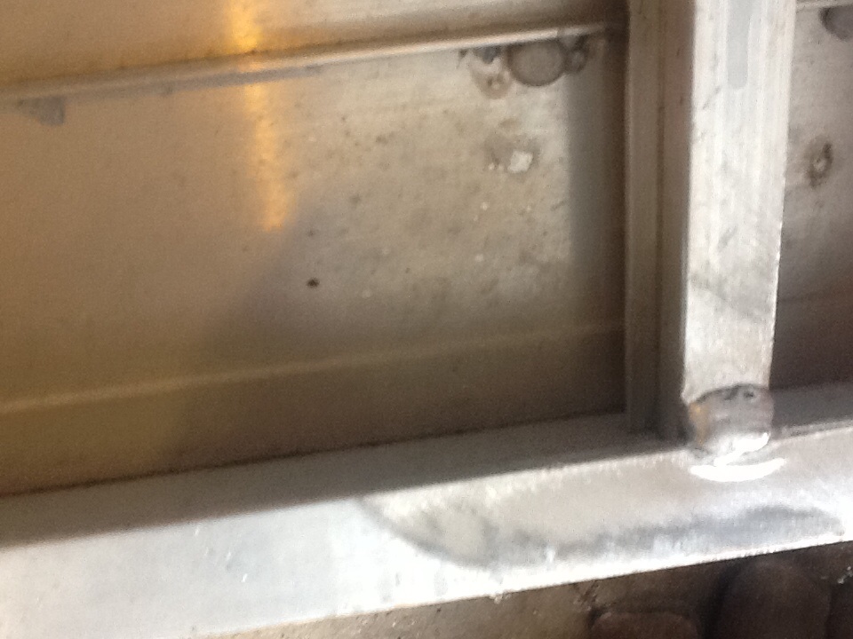

A couple more pics
117 amps

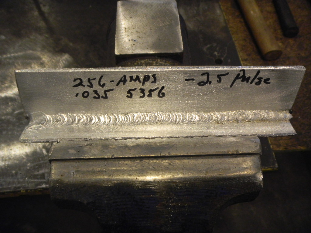

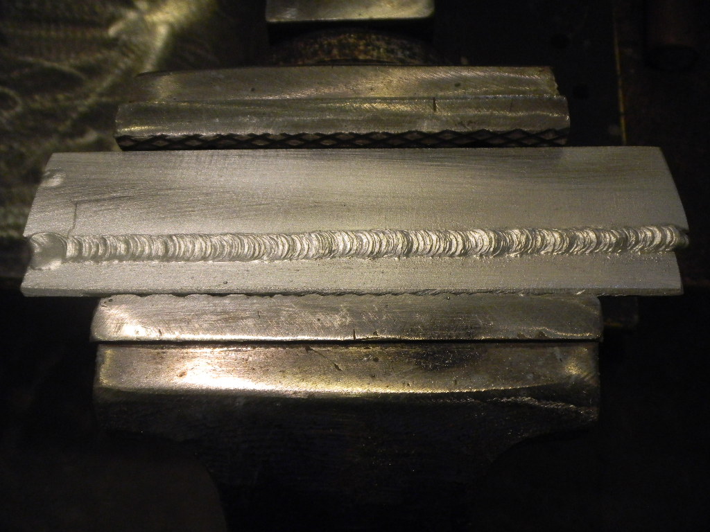

/ Stick welding aluminum #13
Personally I think a spool gun does a much better job.

I have used them in the past.
The learning curve is straight up!
KEEP the rods in a container! If you lay the rods down they will become wet in minutes!

That's no joke. I did a repair and left the remaining rods in the plastic container they came in. Next morning I had some overpriced short pieces of aluminum wire.
