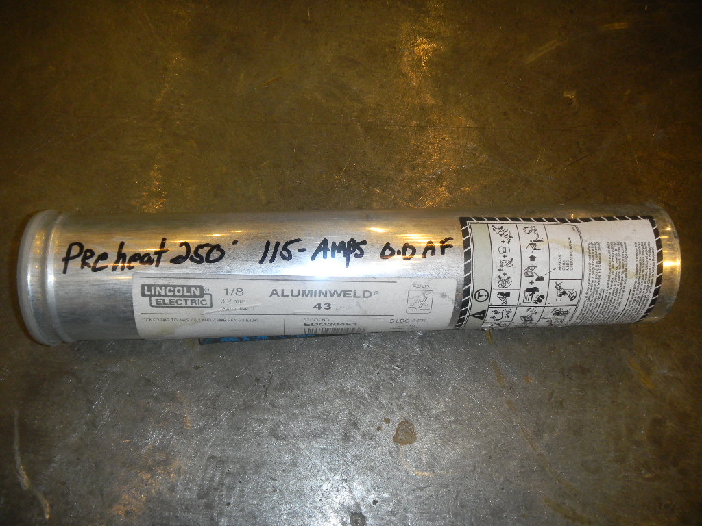

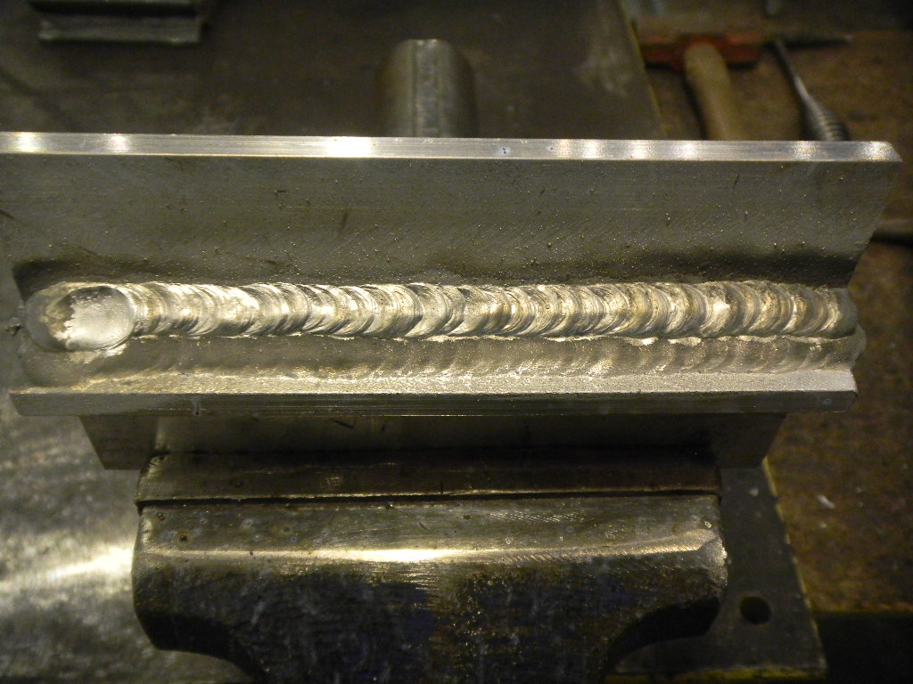

Couple things I learned. Just before welding use a stainless steel wire brush on the weld zone. And a little preheat helps too.

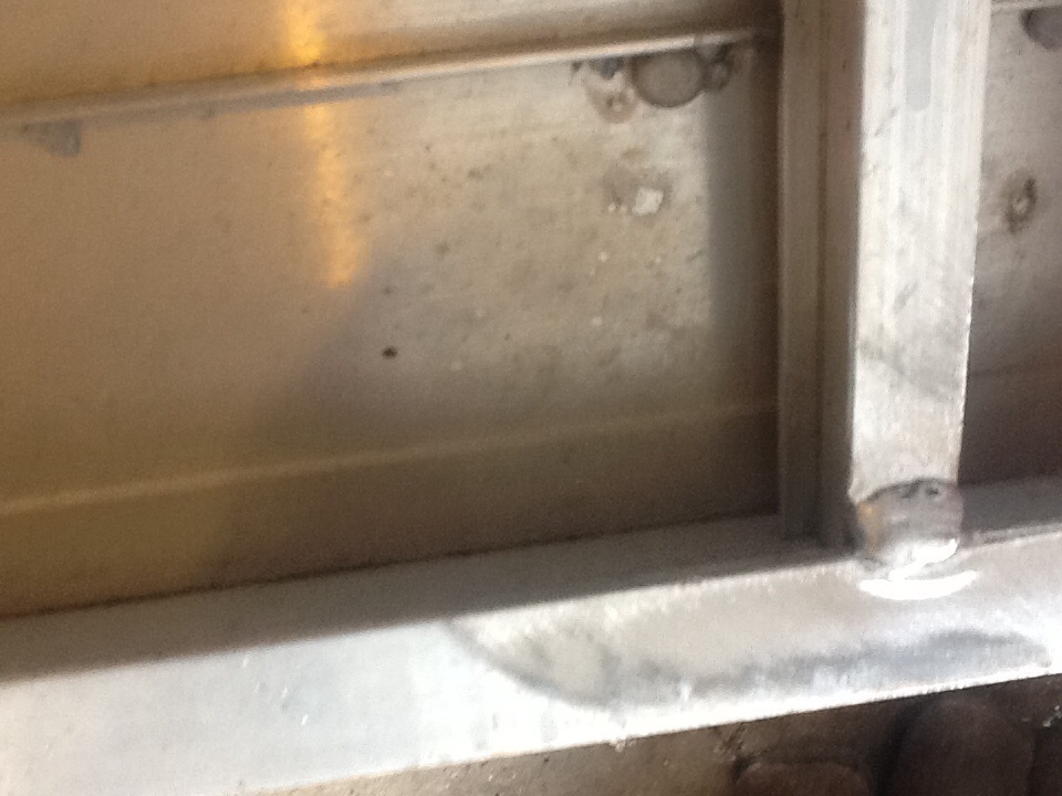

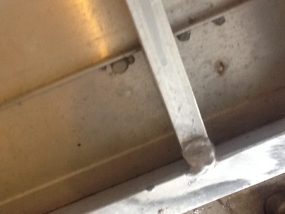

It's interesting you have it labeled 0.0 arc force. This was the first time I was wondering if I could have benefited from adjustable arc force.
A couple more pics
117 amps

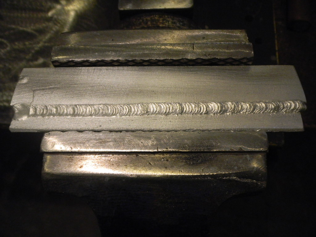

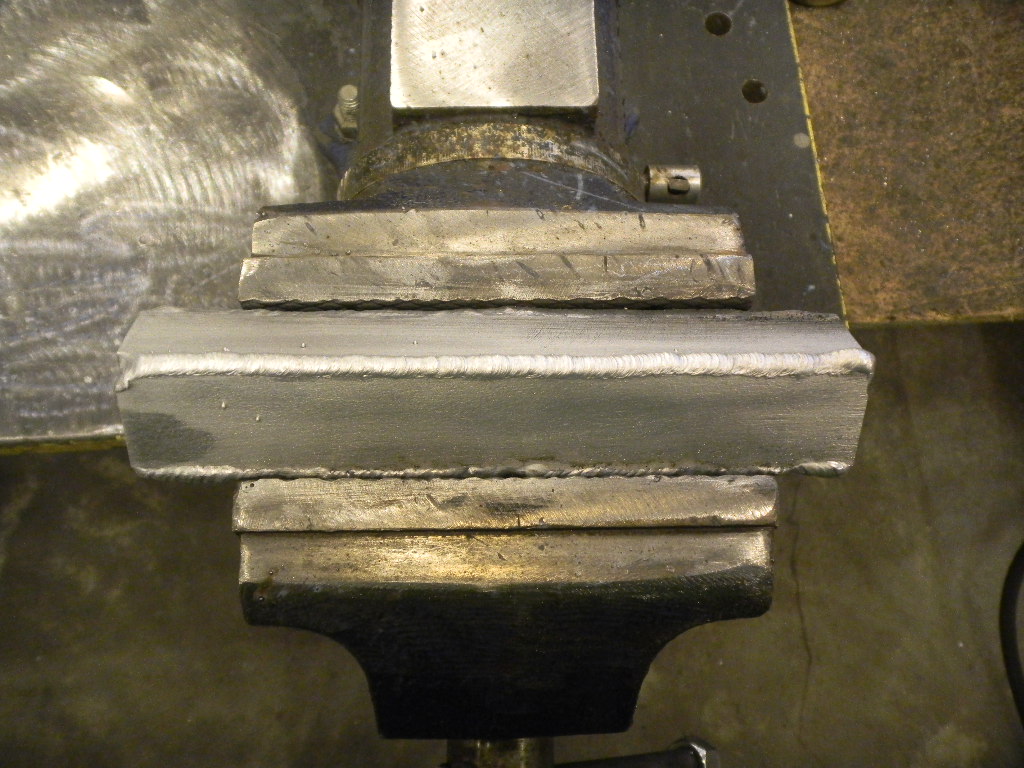

Personally I think a spool gun does a much better job.

I'm thinking the OP was just stating that for a small aluminum repair, aluminum stick is a cheap good fix. As far as aluminum mig welding goes, everybody that can mig weld steel, can mig weld aluminum, and it does come out a lot better, but to stick weld aluminum, you have to be good at stick welding, and then it's a challenge. Then you have the cost set up for aluminum mig welding.
I've welded a small aluminum project before with 1/8 stick on 1/4" thick angle bar, worked ok I thought, the welds was strong and lasted, I think I set my DC welder on DC straight, on the stop and starts, I cut the end of the rod for a better arc re-start.
Been kicking around an ESAB Pulsed Mig with a push-pull gun. I demo'd one here at the shop and the weld asthetics are amazing. TIG in appearance and 3 times the speed.

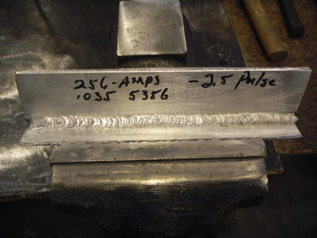

This was playing with the pulse when I first got my Lincoln V350-Pro welder.
