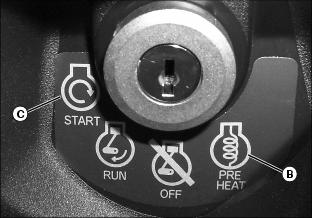

My new 3005 JD has me confused on starting procedure. It`s working fine, just that I do not understand the manual starting procedure on one point.
I understand pre heat etc, just that manual says "hold key in until engine runs smoothly, to keep glow plugs activated on initial startup"
I am holding key in but there does not seem to be a way to push it in? I push in there is no spring motion or anything?? Just trying to make sure I am not doing something wrong?
This is just in manual. On tractor itself it does not say, "hold in key"
Does the key actually push in and out, because I can`t feel anything happening when I push key in....
Maybe its just bad translation from Japanese language?? ANYBODY

/ Starting procedure for 3005/790 #7
Unless they have put a new engine in the 3005 that is a major error. This is what my 790 manual says.
1. Place gear shift lever and range shift levers in the N (neutral) position.
2. Depress clutch pedal all the way down.
3. Push hand throttle lever completely forward.
4. Activate the intake air heater system by rotating the ignition key switch to the preheat position (B), and hold it there for 20 seconds.
5. Rotate key switch clockwise to the start position (C) and start engine.
6. When engine starts, immediately reduce engine speed to 1200 - 1500 rpm.
7. If engine runs rough, repeat this procedure until engine runs smoothly.
and pictures of the key labeling attached. Is this what yours looks like?

/ Starting procedure for 3005/790 #8
Fred: that's how my starting procedure works. If I turn my key to "on", I can push it in to glow. It will also push in when it is in "run" (and running). However, it's very obvious as it's spring loaded. Maybe they just misprinted your manual? (I have no 3000 series knowledge :) )

/ Starting procedure for 3005/790 #10
The online manual for cold starting reads as other have described for your tractor. Here's a link to it. Seems your printed manual is different for some reason...
Your key switch looks like this, right?
#11
Yes just like that, and infact the directions on the tractor itself do not have the extra line"hold in key for glow plugs etc" but only in manual.
I just wanted to make sure I did not do any harm by missing a step.
Thanks to all for responding.
I emailed my dealer, I will report back, but obviously you guys know, so it is a mistake I am sure.
