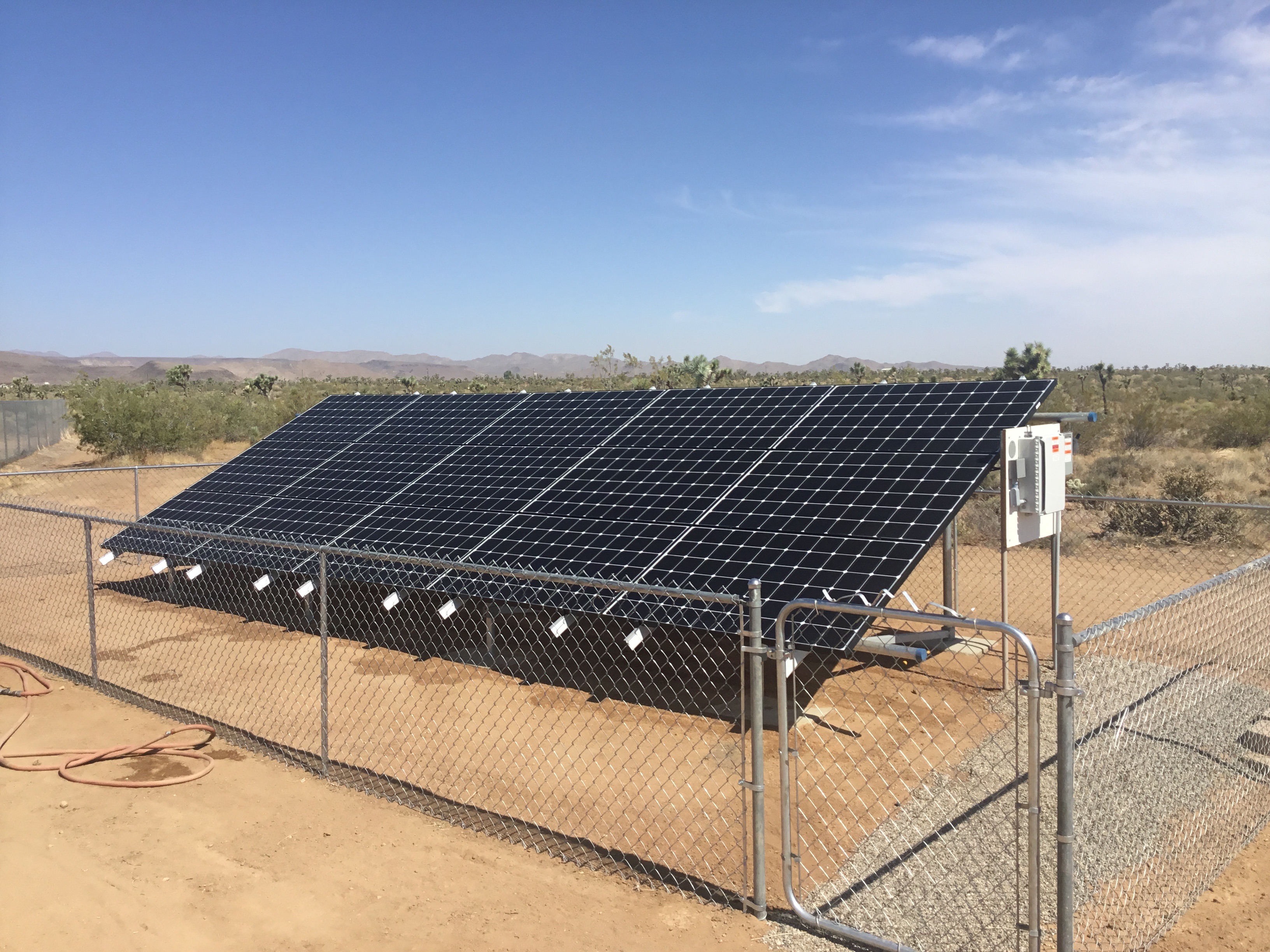

OP here. My total cost for electric in my first year was $165 for actual usage. In addition about $12 per month minimum to be connected to the grid.
I switched my water heater from propane because the cost is ridiculous because there are only 2 companies out here and they know they have a monopoly. About $3.65/Gal year round. I added three 380 watt panels and it looks like I will again break about even.
I switched my water hater from propane because the cost is ridiculous because there are only 2 companies out here and they know they have a monopoly. About $3.65/Gal year round. I added three 380 watt panels and it looks like I will again break about even.
That is fantastic and I am envious. I am in a wooded area with maybe 4-6 hours of direct light per day. I am using a waterstove to heat the house and the water heater. Wood for me is free. Past that, I hope to follow your lead and utilize solar power where I can. Thanks for starting this thread, I am going back now to thoroughly read each post.
