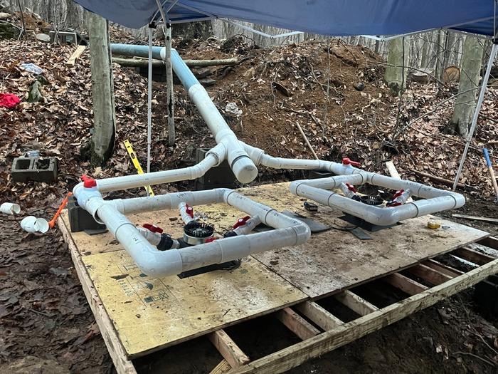

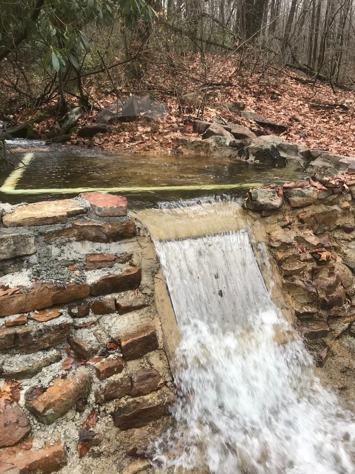

So I haven’t posted my progress in a while so I thought I’d update you guys.
I FINALLY got the leaks fixed which was difficult and to be honest a bit expensive . But I finally got the hydro online last week. I still have some issues with turbulent water entering the penstock at the Coanda box. I was losing all kinds of power from it during the night. But after building a baffle out of a piece of 8” pvc pipe to calm the water after it enters the Coanda box it seems to be working much better. I can make around 1.8 kw continuous depending on the flow of the creek. I couldn’t be happier with that. I combine that constant power with my 5kw solar array and my batteries are usually well charged.
As of right now I don’t have a few of my bigger loads on the critical load panel ( alt energy panel ) the hot water heater and the wife’s hot tub are two big ones. I am planning on buying a second Schneider inverter and solar charger to add those loads and be completely grid free.
If anyone has any questions or advice please chime in.
