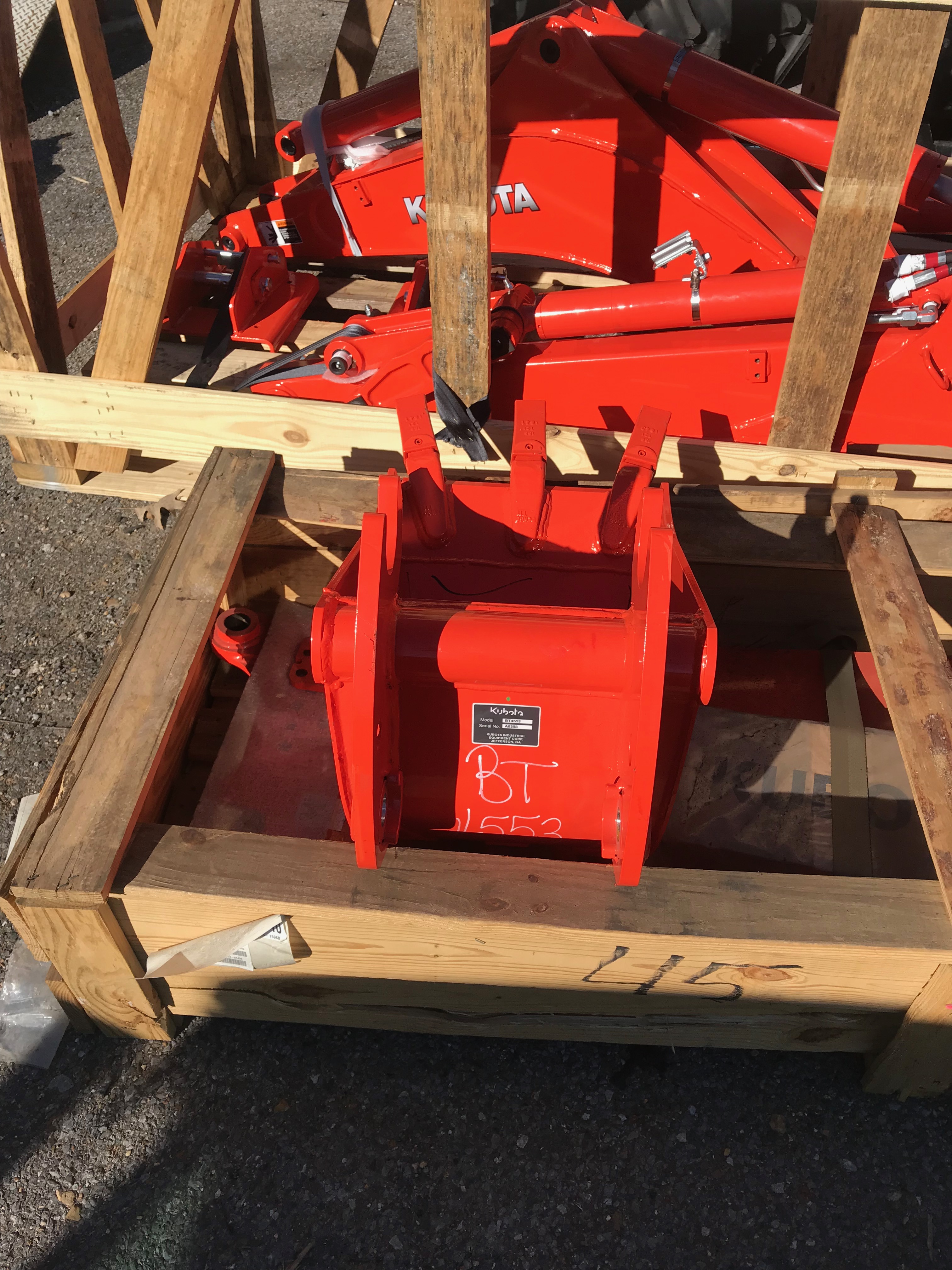

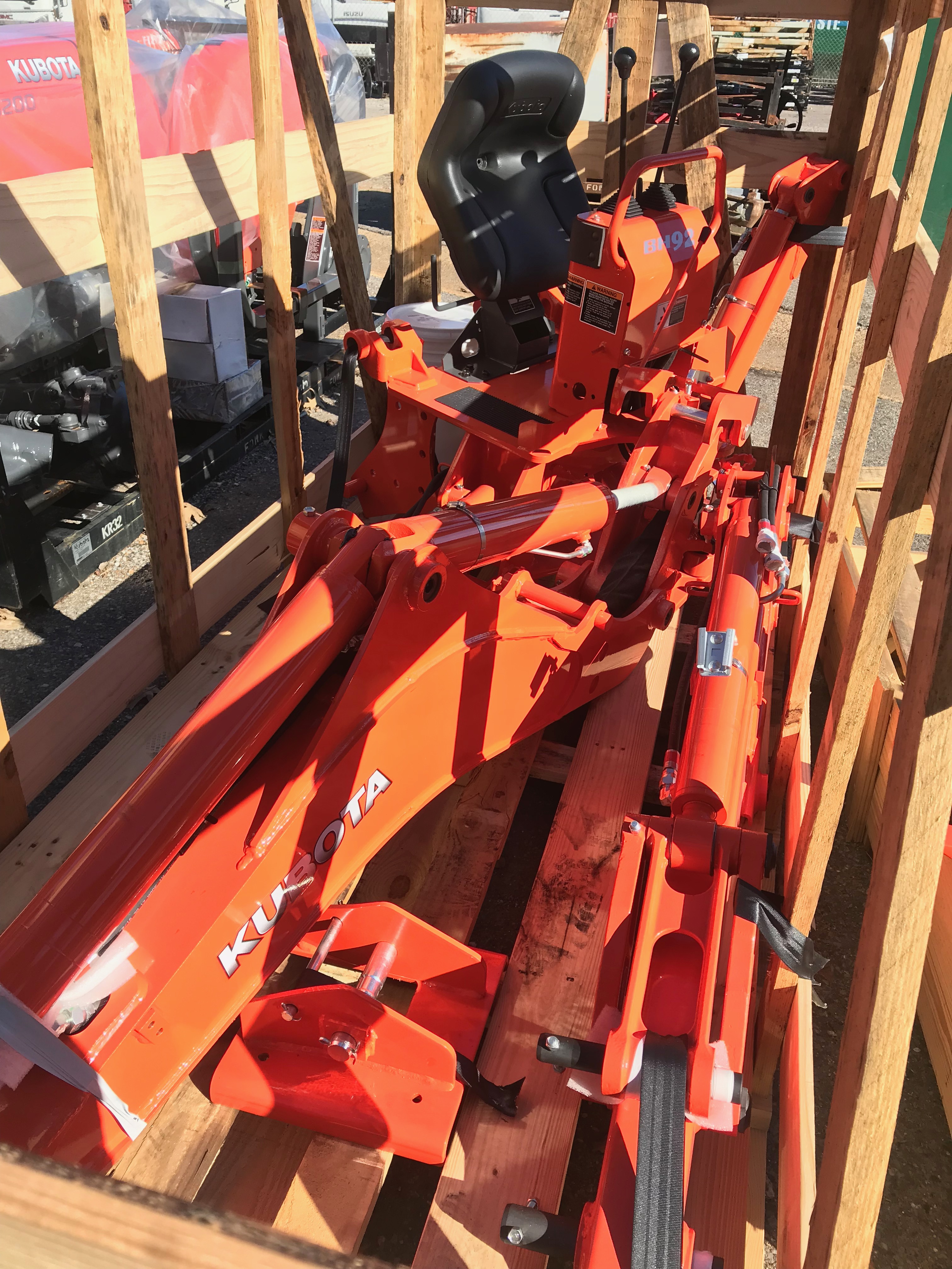

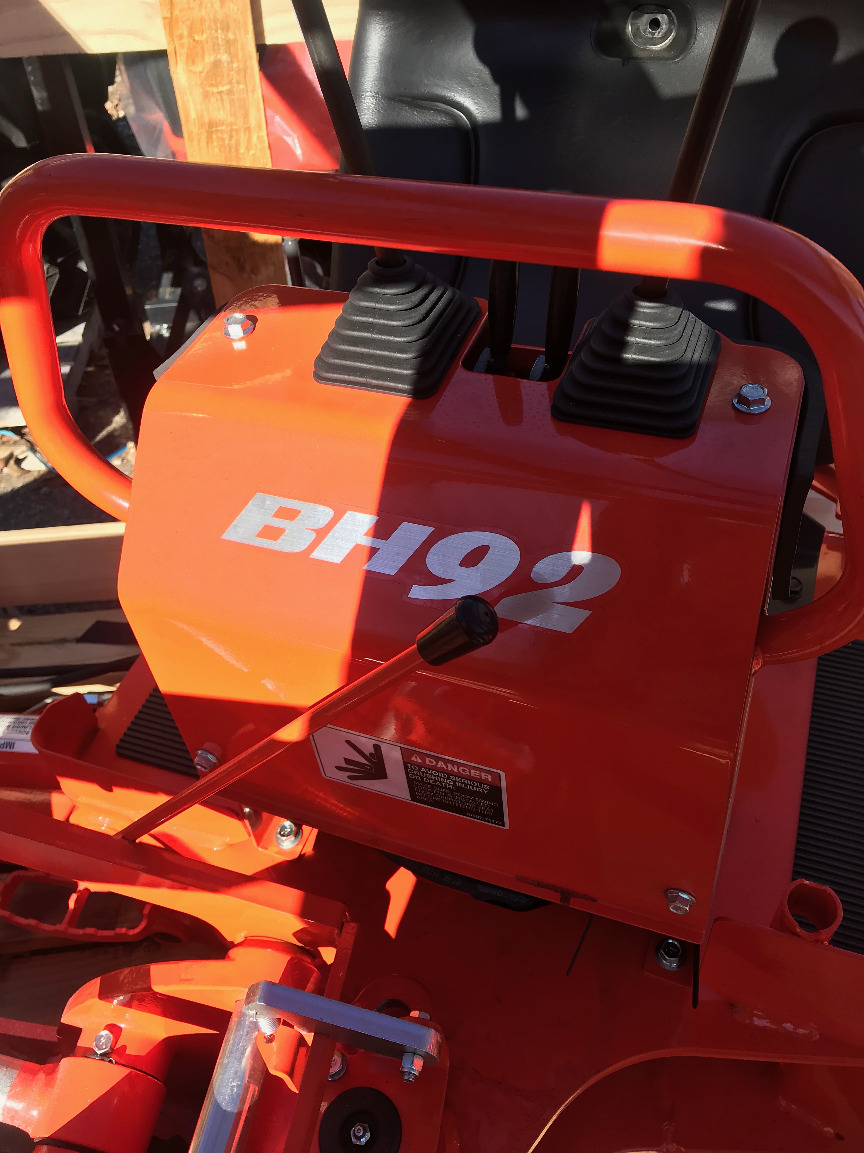

Well- talk about under promising and over delivering....my backhoe showed up today at the dealer.. I am taking my tractor in Monday to have it installed. :D
I'll send a progress report and pics after it's done. Thanks everyone for your advice! I will have an in depth conversation with service about it Monday just to clarify... Sam
/ BH92 Backhoe on my L4240
#19
Well- here it is in the crate- dropped off the tractor today so will have it back Tuesday or Wednesday....very excited!!!
