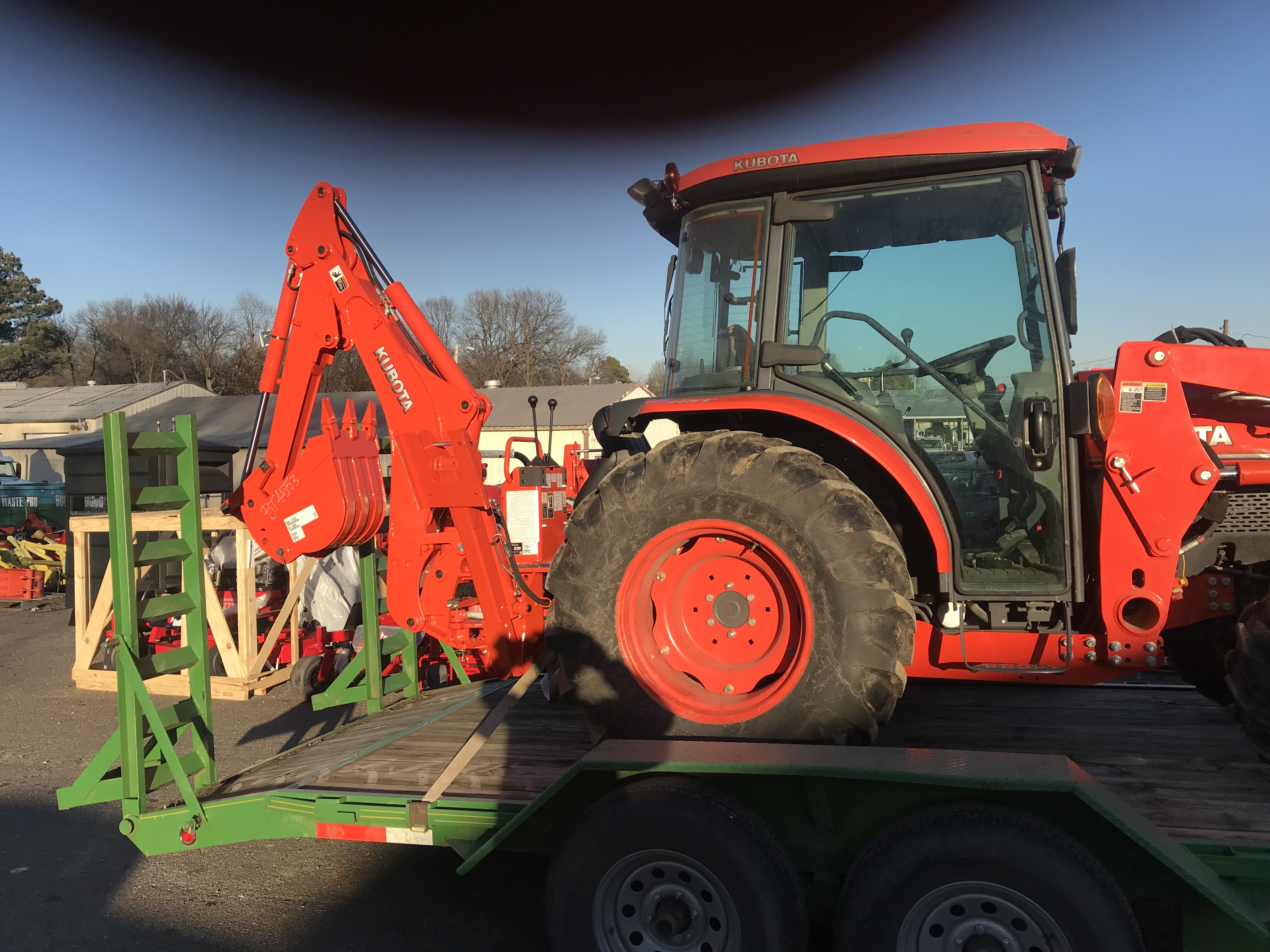

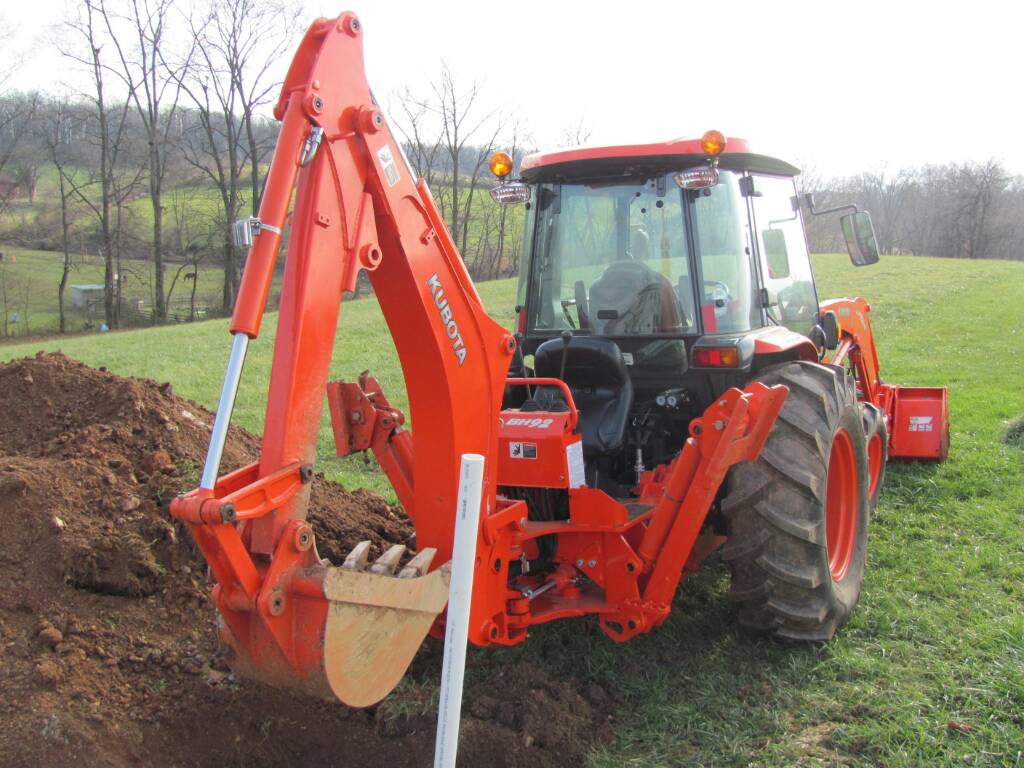

Will look like this, enjoy.
/ BH92 Backhoe on my L4240 #23
2011 i think, without looking. It is fairly new in this picture.

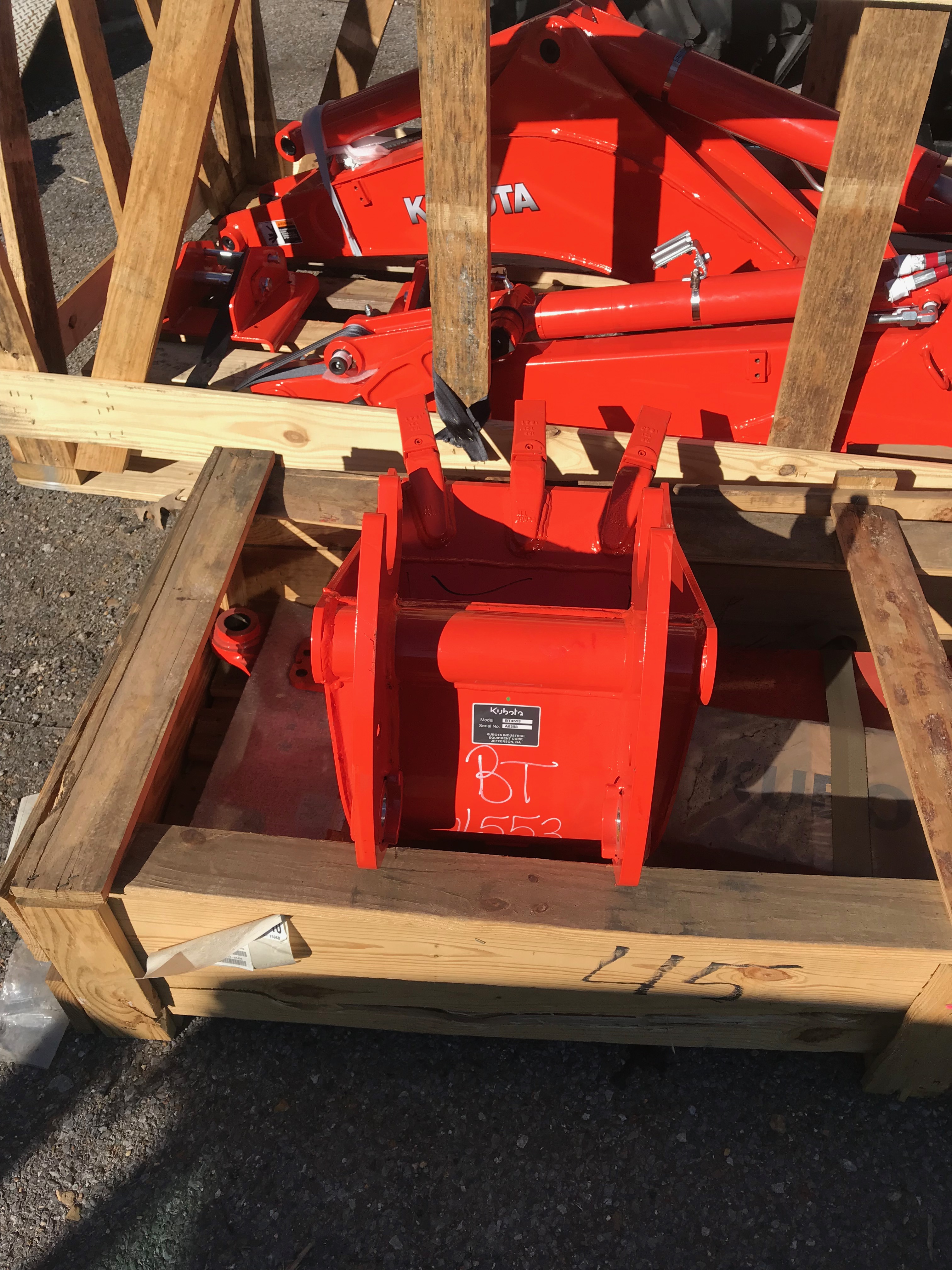

Bought it for my geothermal install, but use the BH a lot for stuff. I have 18" bucket, didnt want to spend money for 2, thought it would be a good size since my trenches were 36" wide. A narrower bucket would be good for some other trenching projects.
I've read don't use a rear remote while BH is on, can damage the BH loader valves. Edit, see that was already mentioned.
Only had it off once. Have the dealer show you the removal and reconnect. Its not hard, mine is a bear because one pin hole seems to not be aligned and one pin is a little hard getting out.
You will love it.

I use a BH92 on both my L6060 and MX5800. I have 3rd function valves installed on both tractors and they function normally with the hoe installed. Be aware that using rear remotes with the BH on can damage the BH control valve. Disconnect the BH hydraulics before using the rear remotes. You don't have to physically remove the hoe.
I find the BH92 to be a bit slow but it has enough strength to rip up sidewalk slabs that don't contain rebar. I routinely remove 2' diameter boulders from excavations. I once removed a 3" thick blactop driveway apron with no problem. You'll have to dig around a large stump first to remove it. I have a manual thumb on mine but I recommend the hydraulic option if you plan to use the hoe to remove large objects from excavations.
Select the proper bucket width for the type of soil you will be working with. Wider buckets move soft soil faster but they can bog down in hardpan or heavily rooted soil. I have both 12" and 18" buckets but I can get work done faster with the 12" in the tough ground around here. If you work in heavily rooted soil, you might consider a single tooth root ripper. If I had it to do over again, I would get the QA bucket option which lets you quickly change buckets.
