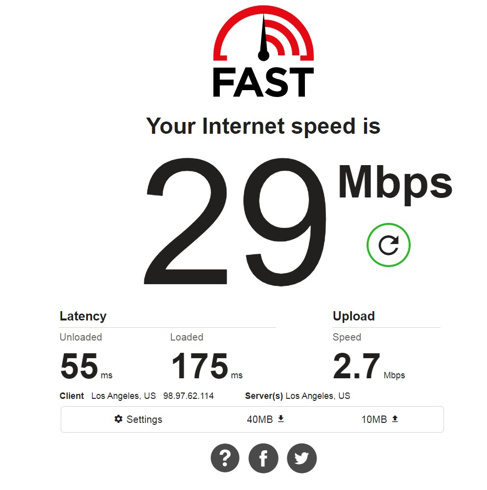

With the SL router running in bypass mode, the SL app on the iPhone reports 16 Mbps down and 6 Mbps up today.
Just ran a test, also in a waitlist restricted area. From a wired PC-- 29mbps down, just under 3mbps up.
Shortly after that, one iPhone reports 116mbps down. A 2nd iPhone reported 36mbps down. All within probably less than 2 minutes.
Just noticed on the Starlink app, at least on mine, it no longer breaks out phone to internet vs router to internet. So I'm not sure which of those the phone is measuring?
Fast.com (in your screenshot) has nothing to do with Starlink, so that's not going to give you any insight as to your LAN speeds. But in the Starlink app, if you open the Speed Test section, you can swipe up for the advance speed test section, which will allow you to see WAN and LAN speeds.
/ Starlink #2,632
We will have to disagree that it provides no insight.
Using my phone thru the Starlink app, I can view speeds without "contamination" from my LAN, my equipment, or any of its potential bottlenecks.
But from a PC using a speedtest site, operating on a LAN that doesn't change, I can monitor for such bottlenecks. Plus, it gives data on relative changes at differing times of the day-- such as better speeds when the Starlink network is lightly loaded vs slower speeds when it is loaded.
The barely-consumer-grade SL router also figures in. Put it in bypass mode to use a "normal" router with typical routing functions and capabilities-- then how do you speedtest using the app?
