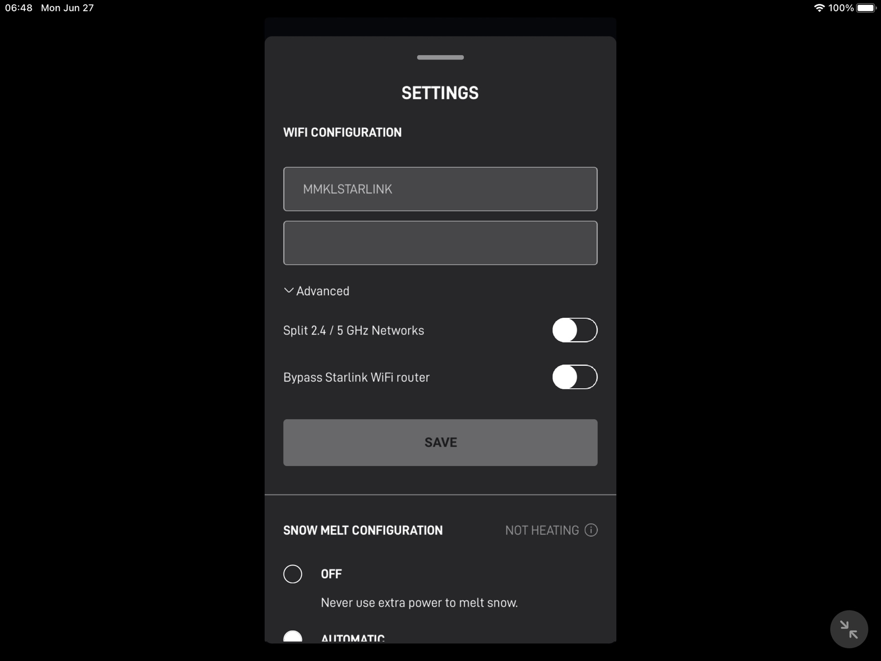

/ Starlink #2,607
How do you bypass SL? I see nothing in settings
Dennis
Click Advanced under WiFi Configuration

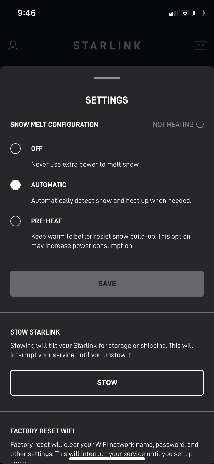

/ Starlink #2,615
It’s under settings advanced under your routers name.
/ Starlink #2,616
I don’t have that screen on my app

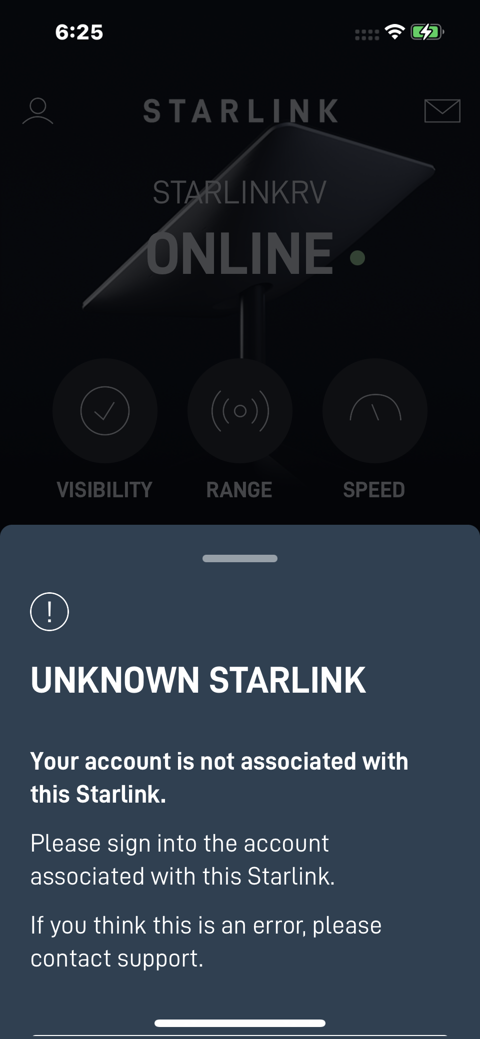

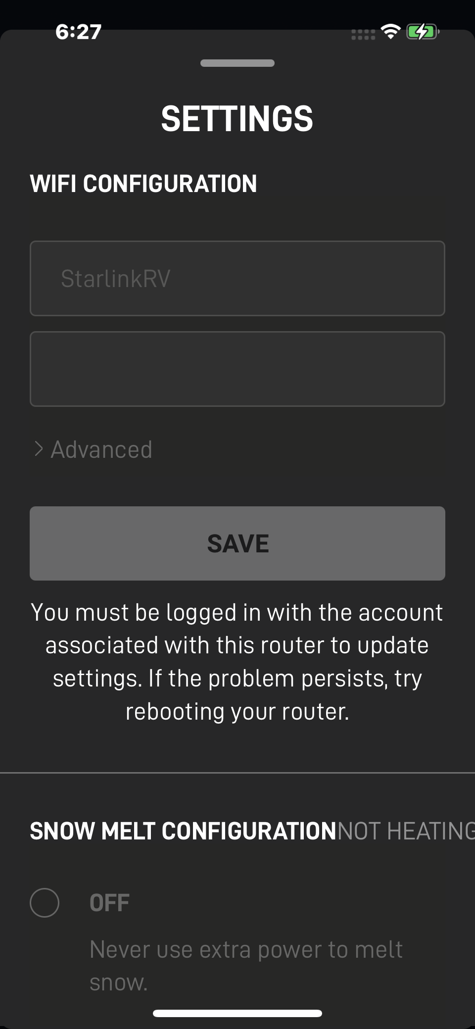

You may have encountered a bug in the SL implementation. I suspect it thinks you are not "logged in" to your account with an appropriate name and password. It's also now happening to me, but I don't know why.
Just now, I tried to put my SL into bypass. It has worked before and I've done it a few times. But it won't allow that now????? The choice on the app for bypass is dimmed. And it says I am not logged in. On the login page, the name is correct but dimmed. I do notice the password field is also dimmed, but occasionally flashes which is odd. On another page, I get a message saying "Unknown Starlink."
I went to 192.168.100.1 but that tells me to make changes using the app. No help there.
The app advises if problems persist, reboot the router. So I rebooted the router. No change.
I've been having recent problems with remote access. I set it all up, it works great and I can remote access cameras from an offsite location. For about a day. Then it inexplicably stops. I thought this might be a fixed IP collision problem; however, now I am also wondering if it is related to SL "losing" its login credentials? Really have no idea- just a guess. Or maybe a fixed IP collision is somehow related to the lost credentials. ????
I'm stuck. I guess next step is to plug/unplug 3 times? Kind of like Dorothy clicking her heels? :D
