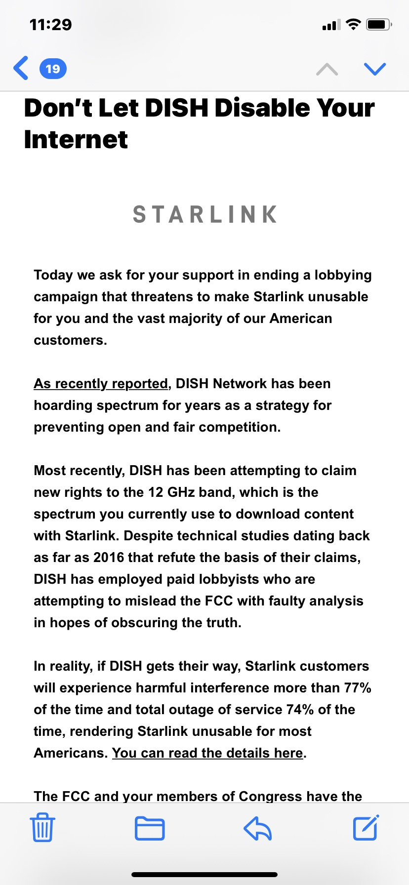

Starlink sent me an e-mail concerning Dish. Has anyone else got this?
/ Starlink #2,643
Yes, it is a long and ongoing squabble between Starlink and DISH. There are other 5G bands that don't conflict with Starlink, but the DISH frequencies will interfere according to Starlink.
If you view Starlink as being more important than potentially speeding up some data speeds on some phone plans/networks, write and support Starlink's position.

/ Starlink #2,644
All the best,
Peter
Thank you. I have no cell phone service in the area where my Starlink unit is so yes, I'll be sending a note to my representatives.
/ Starlink #2,645
While it is still worth responding to the Starlink message above, the FCC just ruled that mobile use of the 12GHz band was permitted for Starlink and Kepler, and against DISH's use of the relevant spectrum.
The ruling makes it more probable that the base use of Starlink will continue to be allowed as FCC argued that the approval was in the public interest.

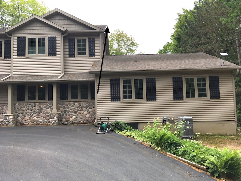

In March when there was a bunch of snow on the roof, a fellow installed dish in the location shown in the attached image. There is a large oak tree with some branches that hand out in the path of the dish. Since the tree has leafed out we have experienced some buffering with YouTube TV that we did not experience prior to the leafing out. At this point I don't want to cut down the oak and the plan is to relocate the dish to the gable area on the upper roof indicated by the arrow in the image. I think it will clear the branches and give a better field of view.
The fellow who did the original install used a Direct-TV mount that penetrated the roof, not what I anticipated. When I asked him about relocating the dish and mounting it with a Starlink short wall mount or some other kind of gable mount with a pole, he was reluctant. His point is that he knows how to do the DTV mount and it has confidence in that so.....
I would prefer an installation with no roof penetration, but I have to find someone to make the climb onto the roof and do the mechanical part. What are some options for mounting the dish on the roof gable in the image? Seems like the short wall mount might not allow the dish to clear the roofline given the direction the dish has to point.
I ordered the SL short wall mount to relocate the dish to a higher point and more to the left only to discover that the fascia boards are aluminum and that does not seem feasible for an install. So, I am back to a roof mount. The non penetrating roof mounts concern me since we have occasional high winds, the highest this year 60+ MPH. The Commdeck mount might work but it does not seem to offer more advantages that the SL Flashing roof penetrating mount, although I'm just making that comment without knowing all the details. I'll mount it probably near one of the roof peaks and run the cable down the front on the house and enter near where the hose reel currently sits. Looking into the attic space and probing around it does not seem there is a feasible way to get the cable into the second story attic space and then down an inside wall to the computer closet, approximately where the interior light is visible between the two font pillars in the above image.
I have been stumped by the SL search for obstructions app. I follow the sparse directions and "scan the sky" and the app never reads more than about 91% when I hold it for what seems like many minutes. Anyway, I'm locating the dish where I think I get the best unobstructed view of the North sky.
Seem reasonable?
Edit: Is it possible in this situation to only use the SL Pivot Mount rather than the Flashing plate plus the pivot mount?
