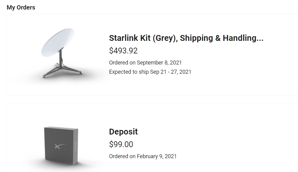

Received the email today saying to confirm my order. I did that so it looks like I may get Starlink after all. Lol Now if I can make it work around my trees. :D
I do have a question for the folks that have received their kit. How long is the cable that comes in the kit? Trying to decide if I need to order the longer one.
