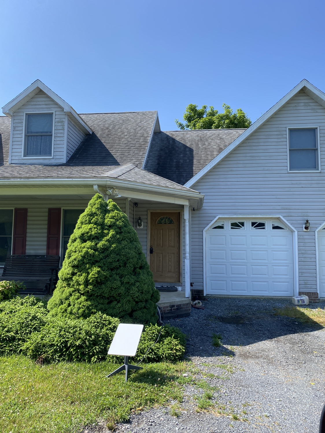

Where to put it.

I think I might use a J arm that mounts to soffit rather than penetrate the roof. As to where. That would be a combination of clearest view with ease of running the cable. Might need to order longer cable. While you might be able to narrow choices, likely you will have to get on the roof and evaluate with the obstruction app. Note that you should attempt to use the phone apt as close to actual dish location as possible. Some have stood at a spot to evaluate, then placed dish at ground level only to learn that dishy picked up obstructions not seen 3 feet higher. Lots of installs documented on reddit. Some show temp locations for extended duration. SL offers a number of mount options on their site, but I knew I had an old dish J mount sitting in shed. That worked perfectly. Do be careful up there.

I got this wineguard mount. Ordered the pipe bracket, which should clamp on this. Waiting on it.
I already bought the longer cable.
Would like to put it on garage facia just above porch roof, but might have interference there. At very top of roof is best choice.

With all those peaks Dennis, you have opportunity for fun. I only had to chose which end of a single peak. I choose the nearer.

Remember to mount it where you can get to it relatively easily unless you are absolutely positive it won't ever need servicing.
I still remember the picture of David in a tree retrieving an article of value (a drone IIRC).

With such a beautiful house Dennis, I opt for hiding it off the back? So you don't see it when walking up.

Just make sure to use the obstruction checker tool in the app before you commit to a mounting location. Run it with your phone in the exact physical position you are thinking of mounting the dish. You don't want to find out after the fact that some tree or other object is a blocker that causes your signal to drop occasionally.

And do it when the leaves are on the trees. I went from an outage about every 4-5 minutes with no leaves and to an outage every 40-50 seconds once the leaves were on the trees.
