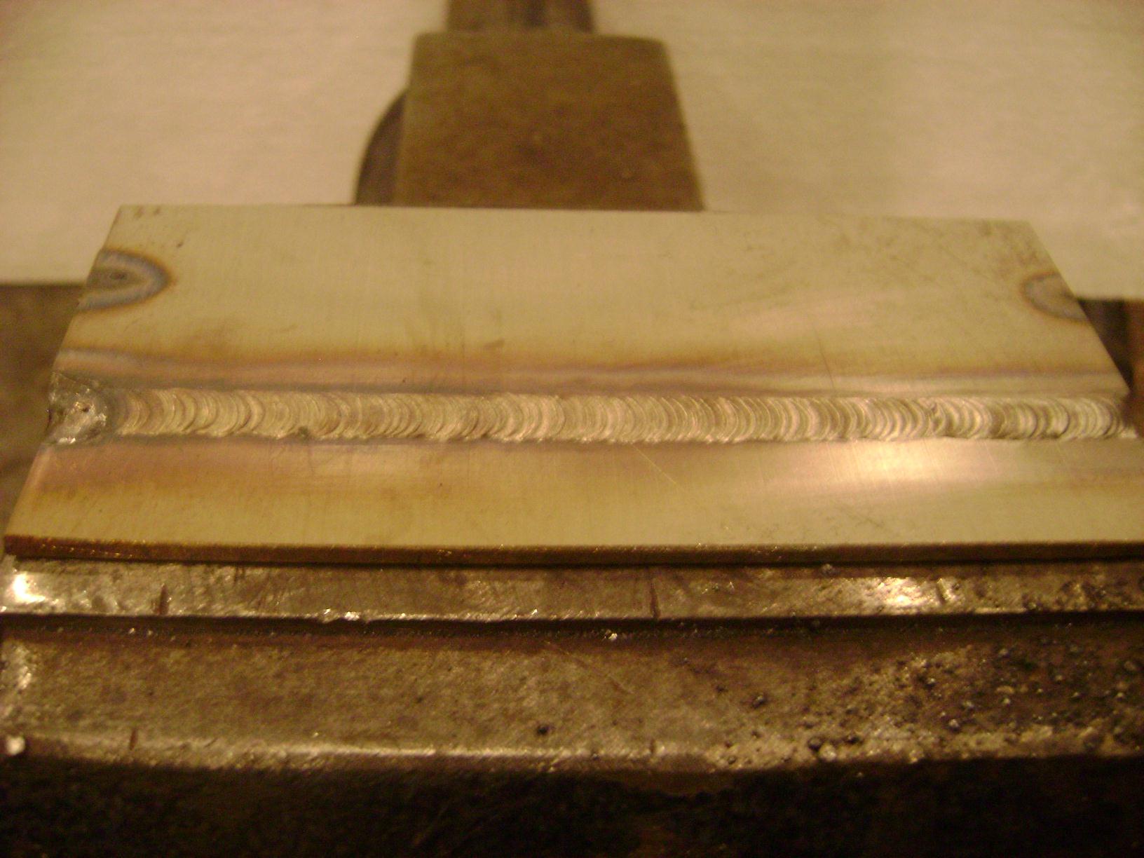

/ Stainless welding options #26

Sodo was making something he didn't care a lot about for a rental. This is the opposite end of the spectrum...
Dragoneggs- gotcha beat on this one - I'm a materials engineer with a mechanical bent... :D There is no need for 316, and while i'm sure I can find it in filler reasonably, getting it for railing parts will be painful and expensive (I guess expensive is painful, too :D) If I find I need to passivate it down the road, I can go back and do that I suppose, but i doubt it will be necessary for this. We are not coastal in Wisc...
I will be using my XMT as the power source for this. I will get a foot pedal for sure, and of course a torch plus argon bottle/flowmeter. I am also going to look for a hi Freq box for it like a Miller 251D. I suspect that will make life a lot easier for not a lot of extra dough, though I have lift-arc capability built into the box already. I will dedicate abrasives to this so i don't get any cross contamination. Odds are that I will not need to do anything other than this project at that time, so odds of messing with plain steel at the same time are low.

Why are you going to put a hi freq box on there. Does your xmt have ac.
Also on lift arc you have a good chance of breaking the tip off of your tungsten. Practice your scratch starts. Tungsten inclusion isn't a big deal on this but once you shatter it, it tends to booger up faster.
One other thing. Have your tig rig equipped with a gas lense. It gives you better gas distribution. I will post a picture of one later.

I am thinking about hi freq to use it for starts on steel/SS instead of lift or scratch and to allow Alum welding if I decide to go that way. It seems like ~$400 for a used Miller 251D would save me a lot of time and aggravation in the long run. My limited TIG experience is all of a part of an evening class at the end of the semester (we had extra time, so the teacher showed more stuff to those of us who actually stuck around). That was a Lincoln unit with hi freq start.
I was planning to get a gas lens setup with a torch. I'm not real worried about the money as this still isn't too bad to do, but I'd rather spend a little extra here and make my life easier in the long run. I have way too much going on with the house build to try and do more things the hard way..

I am thinking about hi freq to use it for starts on steel/SS instead of lift or scratch and to allow Alum welding if I decide to go that way. It seems like ~$400 for a used Miller 251D would save me a lot of time and aggravation in the long run. My limited TIG experience is all of a part of an evening class at the end of the semester (we had extra time, so the teacher showed more stuff to those of us who actually stuck around). That was a Lincoln unit with hi freq start. I was planning to get a gas lens setup with a torch. I'm not real worried about the money as this still isn't too bad to do, but I'd rather spend a little extra here and make my life easier in the long run. I have way too much going on with the house build to try and do more things the hard way..
The high freq will be nice for your XMT but it won't be much help for aluminum as your power source is DC only.

The hi freq supplies the AC for Alum when set to continuous vs just starts. At least that is my understanding. Perhaps i am clueless here... wouldn't be the first time...

Unfortunately, that is not true. When you put it on continuous, it keeps the hi-freq on in case you are welding something like expanded metal so it will restart instantly instead of there being a slight delay. The hi-freq is a higher voltage and frequency DC superimposed on the existing DC (20 or so volts) welding voltage.
It is possible to TIG weld aluminum with DC if it is not cast and fairly pure (I did it once), but the results are not strong or pretty as there is no cleaning action and therefore all of the oxides, silica, etc. are inclusions in the weld instead of puddling on the top or being burned off.
That is really the only shortcoming to the Miller XMT welders, they are designed for steel. Mine have been flawless for up to 16 years of use, but I am looking around for a inverter TIG unit for use with aluminum. I will probably end up getting one a Everlast PowerTIG 210+ amp or a Miller Dynasty 200. I want a unit that I can vary the pulse frequency and amplitude, etc, and those units give you excellent control over the arc...

Put the $450+ you were planning on spending on the hi freq box towards an AC -DC inverter tig instead.
