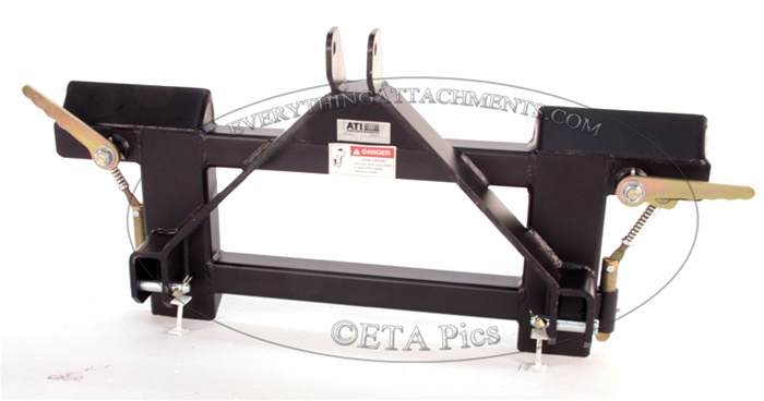

/ SSQA plate to three point adapter?
Darn it 😂 oh well 4 yrs ago I swear I couldn't find one. Thanks though. I'm pretty sure that's lighter, easier to attach, and use than my over built contraption, the prices on some would make it cost prohibitive in my case. I think I could buy a 7' box blade for the price of some of those adapters anyway.

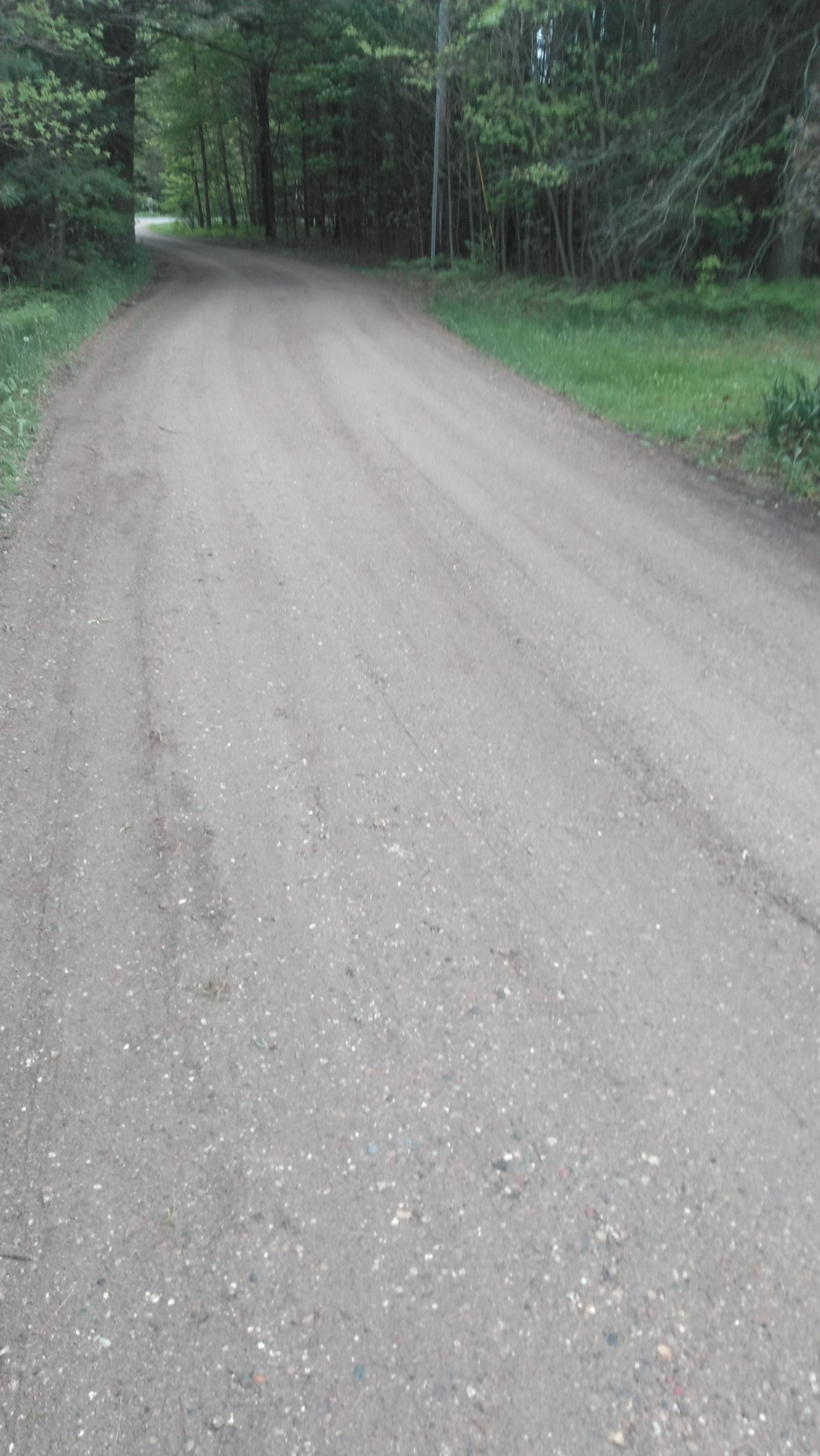

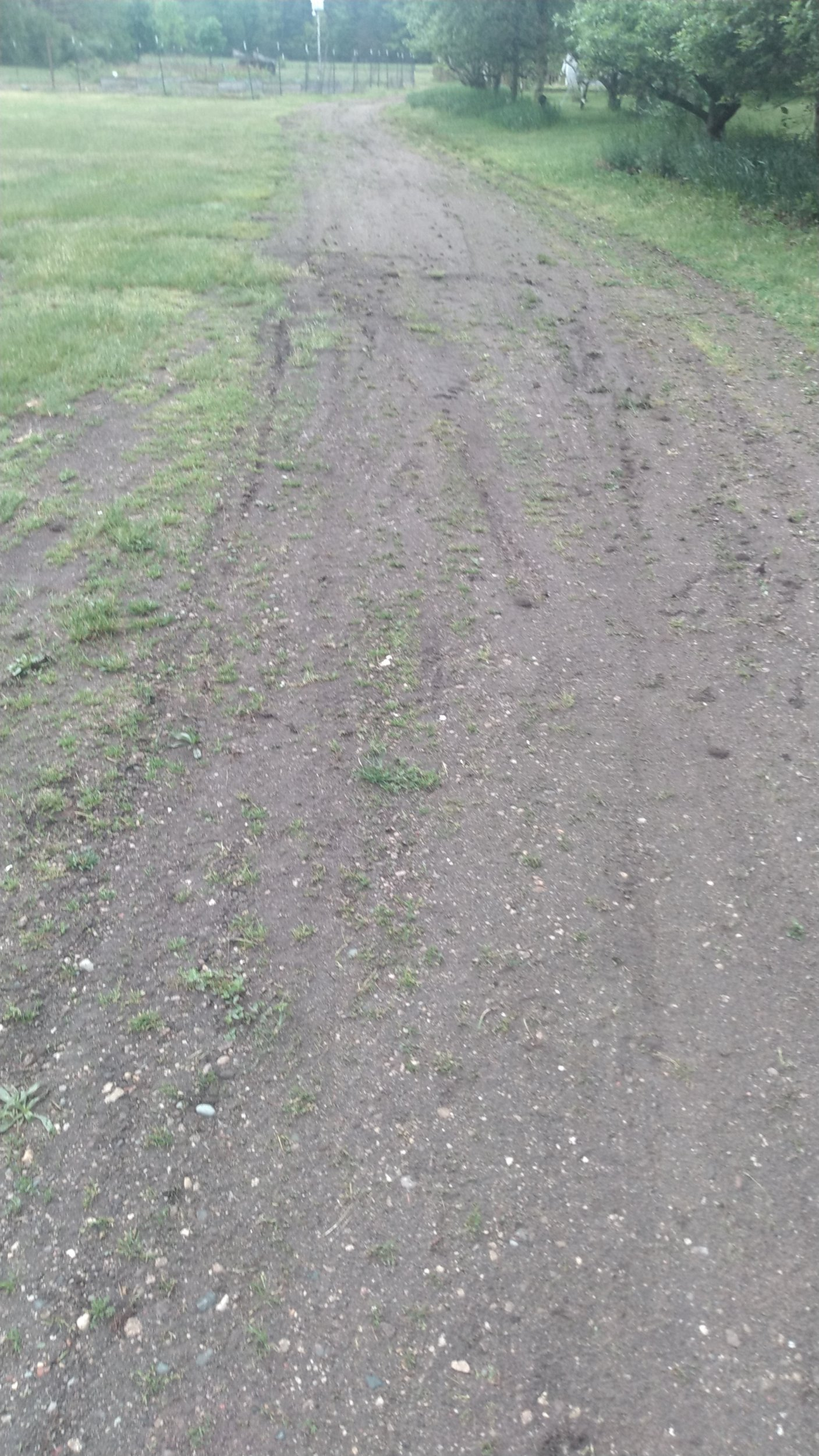

It does do a pretty nice job though. Before and after.

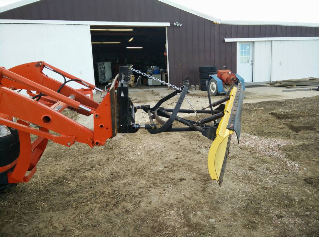

I've built a couple SSQA to 3pt adapters, going the other way. SSQA plate then just weld a cheap Harbor Freight (or usually garage sale) 3pt Quick Hitch on. Parts arecaround $50 each at garage sales if you are patient. Double or triple that new. You can buy them pre-made for $400ish. But if I recall the QH ones are superior to hitch up, at least if you don't have top hook clearance issues.
My first one was the mounting point for a snow plow. Sold with the old tractor & plow. I built the new one just for moving & loading other impliments.
Thought about one to put a bucket or forks on the 3pt, but never gotten around to it. Couple hundred for the male SSQA mechanism, which is to expensive for me (or to much effort to fab up myself).

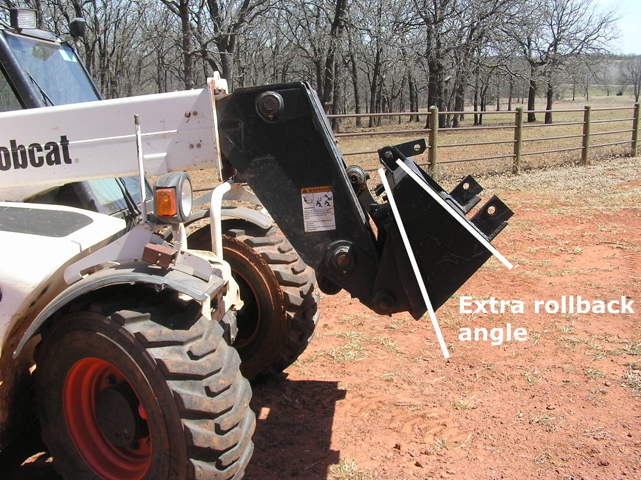

Good idea and I recommend building in some extra rollback like the adapter has that I bought from Washburn Company:
/ SSQA plate to three point adapter? #8
I don't disagree in principle. Not much roll back in my units. But it will tilt the unit past 90 degrees down.
Any extra angle pushes the impliment further out & decreases capacity a bit. Pointing the unit down & hanging my heavy flail vertically means I can lift it. But it pointing straight out is to much for my loader to lift. More curl past vertical would be handy than all the dump range I have.
If you ever work under the loader, make sure there are mechanical locks or supports. If I ever work on my flail while it's dangling I prop up the loader with some 2x4s that will take the weight. Hydraulics aren't reliable for safety & need backups if you will be under there.
/ SSQA plate to three point adapter? #9
I'll agree with adding the roll back angle,
I didn't and could have used it sometimes;

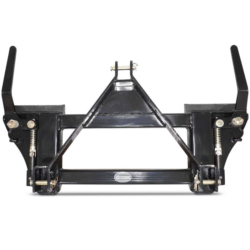

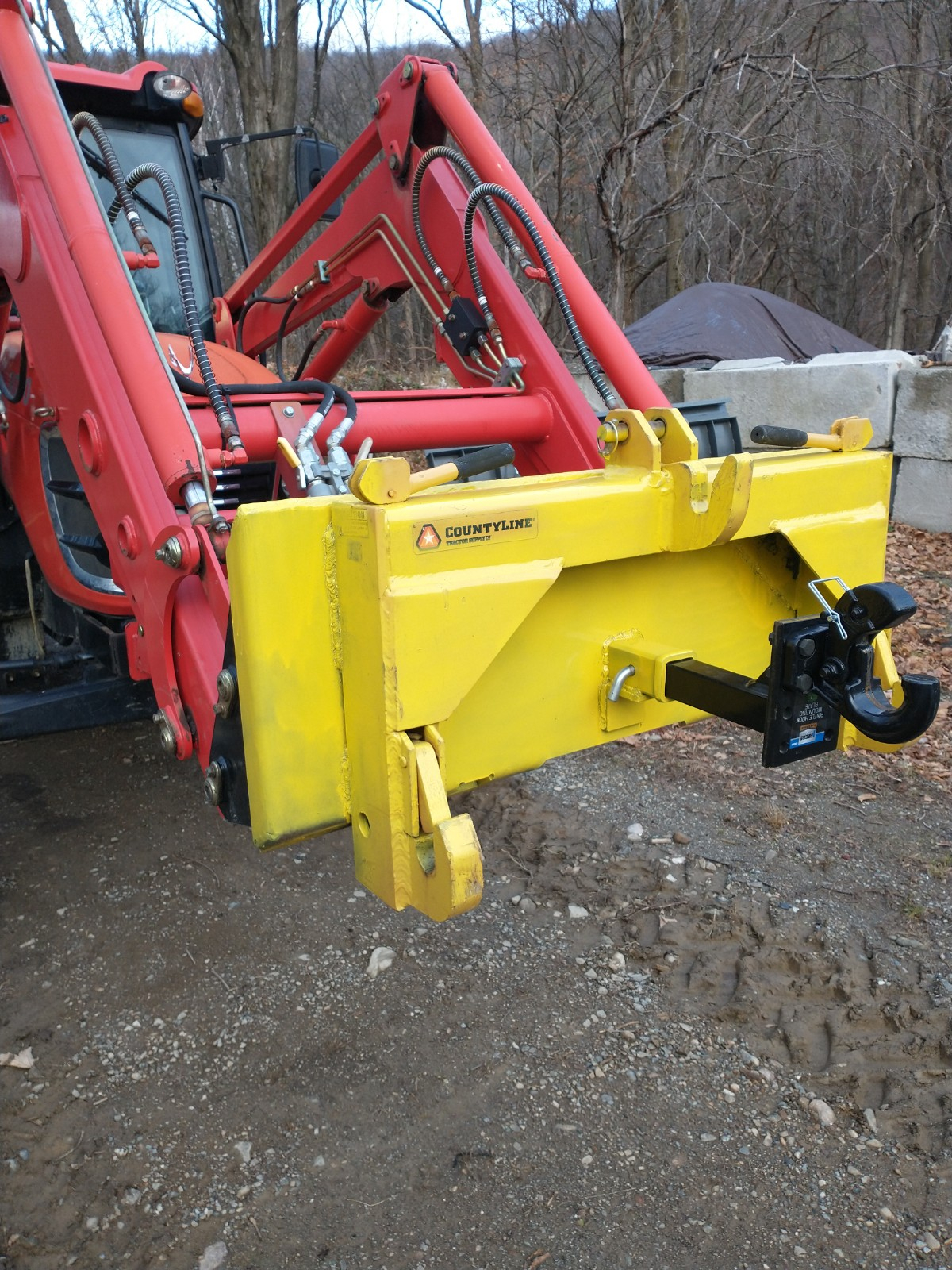

I tried doing the same thing a while back using parts I had laying around. By the time I figured out what else I needed to buy for the project, I spent a few $$ more and bought this one from Titan:
While projects like this are fun, I find I just don't have the time anymore.

Sorry, I posted the wrong link. This is the 3pt to ssqa adapter:
