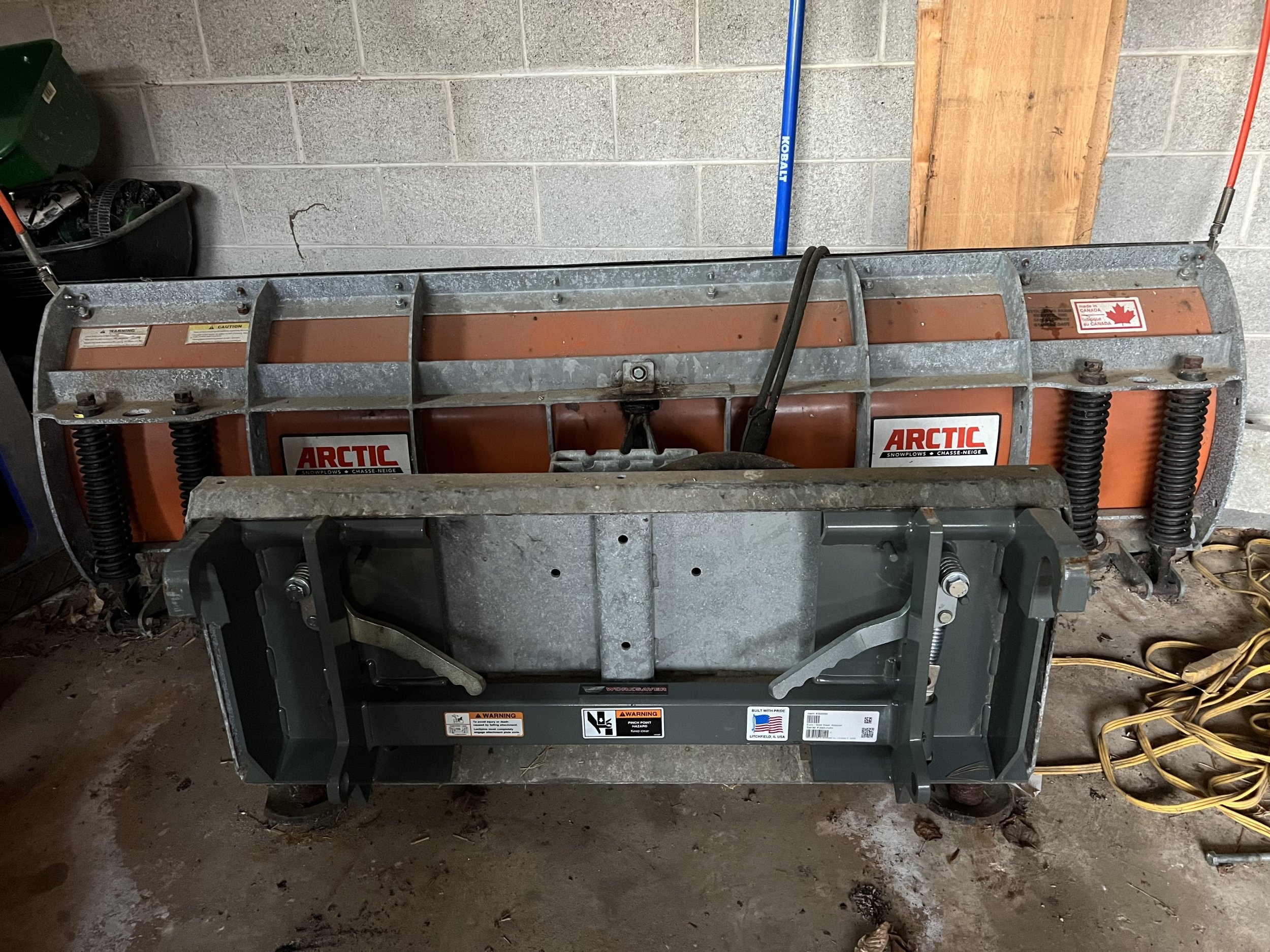

I'd like to figure out an adapter to go from my PT1445 to SSQA. The PT attachment plate is $400 plus shipping. It's 1/2" plate with two notches bent into a lip at the bottom with a welded retaining lip at the top of the plate which measures 12 1/8 tall x 23 wide compared to the SSQA dimensions of 16 tall x 48 wide. The TBN members who've fabricated adapters seem to be of the opinion that the PT plate has to be tilted at an angle to work with SSQA attachments.
Power Trac's attachment plate seems to be unique in that the latching arms are hydraulically actuated from the operator's station where most every SSQA latch I've seen has been manual.
Part of me thinks I should just fabricate another PT plate and weld it directly onto the bucket or grapple instead of fiddling with an SSQA latch plate?

If you look at my picture of the adapter (like the one on sale) I bought years ago, you will see the angle of the PT plate to the SSQA. I think it was 30 deg, but you must check it. I got it from a PT bucket, on level ground, and the angle they had for the quick attach.
The good part about once you make the adapter is that you will be able to purchase readily available-mass marketed attachments AND on the used market for even less. Then if you are done or don't need/like,, there is more of a market to resell. That is also depending on how many other PT owners are near you with the same machine to buy factory attachments if you need to sell. The PT attachment will fit better and are correctly proportioned to the machine. I mix and match all kinds of stuff that isn't available through PT.
