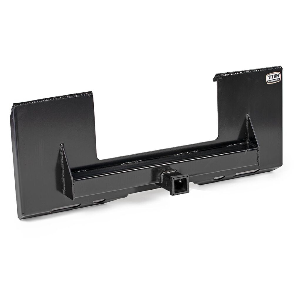

I am thinking of getting a SSQA receiver mount (2”) for my 40HP LS 4WD tractor to move trailers around the property. All trailers will be moved empty. The two larger trailers are a 16’ stock trailer and a 14’ 14k dump trailer. My FEL is already SSQA capable - I have several attachments already.
Looking at something like this: Titan Receiver Mount V2
In my mind this would make it easier to back them into final position.
Would this cause too much lateral load on the FEL?
The tractor with FEL and 6” box blade weights about 6,000lbs, the dump trailer weights about 4,000 empty
Is there a reason I should not do this? Or is there something better to use?

At one time I thought it would be cool to use the front end loader to move trailers. I abandoned that idea when my brother in law noted that a person sure can see the trailer ball and hitch easily, where it would be much more difficult to see with the FEL.

The only 'problem' you face is seeing the hookup. The SSQA plate usually blocks your view of the connection. If you use a high offset receiver insert, (so you can see the connection), its a problem to duck the ball low enough to insert it into the trailer tongue. That's why I use the JD QA system. I can see thru my fork frame (which has a hitch insert) just by looking a bit off to the side of the hood.
A few of the skid steer operators I know have installed backup cameras on the loader in order to see the ball connection for moving trailers. But, whatever you go with, your neck will send you Thank-You cards.
   / SSQA and Trailer Hitch on a Tractor #12
Titan makes this SSQA adapter plate with a cutout which allows a good view of the ball & tongue on many tractors:
I can usually line up the ball & tongue by standing and angling back the adapter plate. Can be an issue with a cabbed tractor though.

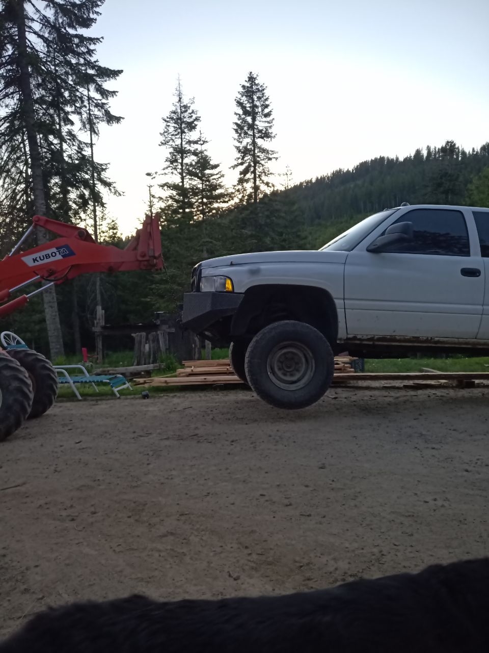

That depends on the machine. They're not all created equal. On mine, the cross bar is a 2"x3"x3/8 wall tube. I use it to change tires on my pickup. Wrap a chain around it and lift the entire front end of the truck off the ground. Lifting somewhere north of 4000 lbs.
   / SSQA and Trailer Hitch on a Tractor #19
That depends on the machine. They're not all created equal. On mine, the cross bar is a 2"x3"x3/8 wall tube. I use it to change tires on my pickup. Wrap a chain around it and lift the entire front end of the truck off the ground. Lifting somewhere north of 4000 lbs.View attachment 842150
I’ve lifted stuff from my skid steer coupler as well but the majority of tractors only have a fairly light duty tube.
