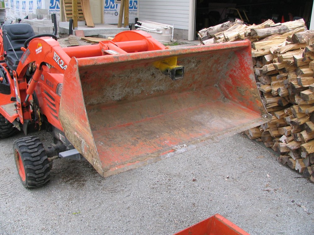

I added a receiver hitch to my FEL, Man is it handy. I stole....err borrowed the idea from some one on TBN, just don't remember what tread I saw it on. So thanks to who ever it was:D
Hey .... That looks familiar! If it was mine, your welcome, if it wasn't, it was a blatant ripoff of mine ;)
One thing I did find with mine (although you are using a pintle hitch), I use the 1 7/8 ball to move my 2" hitch trailer and it works great. If I ever bought another tractor, this would be one of the first projects I would do on it .... Like you said, it is VERY handy if you move trailers around a lot.

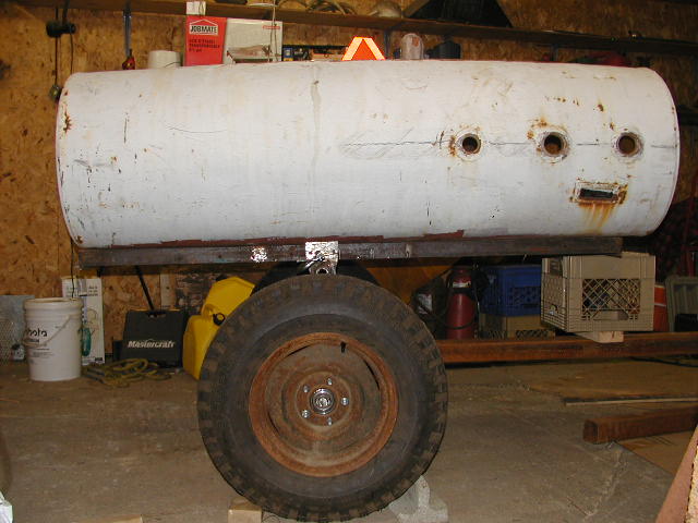

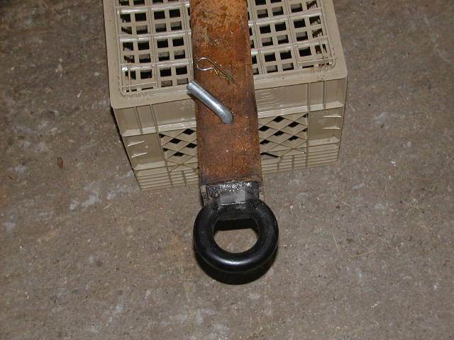

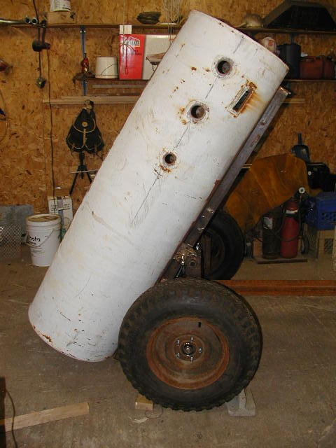

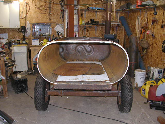

so do you have some sort of plug to fit in the hitch block, to prevent it getting filled up with ie. gravel, when using the bucket . I have been tinkering with this idea myself ,already have the trailor pretty well finished with the pintel ring,I assume it is called, just figuring out which end to hall/push the trailor from. The front looks good as I can then look forward as I direct my load to dump.
I used a 200 gallon oil tank for the container,low maintenance and easy to get a abandoned one with the cost of oil.Had to add some height to it so I could get a good dumping angle as axle is just behind center mark.

I did take a 4"x4" 1/8" plate and welded it on a short piece of 2" square stock to "block" the receiver to keep the crud out, but I have only used it once. I leave the ball in it all the time. I have loaded literally tons of crushed limestone, dirt and other materials with the ball in with no problems. If you are going the pintle route, I would definitely lean towards a blank plate because of all the moving parts on your hitch.
There are more pics of my setup if you click on my avatar and look at my past posts but in a nutshell, I mounted mine on the top part of the bucket because I remove and install the tooth bar fairly often and if it were on the bottom, it would get in the way. I have also found that it is much easier to see things with it up high.

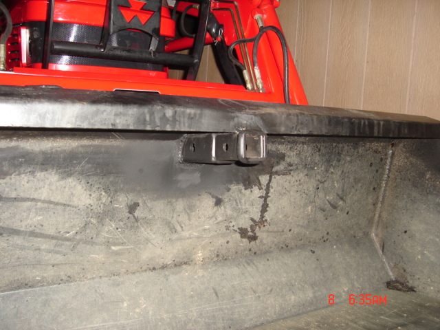

Well, bx24, another copy! Mine's black on a red tractor, but the idea was too good to pass up.
I used an 1-1/4" receiver as all my moving around is pretty light duty, and had to contstruct a rather intricate pattern for the reinforcing web due to the "extra" angle & turn-down on the GC2310's FEL bucket.
It worked out very well, except that I have neither the experience nor the equipment to weld so I had to pay someone else to do it. :( (One of these days....)
The nice thing about the smaller receiver is that it doesn't intrude into the bucket space much at all. I used a U-Haul 2" to 1-1/4" adapter, cut down on the rear to mate to the angle at the back of the bucket, with the aforementioned web for additional support. Receiver is pretty much level with bucket floor.
