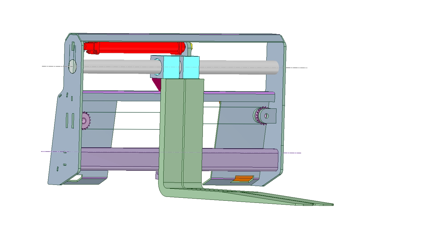

Do you think it would have been better to use a flat bar at the top like a real forklift instead of the round bar?
/ SSQA fork build
#68
I looked at a forklift with adjustable forks, and they had a substructure that was guided by 'V' strips that I guess were some sort of bearing material, maybe bronze. The upper flat bar is there but the fork doesn't rest on it until a load is applied. I did see a huge forklift on a construction site that was using the round bar and an Acme screw system for adjustment. I'm just trying to keep it as simple as possible. I figure if the hydraulic adjust is a total flop, disconnect the cylinder and do it by hand and chalk it up as a loss. In the mean time, I'm having a blast building this thing.

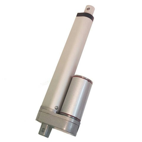

You can also use electric 12v actuators instead of hydraulic. They are cheaper but still strong and you could have 2 of them with a 2 way switch for easy use.

I already have for a power SSQA. http://www.tractorbynet.com/forums/customization/321704-linear-actuator-power-ssqa.html
V1 uses those cheap $60 ones rated to about 200lbs. V2 used a $150 one rated to 500lbs or so. If I ever do a V3 for another tractor I would use the cheap ones again.
I've also used those cheap ones for some chicken coop doors.
I wouldn't use the cheap ones for the forks. To slow & wimpy. The 500lbs ones might work though. You could even side shift as you ran the 2 switches in the right direction.
