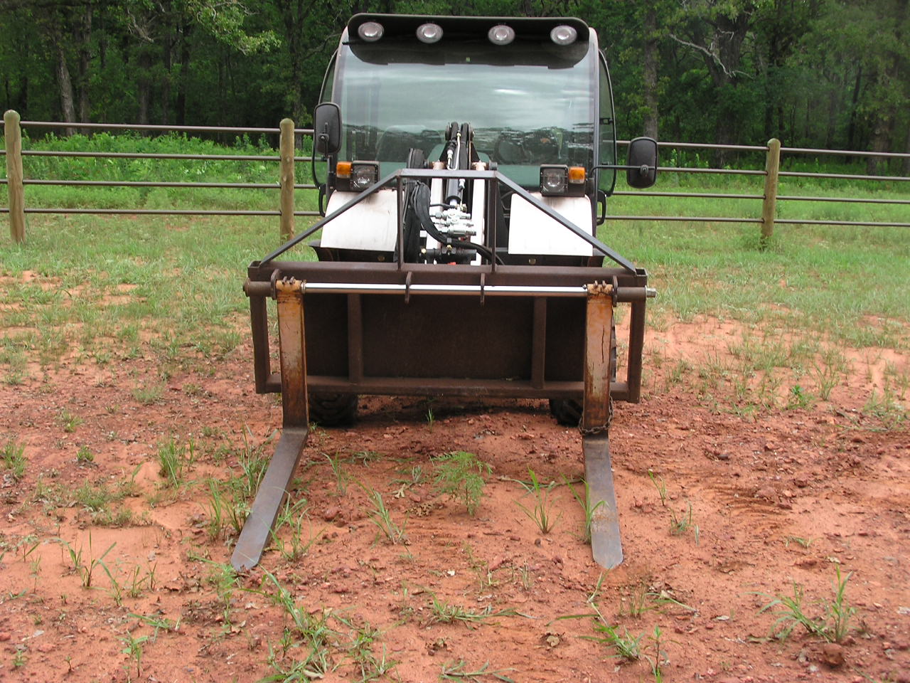

Very nice work! One question - why did you want the fit on the chromed bar to the retainer blocks to be so tight? Looser here would seem to make sense as it would be easier to slide. I realize you could get into binding issues, but there are ways to fix that. Just thinking that these are forks that may live outside, and get rusty or otherwise crudded up. Tight clearances could be trouble in the long run. But then I've never seen a chromed bar on a a set of forks...
Now you have seen another one. :D
Mine is a rod from a hydraulic cylinder.
Surprised you did not cut that chromed rod with an abrasive disc rather than a BS. That is pretty much what abrasive discs were made for. Hard stuff. And it doesn't look like you should care what the ends look like in this situation as they are covered.
Just going off the machinist book for sliding fit. I can always make it bigger if need be. The original plan was to store these outside but I think I've come up with a way to store them underneath my grapple inside the storage container.
An abrasive wheel would have been faster to cut the bar but I just simply hate using those things. Don't like the dust, sparks, and heat. Mostly hate the dust!

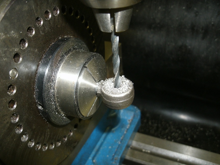

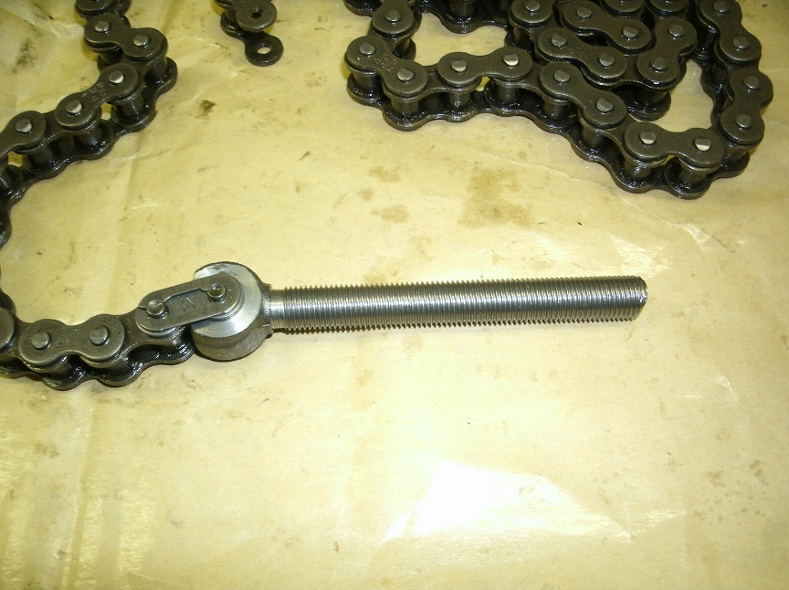

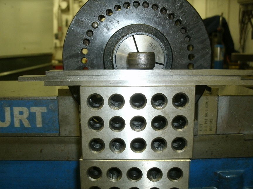

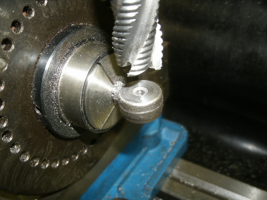

Finishing up the chain anchors here. I'm using the spin fixture on the mill to save time. I first start by eyeballing the anchor end parallel to the table and then get the hole drilled. I next spot face the side with an end mill and then spin it 180 to face the other side. Next comes milling off the end for chain clearance and then touch up the edges on the disc sander.
Next up will be the sprocket shafts.

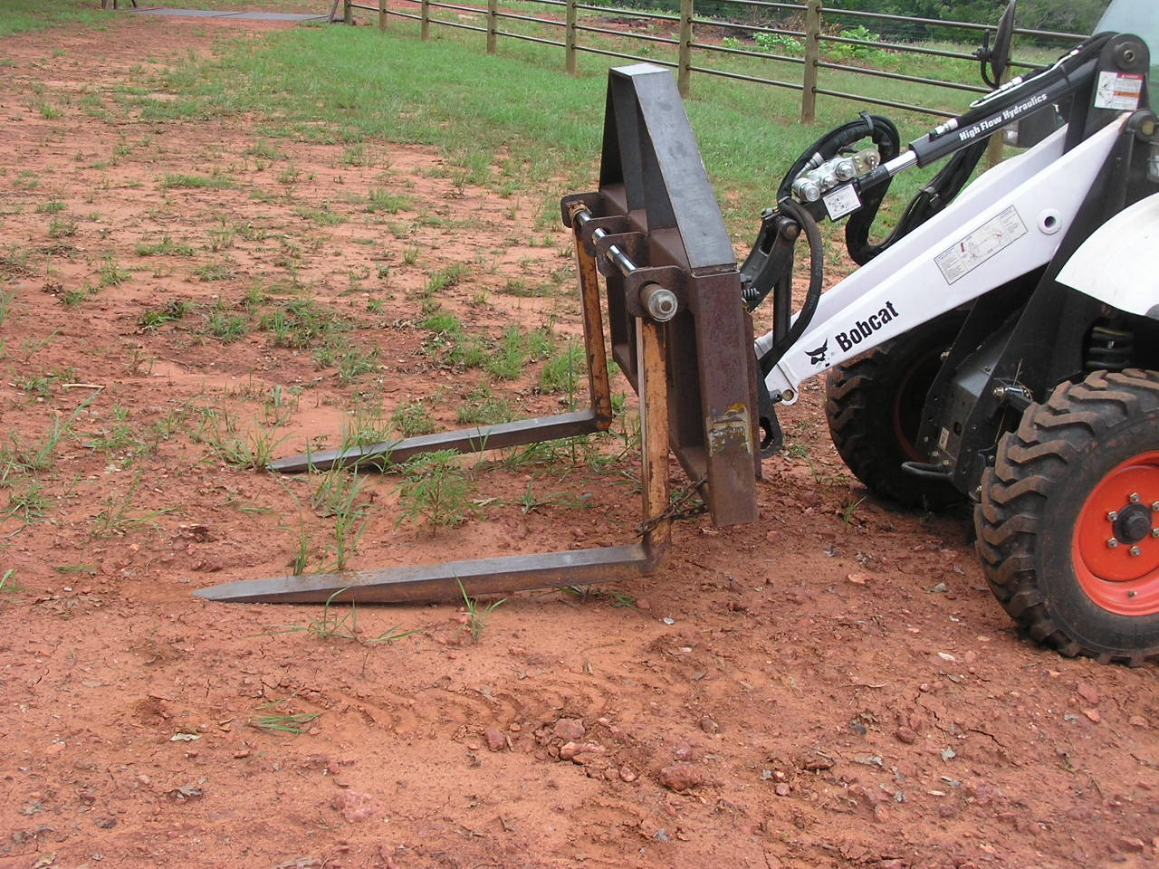

Working on the sprocket shafts here. I got a piece of 4140 TGP (turned, ground, polished) for the material and started by drilling the grease passage and then tapping the end for the grease zerk. Set up on the mill to cut a flat for the lock bolt to hold the shaft in place plus keep it from rotating. Then drill the outlet passage and ball mill a slot to disperse the grease. Here is the finished parts. Anybody spot my mistake?

Starting the chain assembly here. Sprockets and shafts all fit up nicely, but I found one issue. I allowed for an 1/8" thrust washer on the sides assuming this would provide enough clearance for the chain. Shame on me for assuming because the chain rubs the outer support. If I shim it further in, I will be pulling on an angle and that's not good! Going to have to do some head scratching here.
Yep, the flat for the lock bolt should be 45 degrees around from where it is, on the one that is inline, so the grease slot is not on the tension side of the sprocket.
I also think I can see a finger print on one. :eek: ----- :D
Is this where it is rubbing?
/ SSQA fork build
#120
Yup, you got it. I assembled everything this afternoon and put both thrust washers on one side to provide clearance for the chain. Cycled it with air and thought I had dodged the bullet. There was enough forgiveness in everything that it worked just fine....except that I discovered that the left sprocket was a 1/4" too high. That traces back to a mistake that I made on CAD. So spent the afternoon cutting off the mounts and welding new ones back on. Will post pictures tomorrow.
