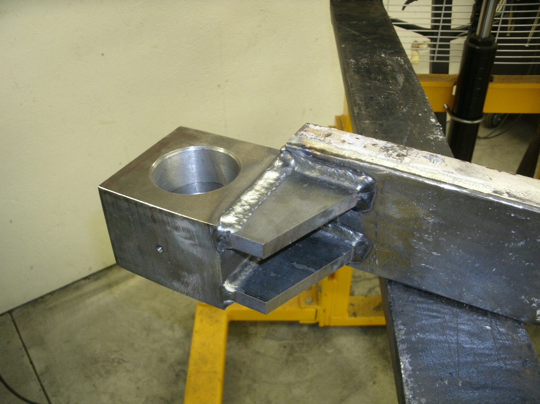

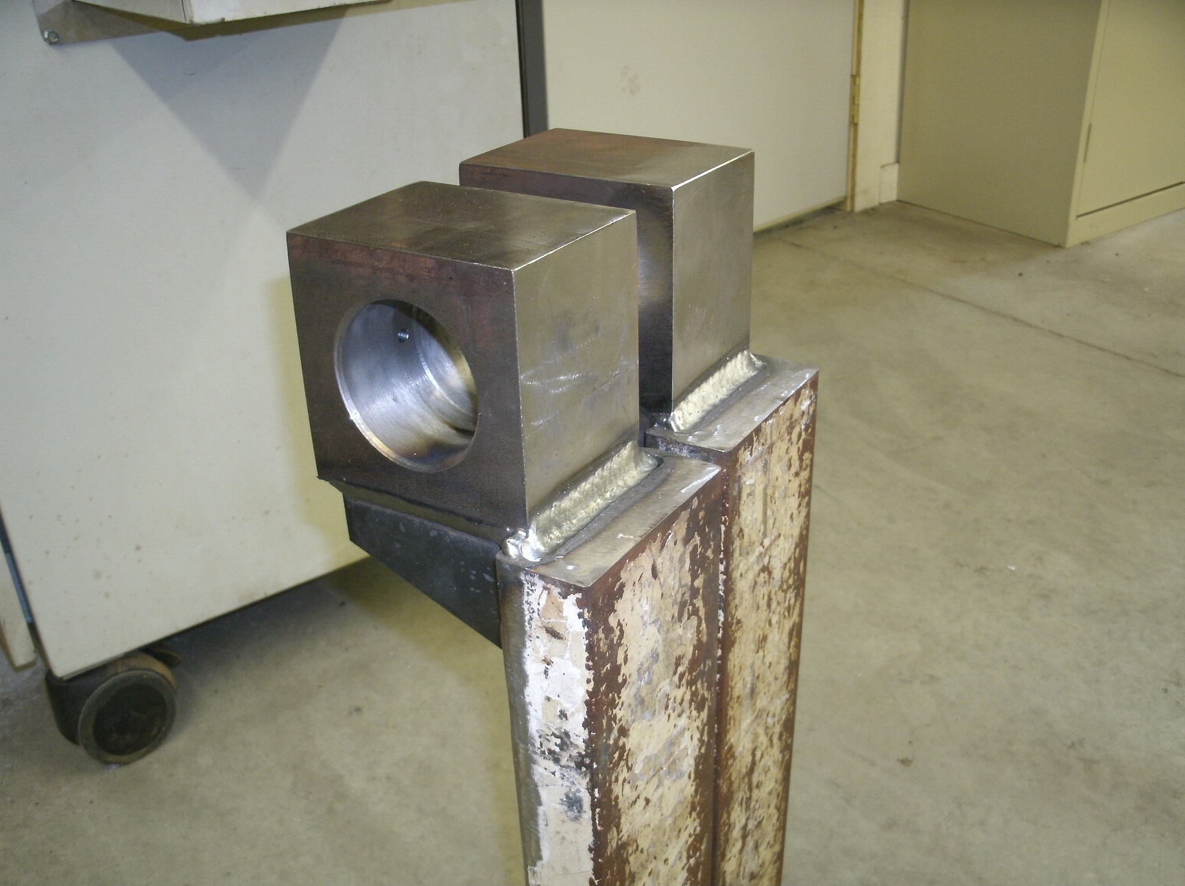

More progress. Welded the blocks to the forks and next up will be the vertical mill.

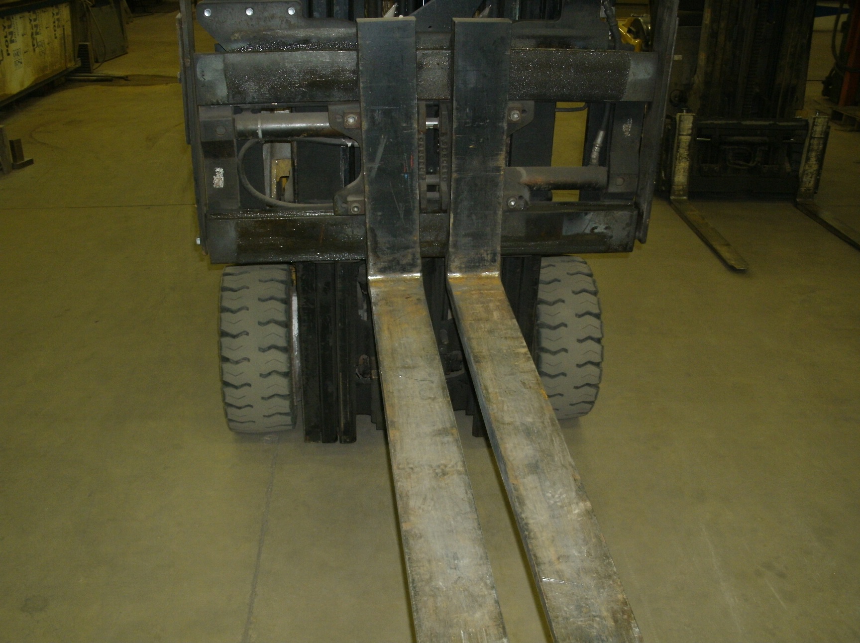

This forklift has it and yes, it is run by two cylinders. The forks are supported on the top and bottom where they slide by fairly wide supports to prevent binding, which is my biggest concern with my design. I'm guessing this forklift uses a flow divider between the two cylinders, but I don't know for sure.

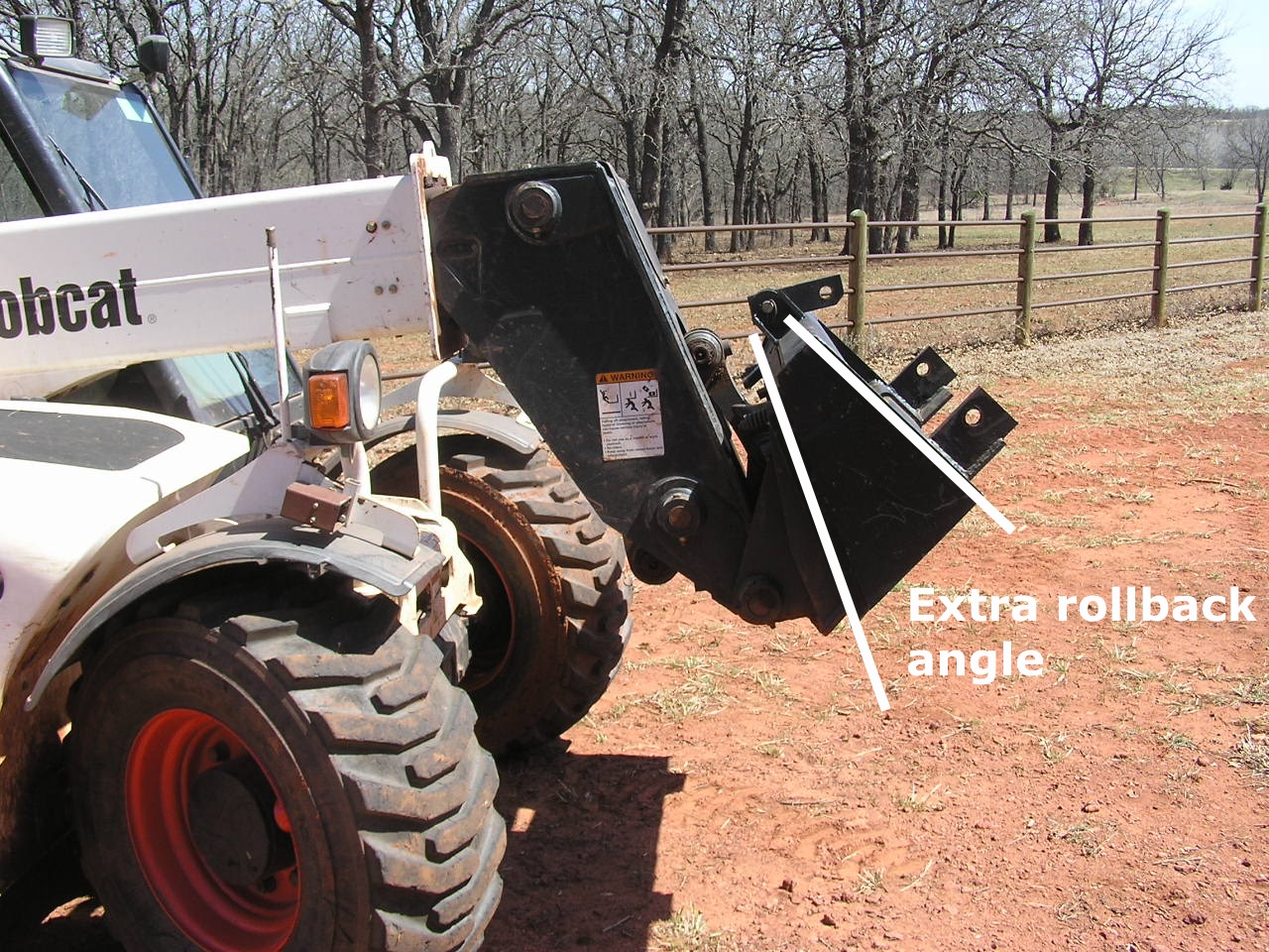

Well, here goes rev A. Not 100% fully drawn but it shows what I'm after. I included 10 degrees more tilt back along with adding the chain and sprockets. Chain I already have and the sprockets are from McMaster. I moved the cylinder up top to the block to reduce the leverage for binding the block on the support bar. I'm thinking maybe the chains will help keep the forks from binding by the pulling action when the cylinder moves. What do you think?

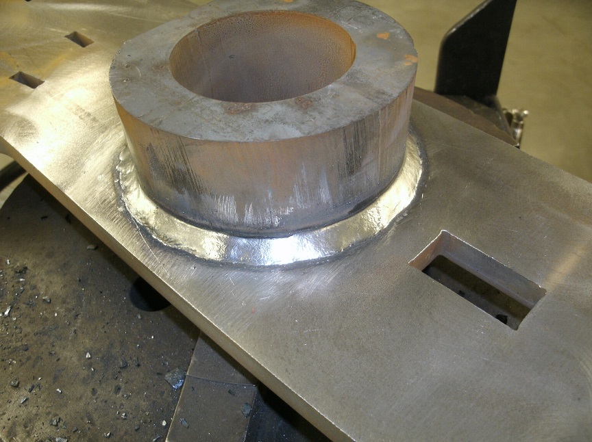

I welded the cylinder mount on top of the block and while that is cooling down, I set up the other fork on the mill and ran the boring head through it. I left several thousands so the reamer could take care of final sizing. The plan from here is to powder coat the forks and then hone the bore to final size for a sliding fit.

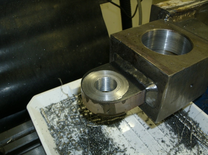

Did the machining on the other fork today. One thing I want to be sure of is the alignment of the cylinder threads to the fork block. I left the hole smaller so I could bore it straight and also face it so the jam nut doesn't introduce a bind. I don't have a collet to hold the 1-14 tap so I had to tap it by hand. I use an 1/8" hardened rod sharpened to a point to act as a center on the tap while using a wrench to turn the tap. The bungee cord keeps down pressure on the tap to free up both hands.

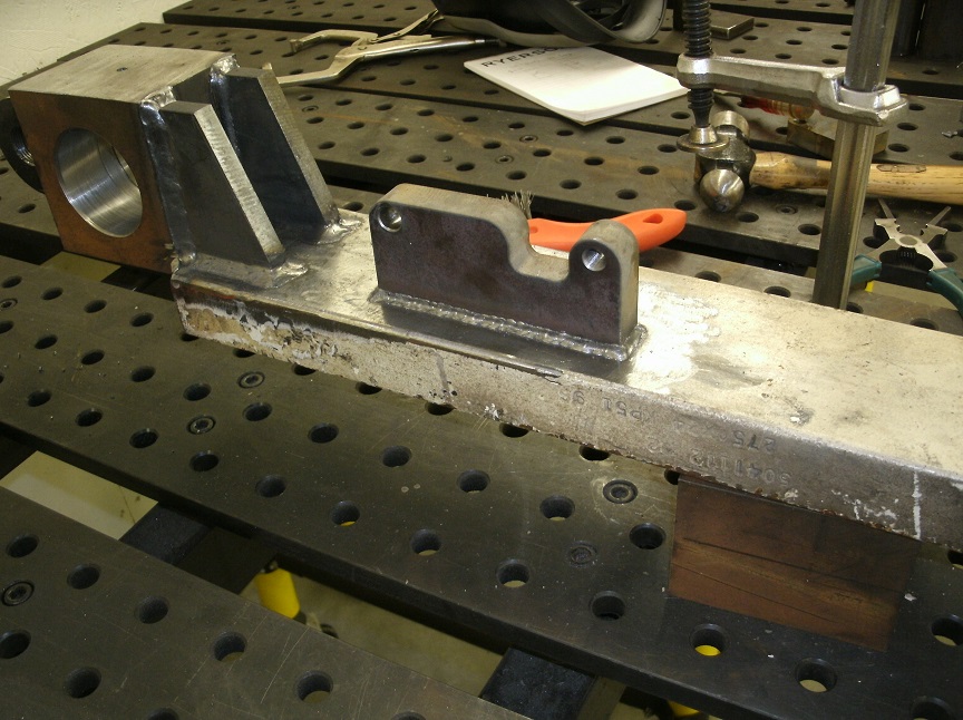

Located and welded the chain anchors to the back of the forks. Tried to keep the welds small here to minimize stresses and warping. This should be it for the forks except for coating and honing and my back is grateful. Welded the support bar collars to the side plates and tomorrow they go on the mill to get bored to size.
