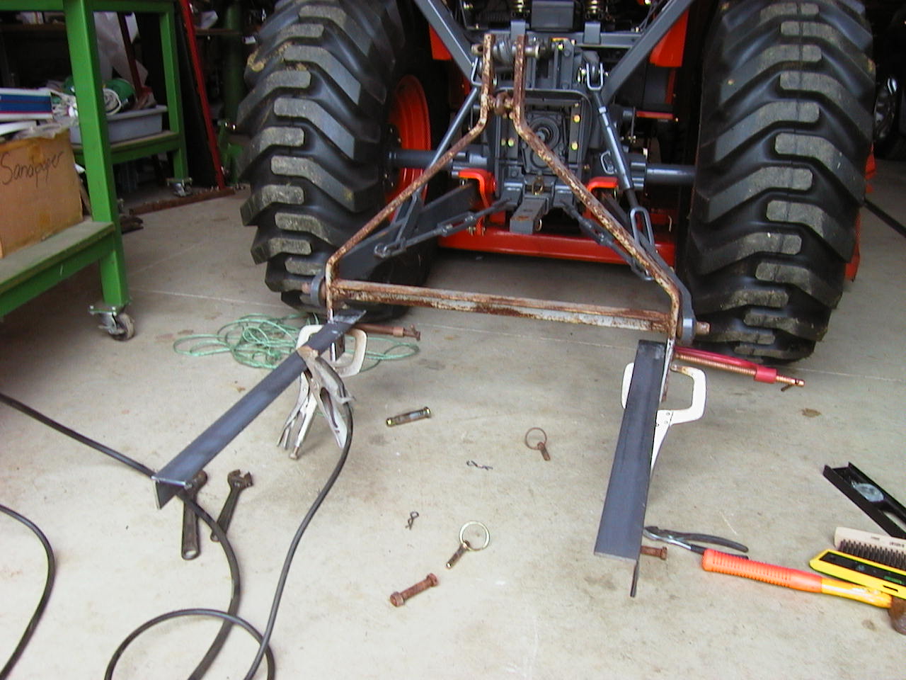

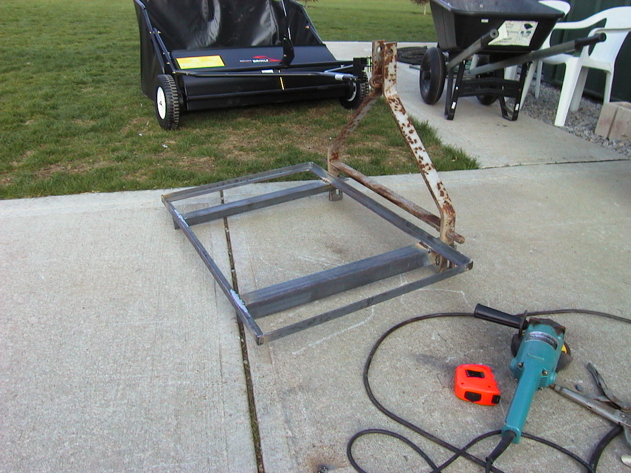

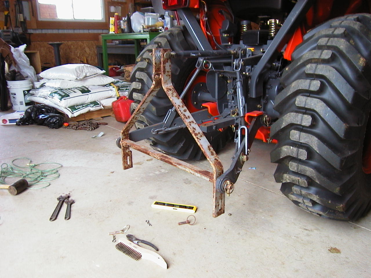

When I mow I always see weeds I can't find later. So I picked up one of these 3 pt hitch things at an auction for $35 and made a small 15 gallon dedicated sprayer for my B7800. The platform is only maybe 2' X 3' and I and leave it hooked up most of the summer. I used a piece of OSB for the bottom.
When I find the errant weed I zap it and the $$ involved is minimal. It goes where I go. I haven't even painted it yet. Maybe this will give someone an idea.
