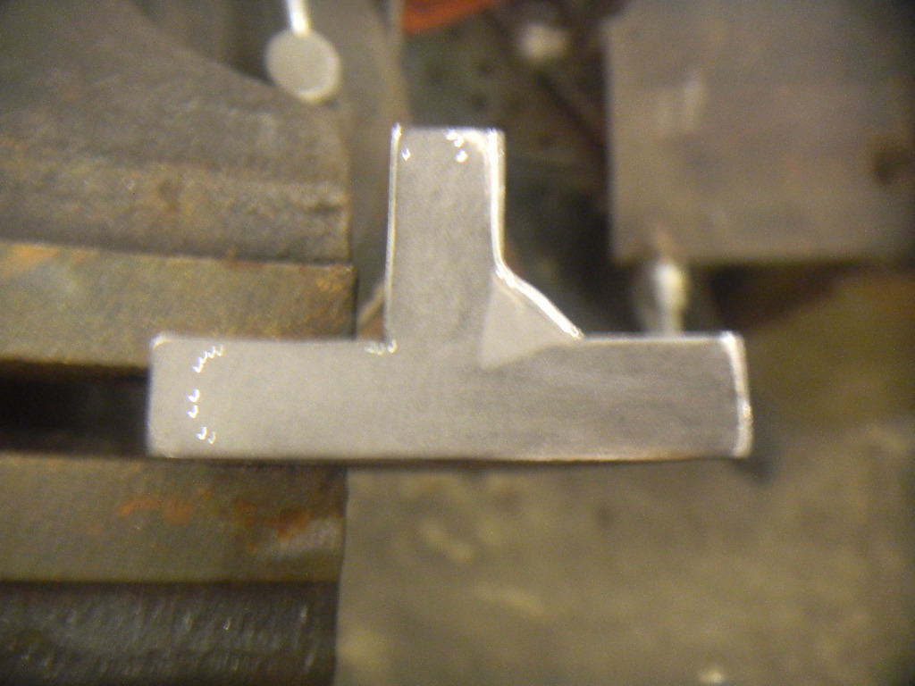

From what you've told us so far, I think you need to find a "teacher" that's LESS in love with playing with a $6k machine you will NEVER buy or need, and MORE in love with actually TEACHING. So far, he hasn't told you about ways of holding the gun, practicing MOVING the gun BEFORE you pull the trigger, HOW and WHY you do certain things and DON'T do others, or much else that beginners SHOULD learn first.
Seriously, if I were in your shoes I'd ask for my money back - you would learn far more in less (FREE) time at weldingtipsand tricks.com....
For example, your "leaning tower of pisa" welds - welds don't "pull" much at all WHILE you're welding, it's AFTER - they're caused by SHRINKAGE, and since the side you welded got the most heat, it will SHRINK more and "pull" the welded piece to that side - sometimes DRASTICALLY, as you experienced. There are a few ways to combat that, some will help right away - others take quite a bit of experience to COMPLETELY eliminate the problem.
Some of the ways that work for me - set the piece you want at 90* to a slightly OBTUSE angle on the side your FIRST tacks will go, then quickly tack the OTHER side - keep moving your subsequent welds around, constantly checking "square" as you go, placing your NEXT weld on the "obtuse" side -

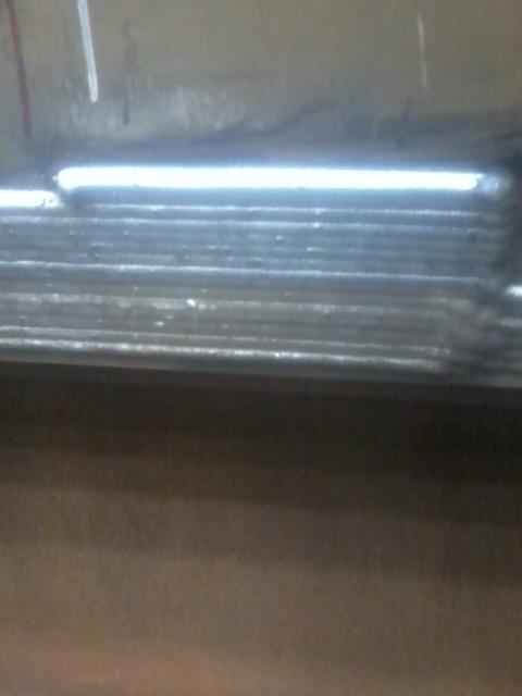

With enough practice, welds will look something like this, this was a recent small weld build-up area on a side shell plate, .045 solid wire, 95/5 gas. If I had a smart phone the picture would've come out betterah...
