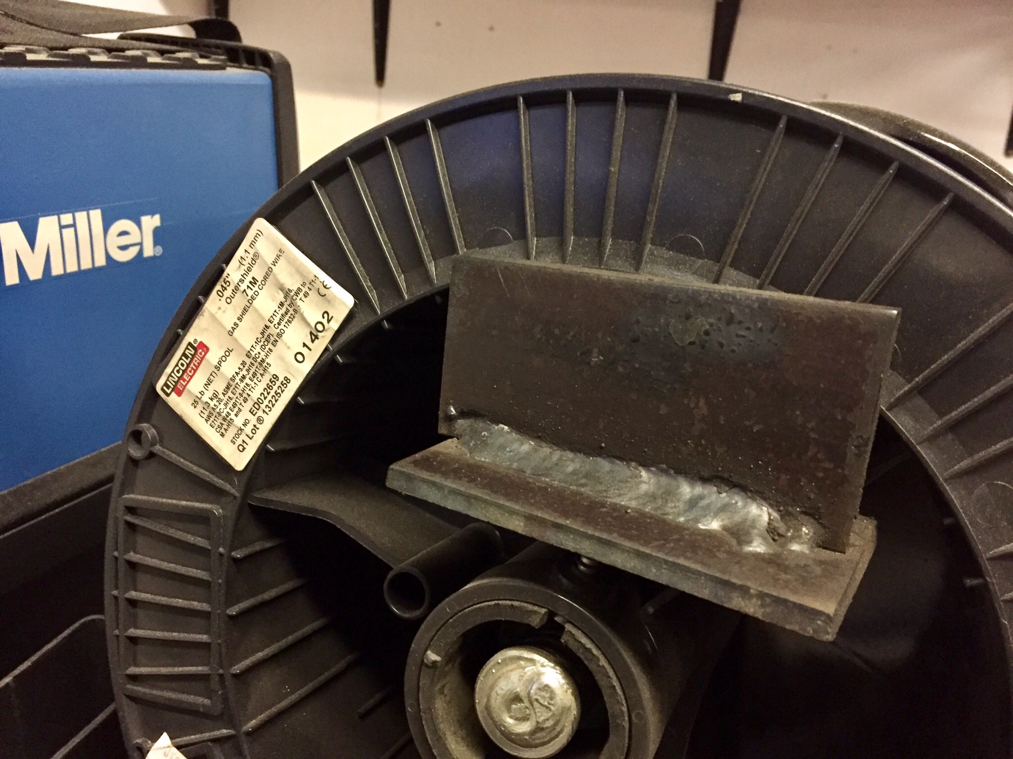

With enough practice, welds will look something like this, this was a recent small weld build-up area on a side shell plate, .045 solid wire, 95/5 gas. If I had a smart phone the picture would've come out betterah...
