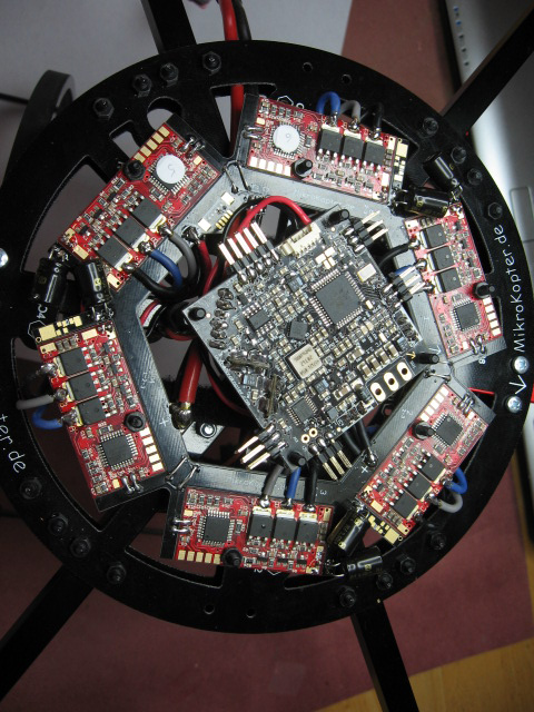

Is that an Arduino microcontroller or something else? There are some vids on YouTube with guys tuning the feedback loops from gyros and accelerometers to help stabilize the thing, and they were slinging Arduino in there. I suppose you could use just about anything.
Do you have a radio (or at least channel count) you would recommend for this kind of application? I'd been planning to start with a small electric plane and play with FPV on it, and graduate up to heli/mikro over time. I just wanted to buy one radio, though, and wanted to get something that would do a reasonable job at all of the above.
This is a MikroKopter.de product.
I originally was going to use a 6 channel and found out that for FPV I needed more. So the wife is using the DX6i and I went to a JRX-9503 (9 channel)
They do have some sort of multiplier on the market to add more channels to certain radios.

The idea is to buy bare boards from MikroKopterm get your parts from Digikey and build it yourself.
Looks like fun.
Did you build it yourself from a kit?
What is the GPS for?

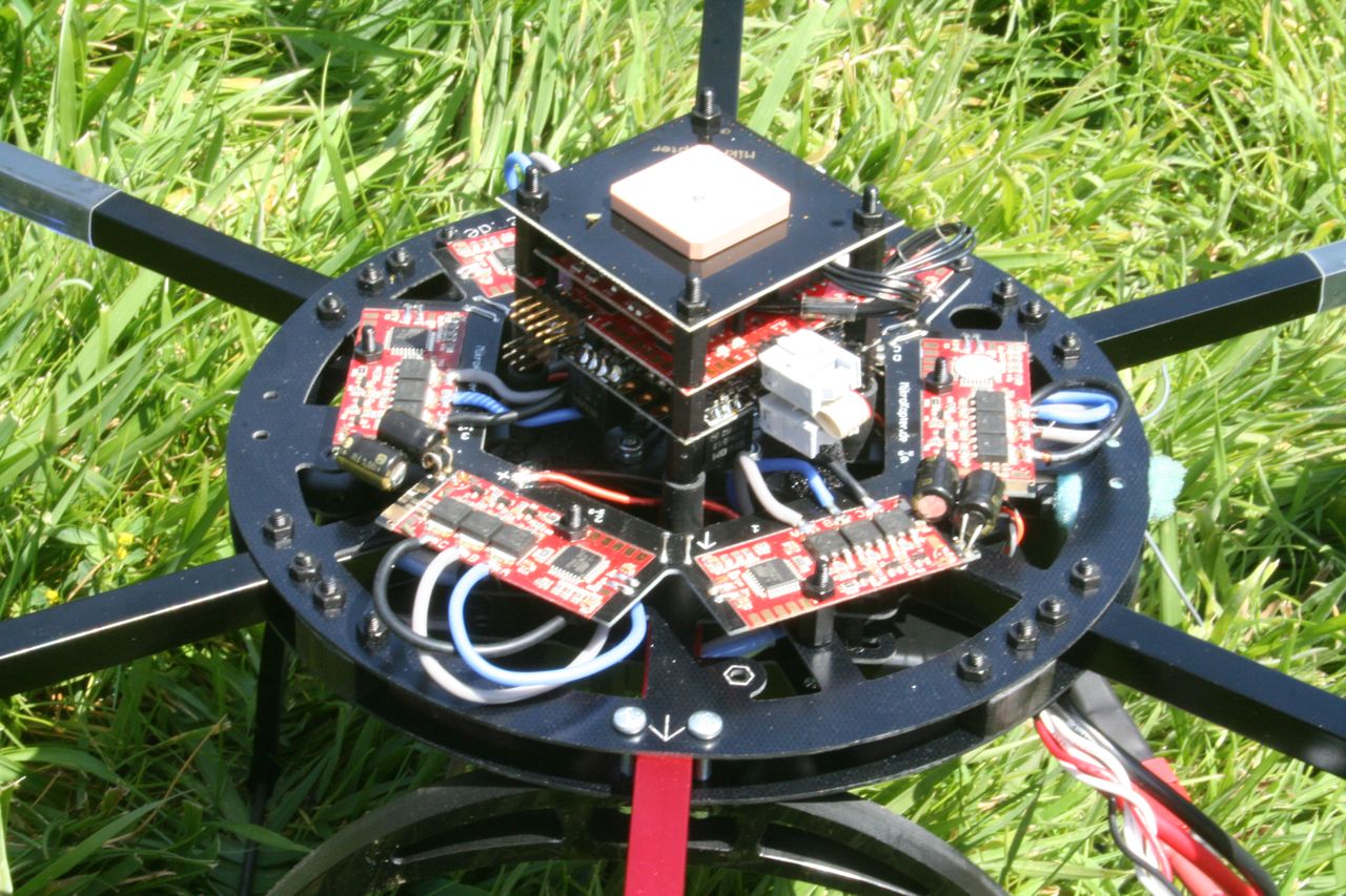

Looks like fun.
Yes I built it myself. The wife will tell you that I have about 8 months invested in the electronics. She might be right.
GPS will give you a 3D satellite lock when it sees a minimum of 6 satellites in the sky.
Once that happens it will alert you with a flashing LED light.
At that point you have use of 'position hold' and 'come home'
With 'position hold & altitude hold' the MK will hover motionless until the battery goes dead. If the wind blows it off point it will correct and return to where it was instructed to hold.
With 'coming home' you can fly the Hexa and if you get disoriented or for any reason you can throw a switch on the transmitter and the Hexa will 'come home' which is determined wherever you plugged in the Lipo battery.
