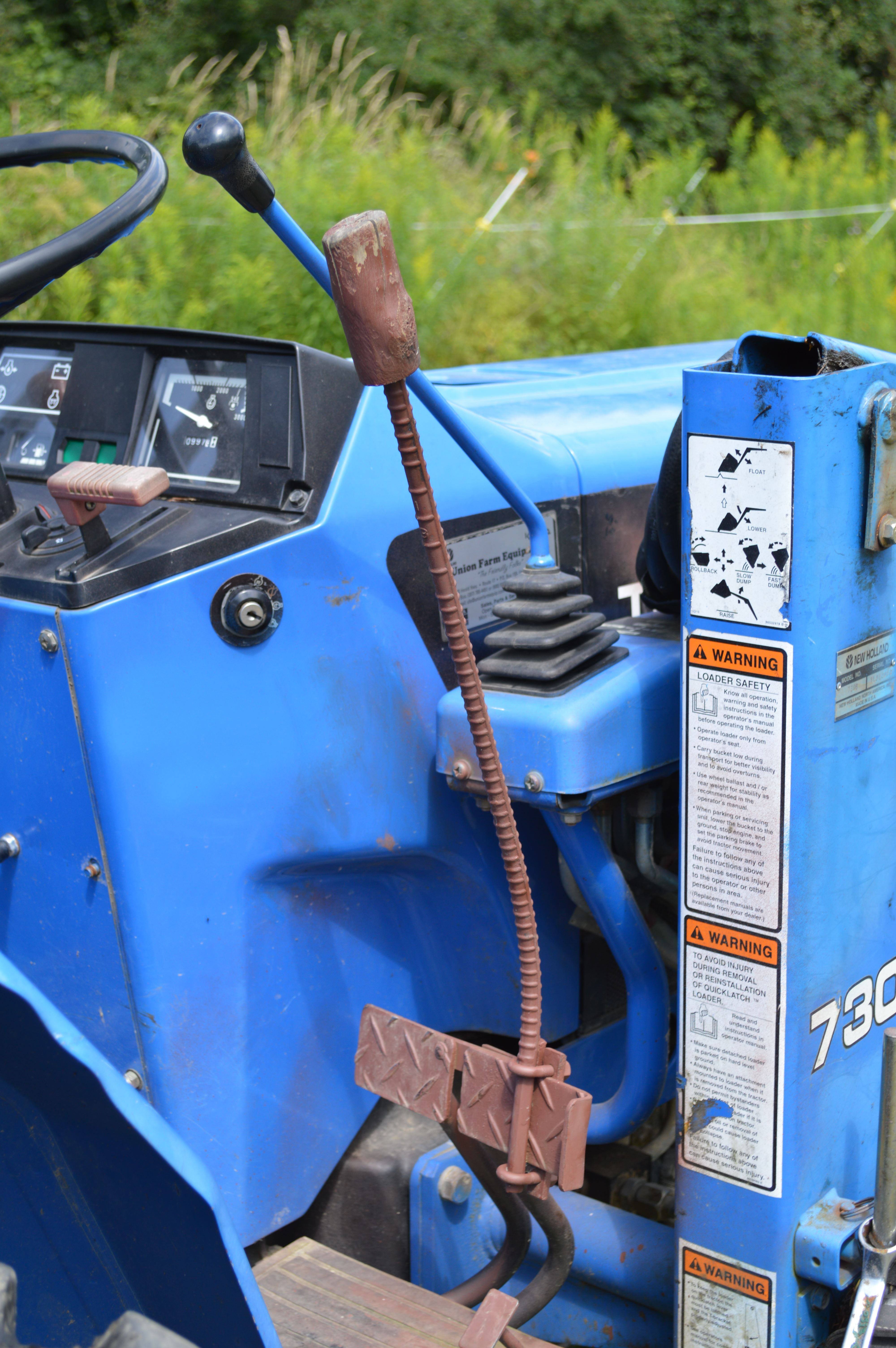

I can't use my right leg on my tractor due to my arthritis. I have a gear tracor. I still needed the brake so I set the brakes to work together and bolted a piece of rebar on to the brake lever with 2 u bolts. I drilled a wood top to fit over the handle and bent the rebar so it would be at the right angle to not interfere. I have a usable hand brake. Seems like you could do something of the same for your hydro pedal.
/ special needs kid #18
This is an excellent idea!
Version 2.0 could be a pivot bracket With individual levers mounted above the pedals that when the handle was PULLED, the pedals would be PUSHED.
My 3301hst has the asinine right foot HST treadle and brake pedals also. Near worthless.
