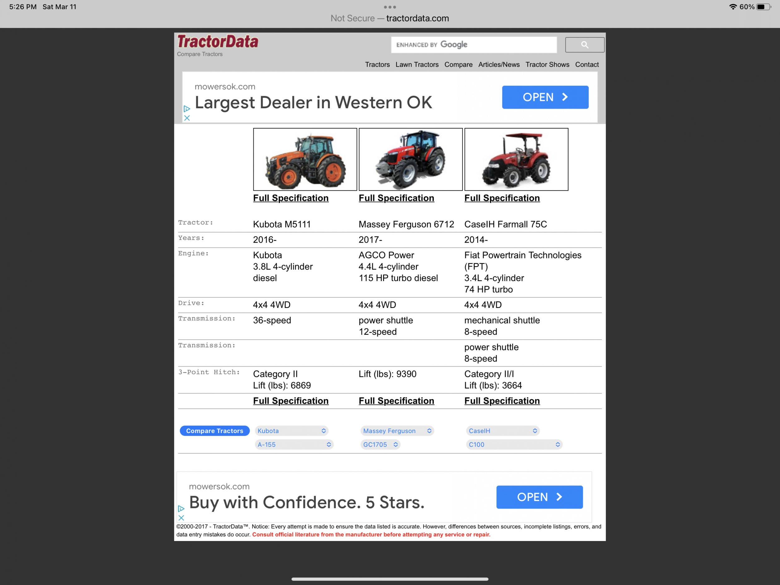

I would go onto Tractor Data and compare them. they have a comparison tool.
See which one weighs more. See if one model has closed center load sensing hydraulics. Look at drawbar HP. A Dyna-4 transmission is nothing special.
If I had to guess, I’d say the Massey will be better tractor. It has a little more power and weighs more just for starters. Engine has more displacement.
The CaseIH is a smaller tractor.

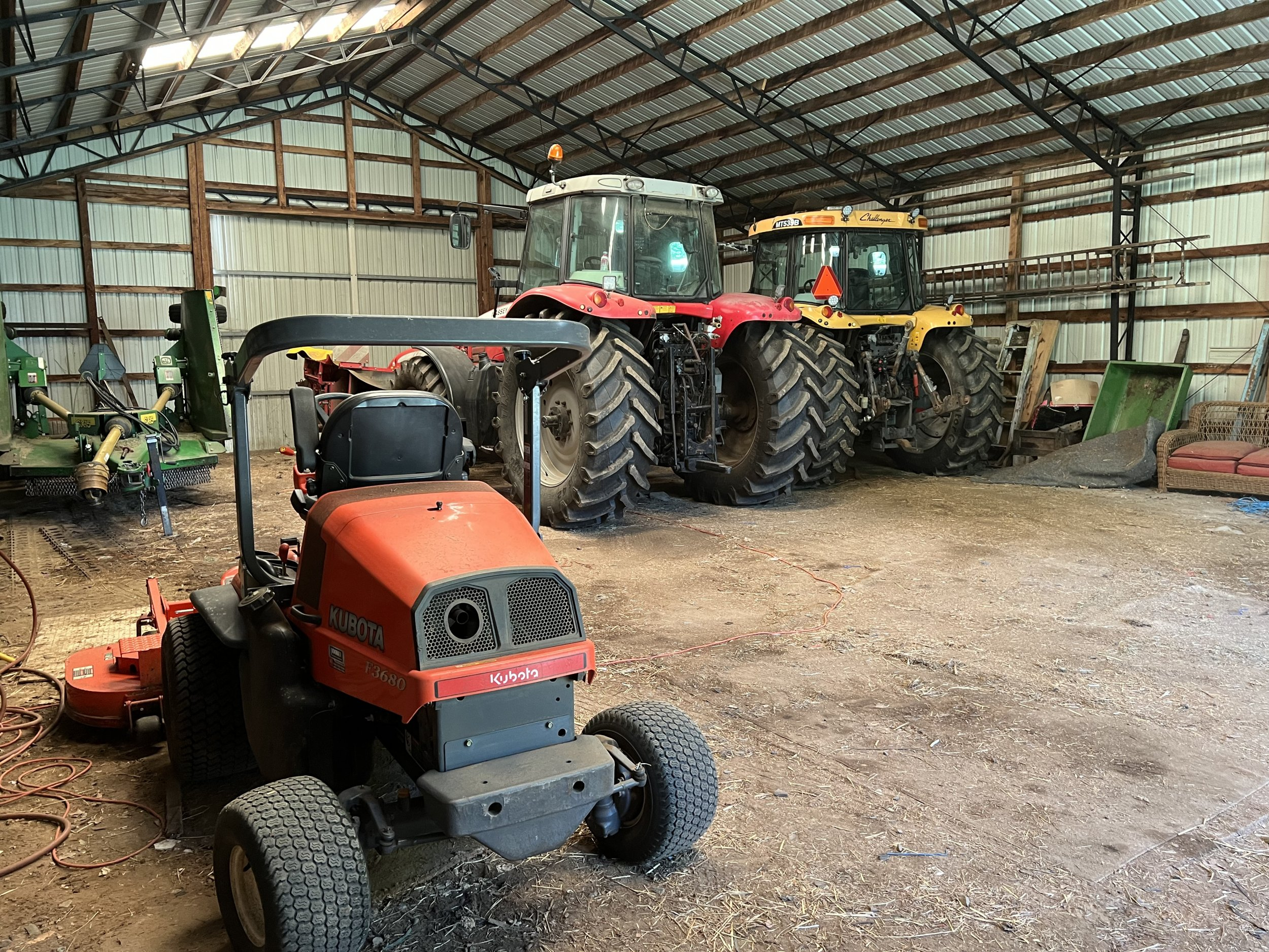

Nice thing about AGCO dealers is they are farm based. They will bring a lot of knowledge. I love my 2 AGCOs. They have been great to operate.
   / Heavy medium-duty tractor options? Massey 67xx, CaseIH Maxxum, or Kubota M5-111? #5
I like that MF you have.
