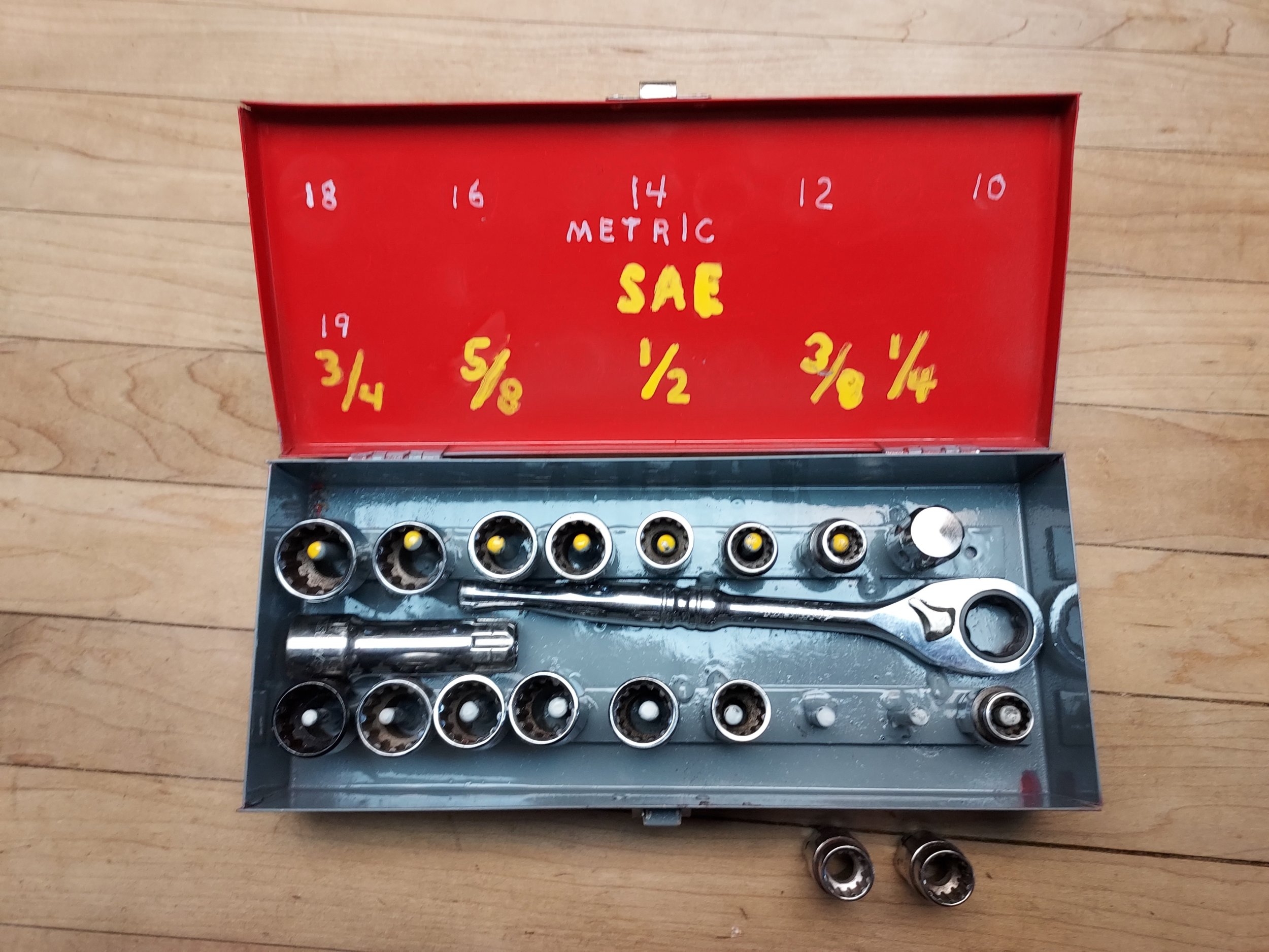

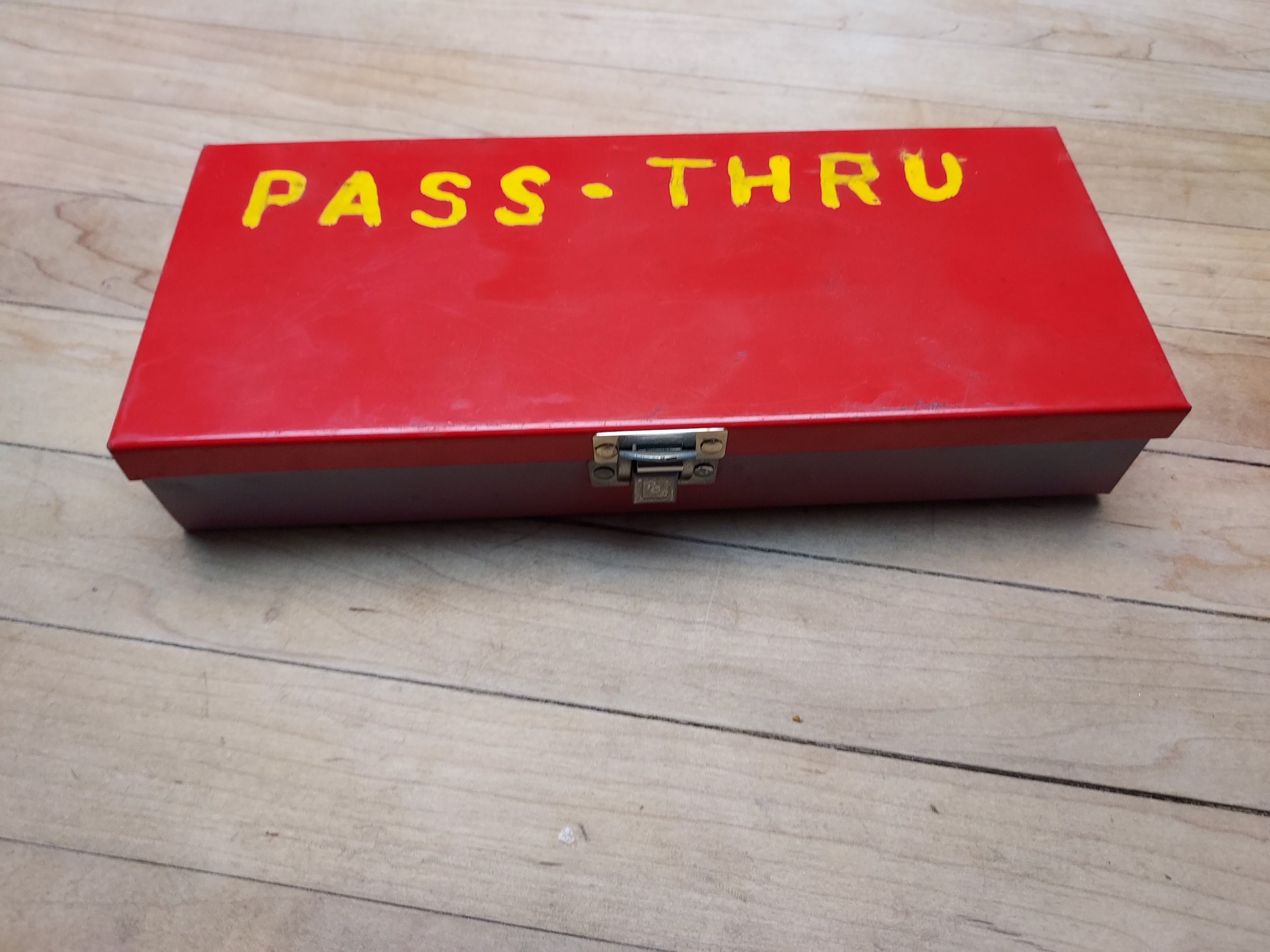

My pass-thru ratchet set came with an over-sized, molded plastic display rack with illegibly marked round pegs that did not hold the sockets securely. I bought a 1-1/2” x 4-1/2” x 10-1/2” steel case on Amazon, welded pegs in 2 rows, color coded the pegs and marked the sizes legibly. When the lid of the case is latched, the sockets are secure. Photos below.

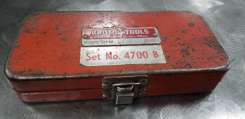

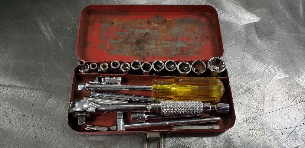

I sure miss the old metal socket sets. They fit anywhere and can hold a few extras.
