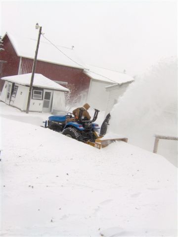

You do want the snow blower wider then the tractor's rear wheel track...you can see the blower on my 4520 is pretty big. It's also pretty heavy (about 800 lbs). I can't recall the PTO HP specs for a 74" Frontier snow blower, but I do recall the Woods equivalent recommended 20 PTO HP, minimum. Your Mahindra has, per TractorData.com, 21 PTO HP. I'm sure it will work OK...but probably pretty slow. If the blower is a 60" unit...well, no problem! If you don't have a loader, you might need front weights. You'll know the first time you raise the 3PH.
Good luck and enjoy your snow blower!
