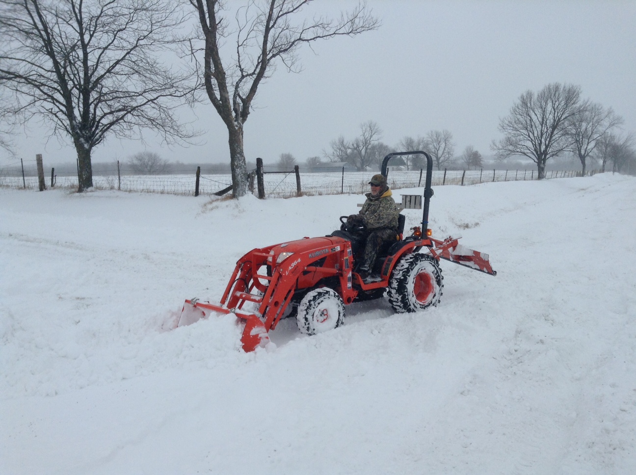

Here in NE Kansas, I got the same snow situation as "coldstream". That much snow back to back is unusual. And that wet, heavy stuff in round two would make any combination difficult. My 11 HP walk behind snow blower wasn't all that effective either. So..........With my 2012 year B2620 (R4 tires) I had fairly good results with a 300 lb rear 5 ft blade, the FEL and two link ladder chains. I won't load the rears nor buy front chains...nor invest in a front plow for my situation.
I do, however, encounter different situations since I do six neighbors on our road (for free). In some places there are drifts, some are close quarters, some are very hilly, some are concrete, some are black top and some are gravel. And of course, the county road grader and truck plow make driveways inpassable until I get there with my FEL.
I'm learning how to approach each situation by using the FEL, or pushing the snow, or pulling the snow or piling up the snow. My biggest problem was adjusting the rear blade with the 1/4 inching valve that apparently is not adjusted per the dealer. I'm looking into that today. :confused:

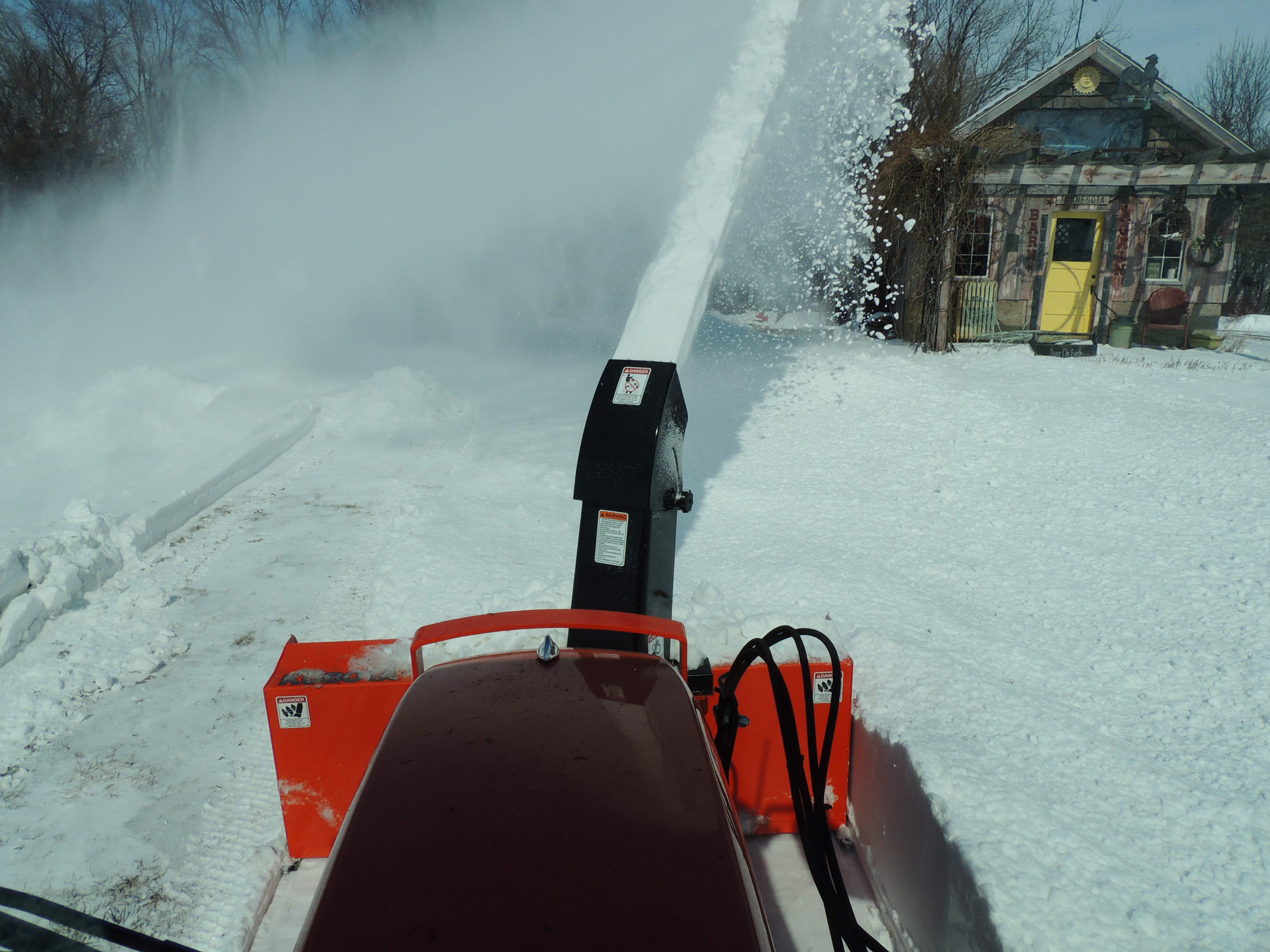

Snow blew in, and the FEL wouldnt make a dent. 7' two stage snow blower was grunting behind the 70 horse 4WD White, but it got through.
Fluid filled tires, no chains, about 12,000 lbs for tractor, plus blower.
Here is a pic of my 6 foot son standing beside the end results.

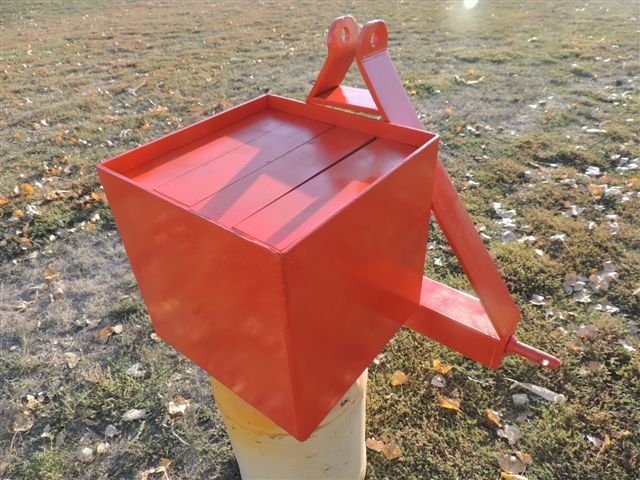

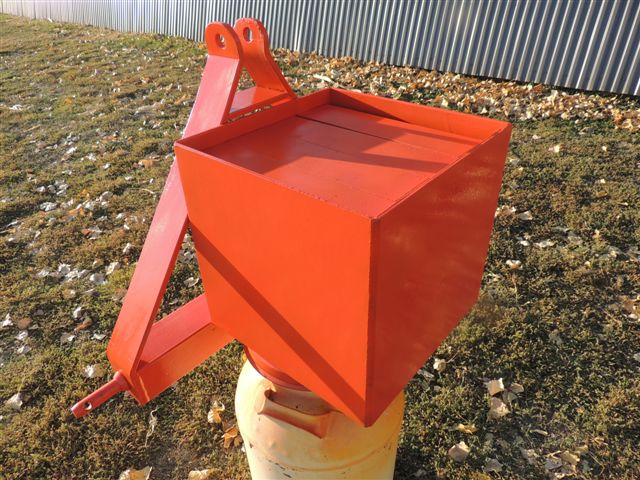

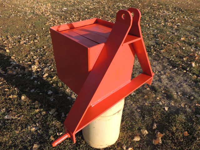

I'll explain my frustration and listen to your all's expert advice! B2920 with FEL and R4 tires purchased spring 2010. Tires are not loaded and I don't have chains. I've got a 4' king cutter (i think that's the brand) blade on the 3pt, blade turned "backwards" with a 3" ABS pipe installed on the blade to minimize gravel displacement. Gravel driveway, 500' long. I've removed several 2 and 3 inch snows over the time I've owned the tractor without much trouble. I use a combo of running the blade down the drive (set at the middle angle) and then cleaning the piles with the FEL. However, in the last 2 weeks we have had two 10 inch snows about a week apart. Trying to move this much snow took me to near the limit for this tractor. The first snow was pretty dry and I was able to move it OK but my blade isn't heavy enough so I never got clear down to the bottom of the snow, even without the ABS pipe installed. Would adding weight to the blade help with this? Of course if I add weight I'll dig more snow and come up against the most significant problem which is lack of traction. The second snow was so wet that the blade would just pull a few feet of snow before I broke traction. So I tried using the bucket to "skim" the snow and I also quickly lost traction after traveling just a few feet. I am open to loading the tires and/or adding chains but I wanted input from you all as to how much these will really help me. And yes, I know some will say "buy a bigger tractor" but that is not an option due to 1: finances, and 2: these big snows have been relatively rare recently so I'd like to adapt the equipment that I have as much as possible. Well, enough rambling for now, lay it on me!
This counter weight has served me well.
