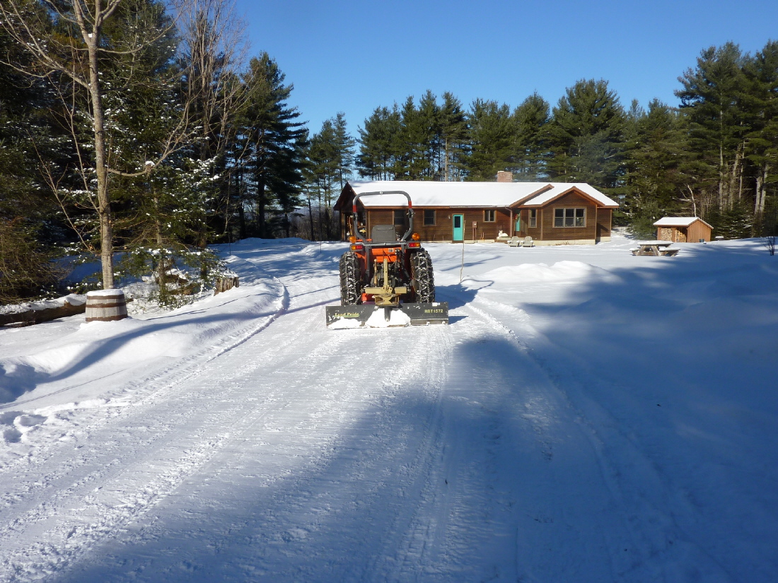

/ Snow Removal Frustration #17
In my case I had 4wd, loaded R1 tires, and plenty of weight. Tractor was useless on packed snow or ice. Added rear chains and winter traction problems disappeared.
