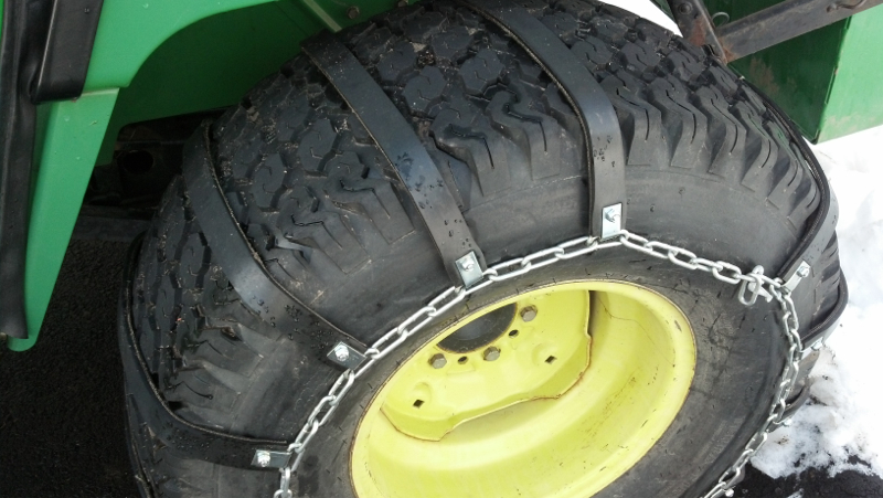

Once I took into account shipping I found tirechain.com to be the cheapest. I just got the Duo-grip chains, should arrive today so I can't claim how well they work yet. But it has to be better that the current sliding.
The chains arrived and they fit nicely. I got them on hand tight and didn't need tensioners to keep them in place.
The chains are really heavy (69lbs each tire) and seem to work pretty well.
But the ride is surprisingly rough, with ice on top of gravel it is really bumpy driving down the road and I find it hard to use the FEL because the machine is bouncing around so much.
It will probably be better on a softer surface where the chain can sink in, but I got this for ice. I suspect I wanted the 'ladder' style.

You may be running more then the recommended tire pressure. A tractor tire meant to run at 20 psi will ride like a stone wheel at 32 psi.
/ Snow Removal Frustration #75
Perhaps, but I wouldn't think so. The tractor just arrived from the dealer after they added Rimguard to the tires. So far the dealer has been pretty careful about things. I will verify that pressure and rimguard level.
Well, I guess I shouldn't be trusting the guys at the dealer. Both fronts and backs were over 30psi. Letting out a bunch of air in the rear let it ride much nicer with the chains. But they are still way rougher than I expected.
