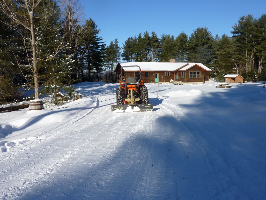

With a rear blade I've had a lot better luck running forwards dragging the blade behind me for clearing snow. Running in reverse makes the blade want to dig in and I always ended up giving the driveway a washboard texture. I have used this to my advantage a few times on ice by getting the blade to chatter, chopping up the ice a bit and giving it some tooth. I never put a pipe on the bottom of the blade so I don't know if it makes things any easier. I always used top link length to control blade cutting angle, and sometimes ran the blade the wrong way so it would ride up a bit and smooth things over.
I agree that having a blade that covers your wheel width is pretty important. Maybe a wider blade is in order. Maybe you can narrow the rears a bit on the axle, not sure about your machine. Maybe a bit of both.
Come spring there will be some repairs and crowning to do, but that's the beauty of gravel. You can mess it up and put it back with the same implements. Just don't widen the gravel every time you plow otherwise you end up with something wide enough to land a Cessna on after a few years.

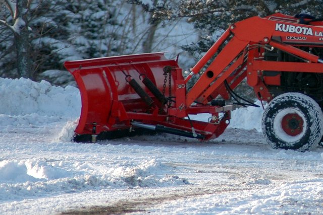

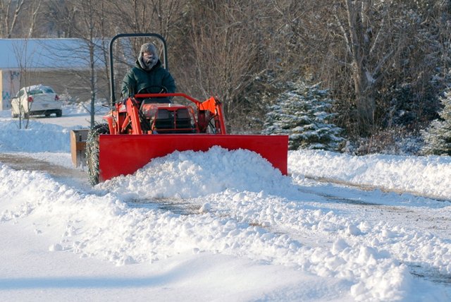

Here's my new-to-me plow that I mounted on my FEL for plowing snow on my B2400. I've only used it once in a decent 6 inch snow. Overall it worked great. I did have some steering issues. Going around turns the front tires would lose their grip. I bought some chains for the front which, hopefully, will alleviate this problem. Chains on the rear helped tremendously.

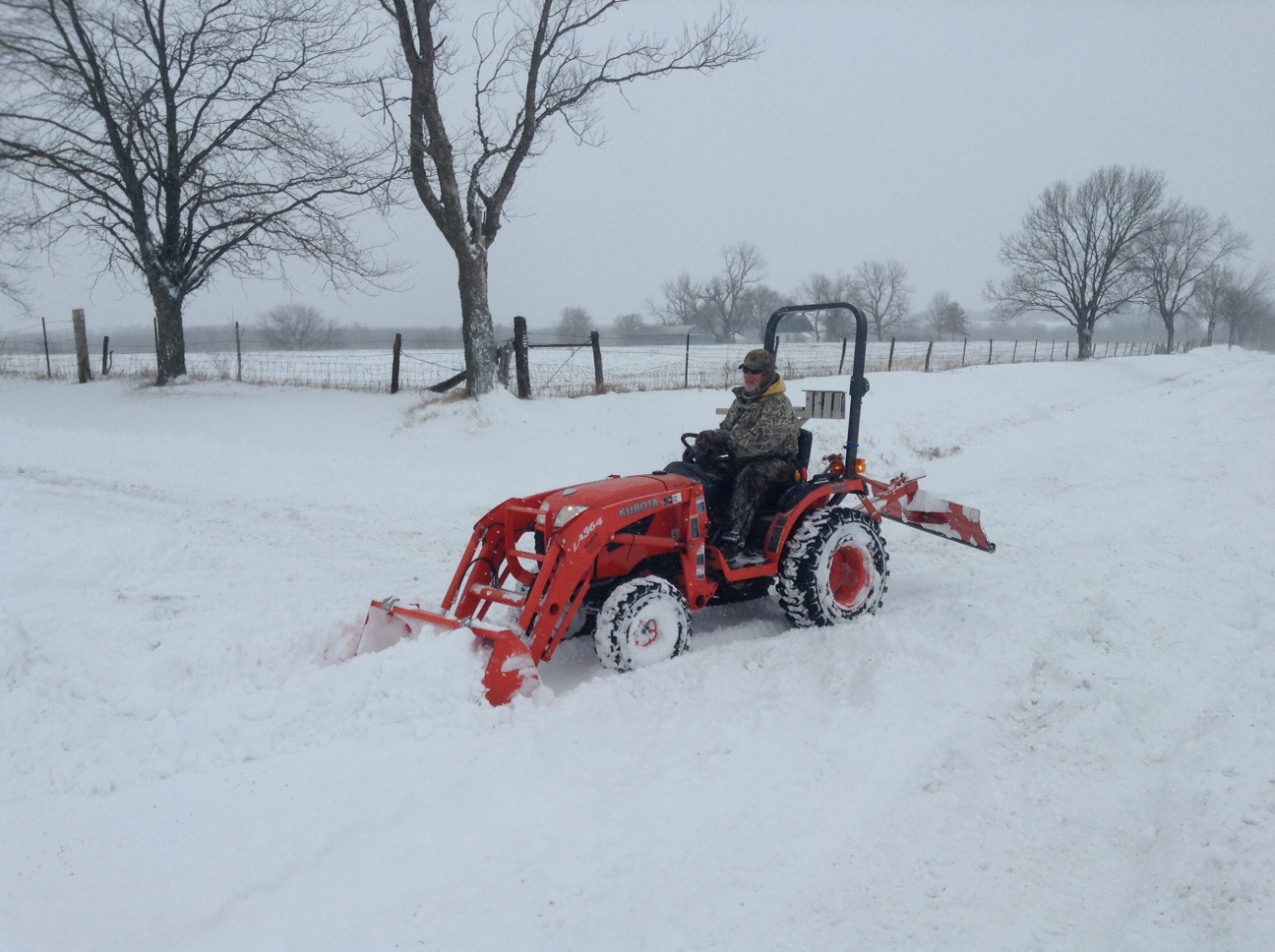

Of course there are different designs and applications. The most aggressive chains work great but if the operator insists on spinning he can tear up a paved drive ,concrete or asphalt, pretty quick. These work great but cost real money new.
ice chains
If you are concerned about tearing up paved or concrete try the rubber chains. I picked them up this year and had no problem unless ice under the snow on my hill but nothing will help on ice.

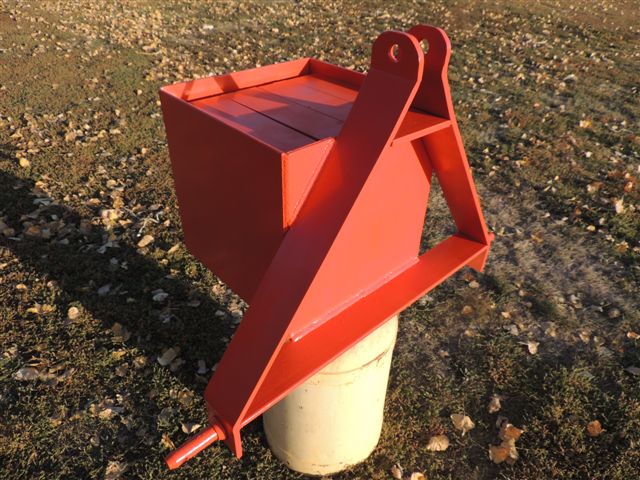

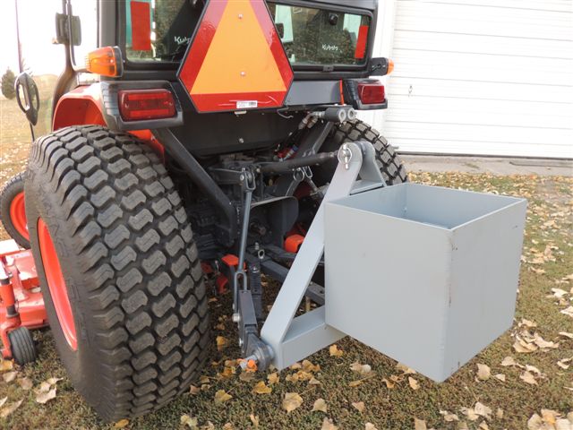

I would add weight to your scraper blade. You should be able to come up with some way to do it. Maybe dumb bell weights mounted on a pin welded to the center of your pivot point on your blade. Weight will make a big difference when trying to move snow. I personally would never load the tires some times you need to make the machine as light as possible. Once loaded your stuck with them. My driveway is 1200 feet long, I use the loader for my snow removal not the best but its what i have. I made a 500lb ballast block for the 3pt and it turned the tractor into a tank. The last blizzard we just had was 33" inches of snow and thats without the snow drifts. Needless to say it took me 8 hrs to clear all the snow off 1200 ft plus the house area. Sometimes you just need to make due with what you have. Like you said you don't get that many big storms so i would not load the tires, i would find a away to add weight to the blade. Also add some weight to the loader bucket when scraping, Grab a nice scoop of snow and see if it helps.
