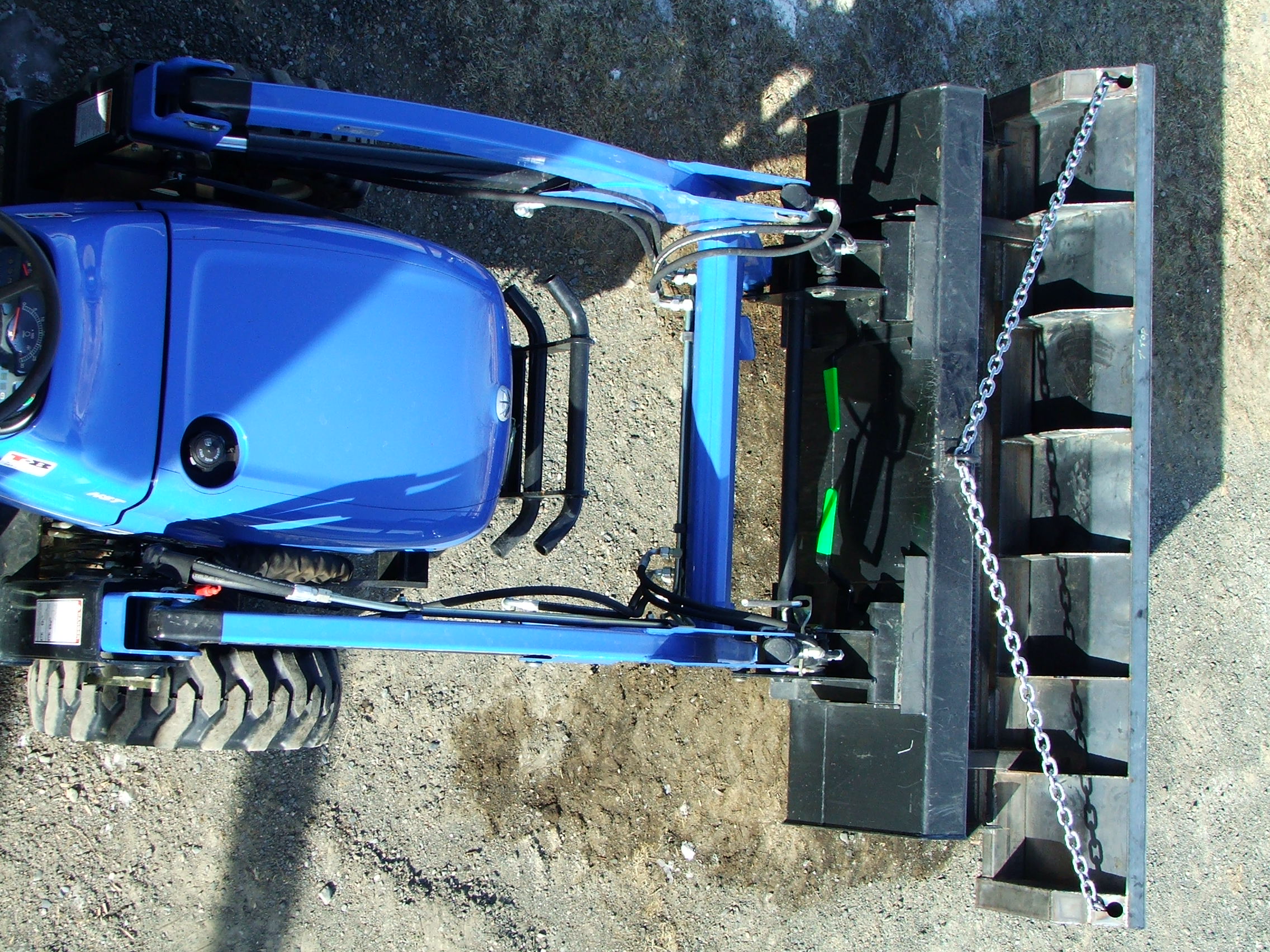

OK here's one of those stupid quesition that said I'd ask when I first
signed on, what holds it on the bucket? I see chain holes in the corners,
I'm thinking they go back to some hooks on the bucket with chains?!
Ok How dumb am I ?? :D

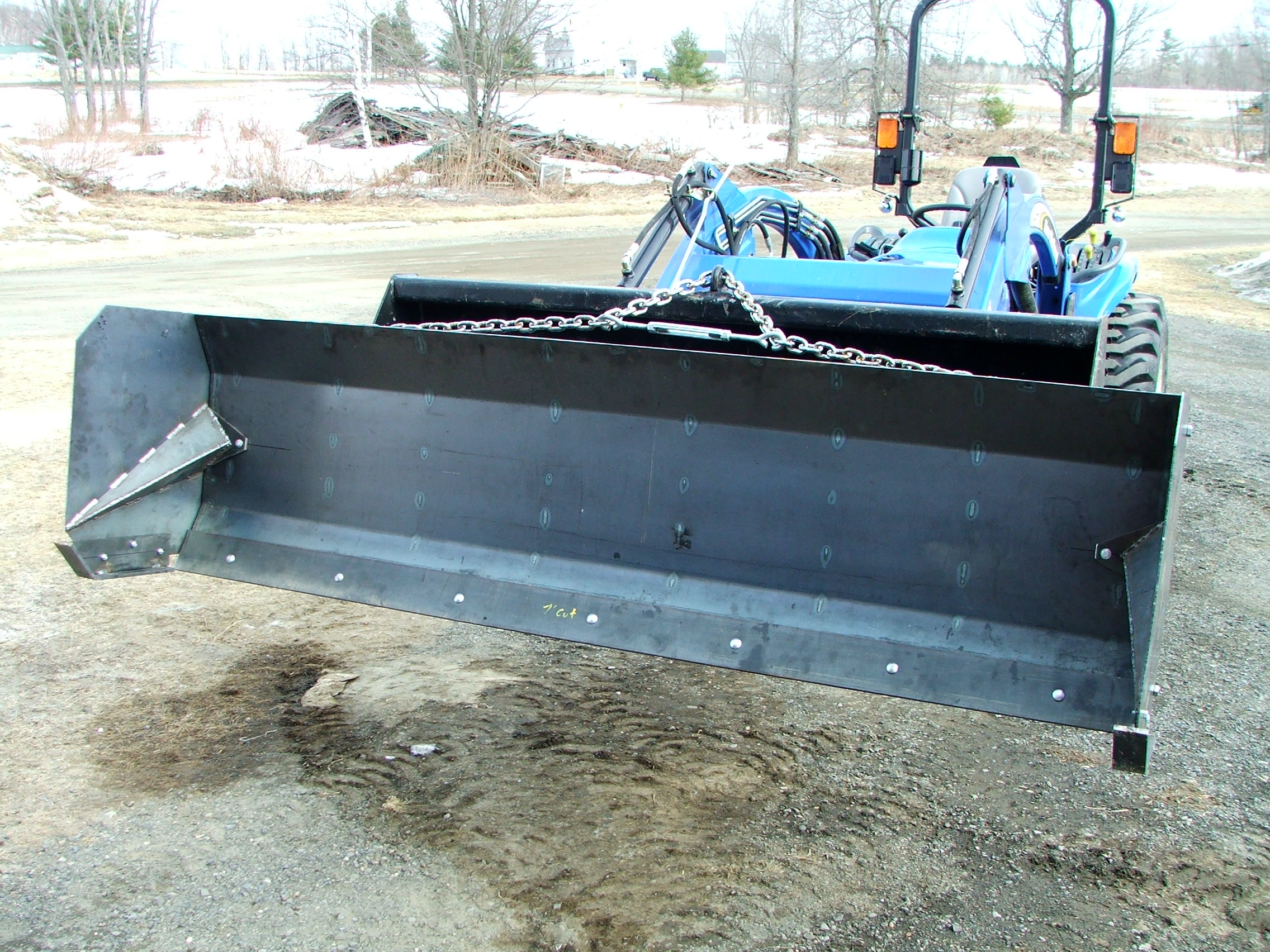

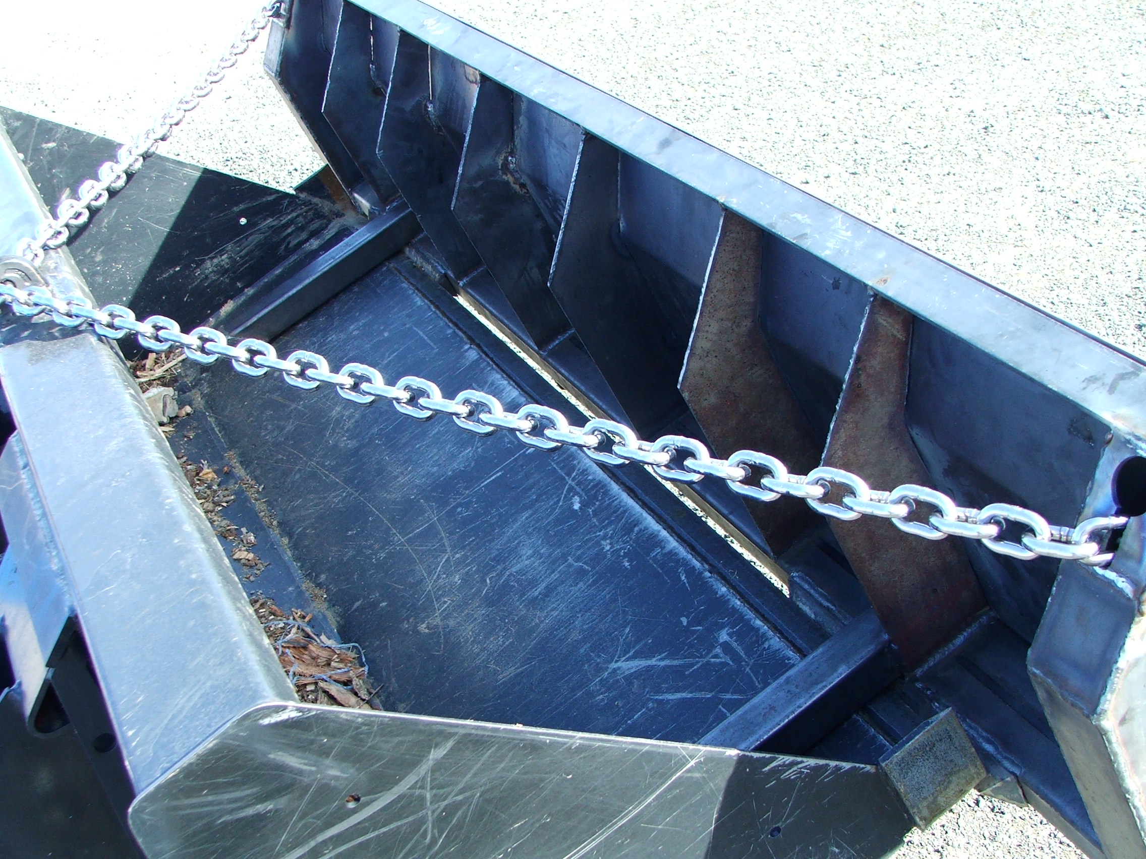

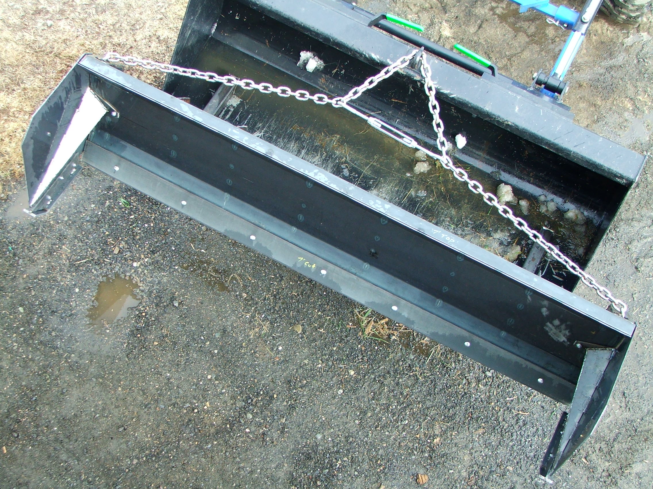

A chain will loop from one corner of the plow, through the hook on top of my bucket then to the other corner of the plow. Either a lever or ratchet style binder will take up slop.

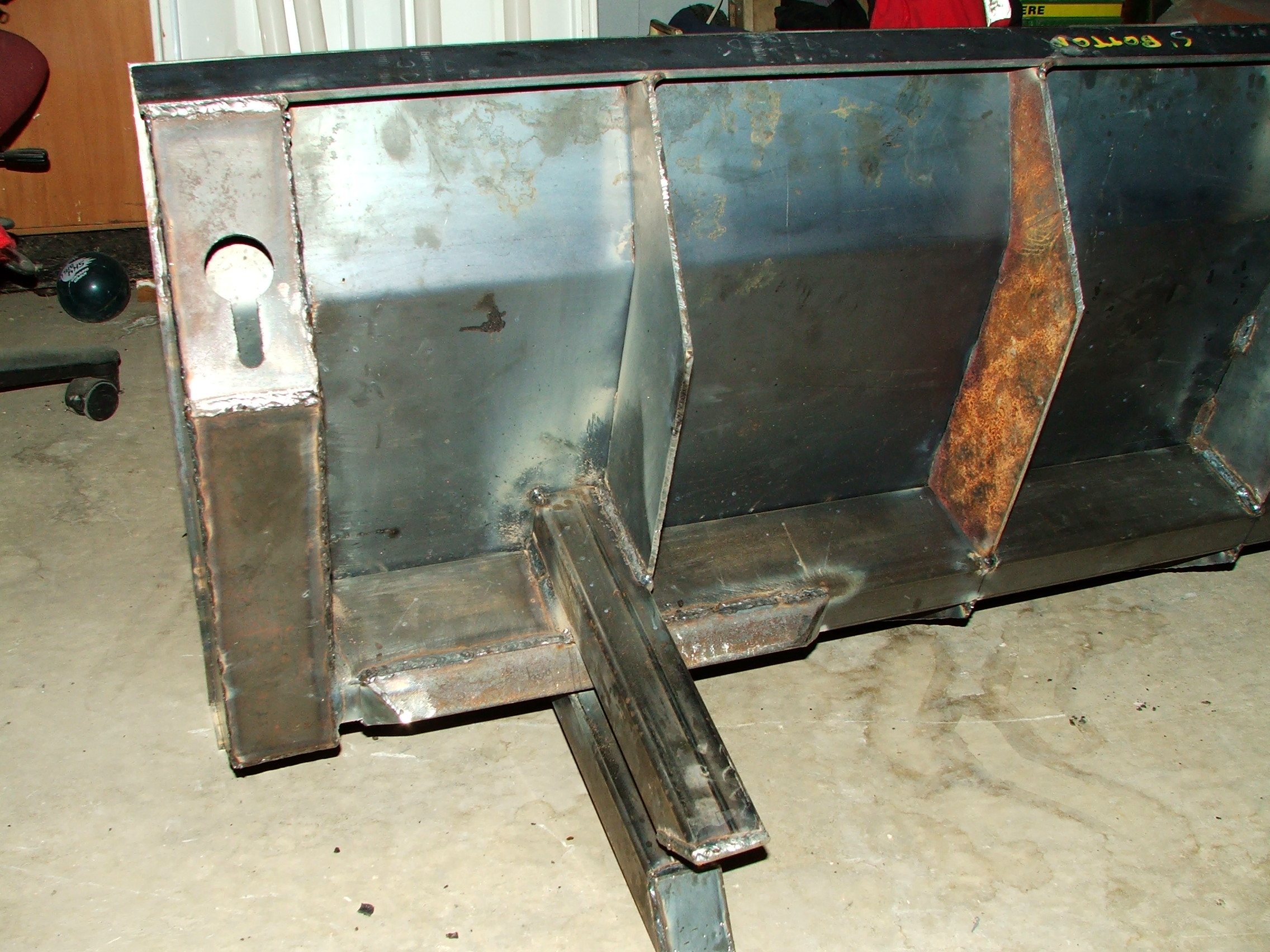

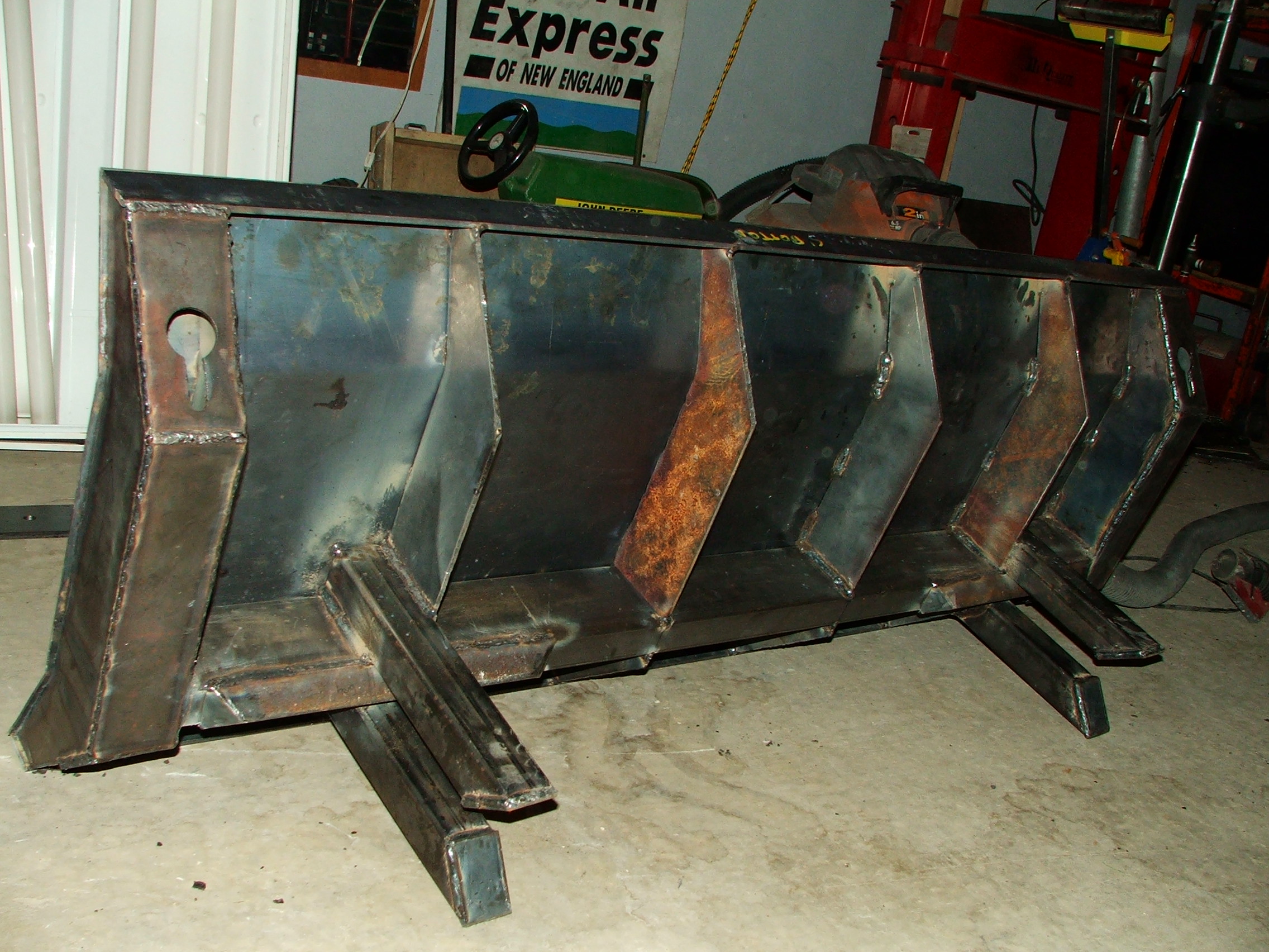

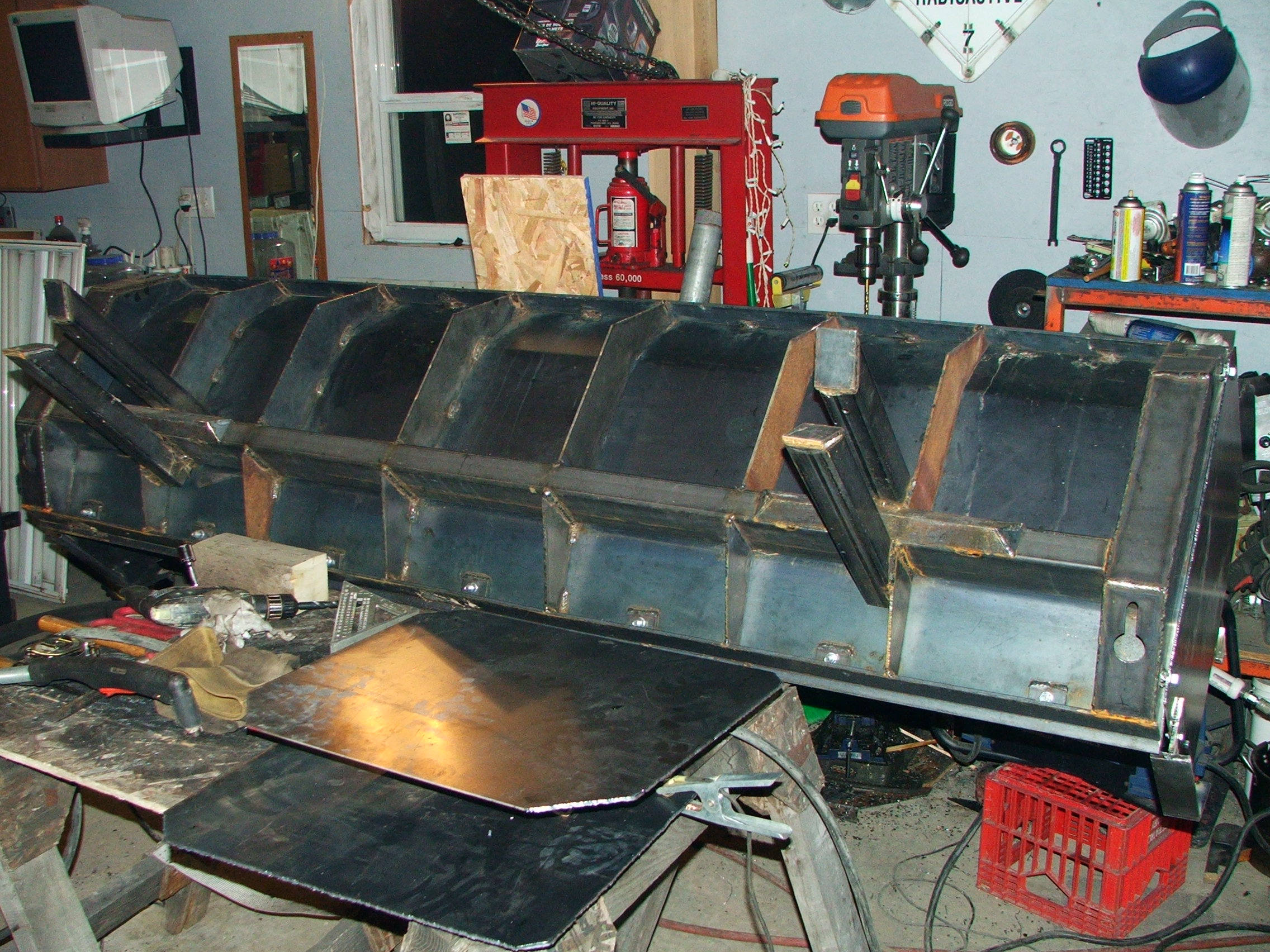

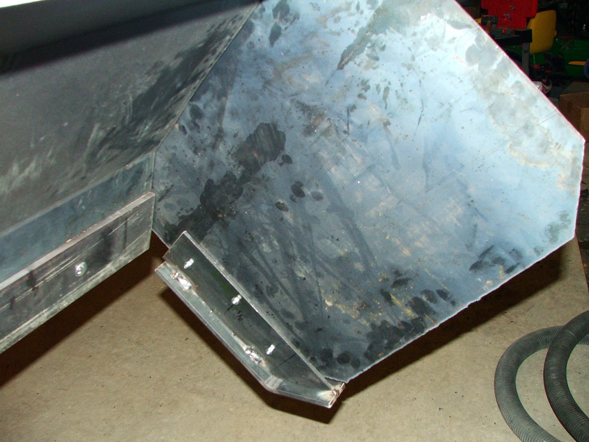

Maybe a good thing this is almost done. Would be done if I WASN"T AN IDIOT!!! Spent most of the morning putting the pieces to make the box section at each end, including the chain holes. Got them all welded into place, meaning two welds on each end, each 24" long. No easy task, as entire 7' plow had to be stood on end to get the angles I need to make a clean weld.
Soooooooooo......... here I am welding the last of four 3" long butts where the "box" meets the top and bottom of the plow and.......... and I realize I have the hooks at the bottom of the plow on EACH end. OOF!!!!
So, new pieces made with hook holes and welded into place. Just need to use plasma wrench to open up hooks that are in wrong place to keep from being a water trap.
Now to fit cutting edge!

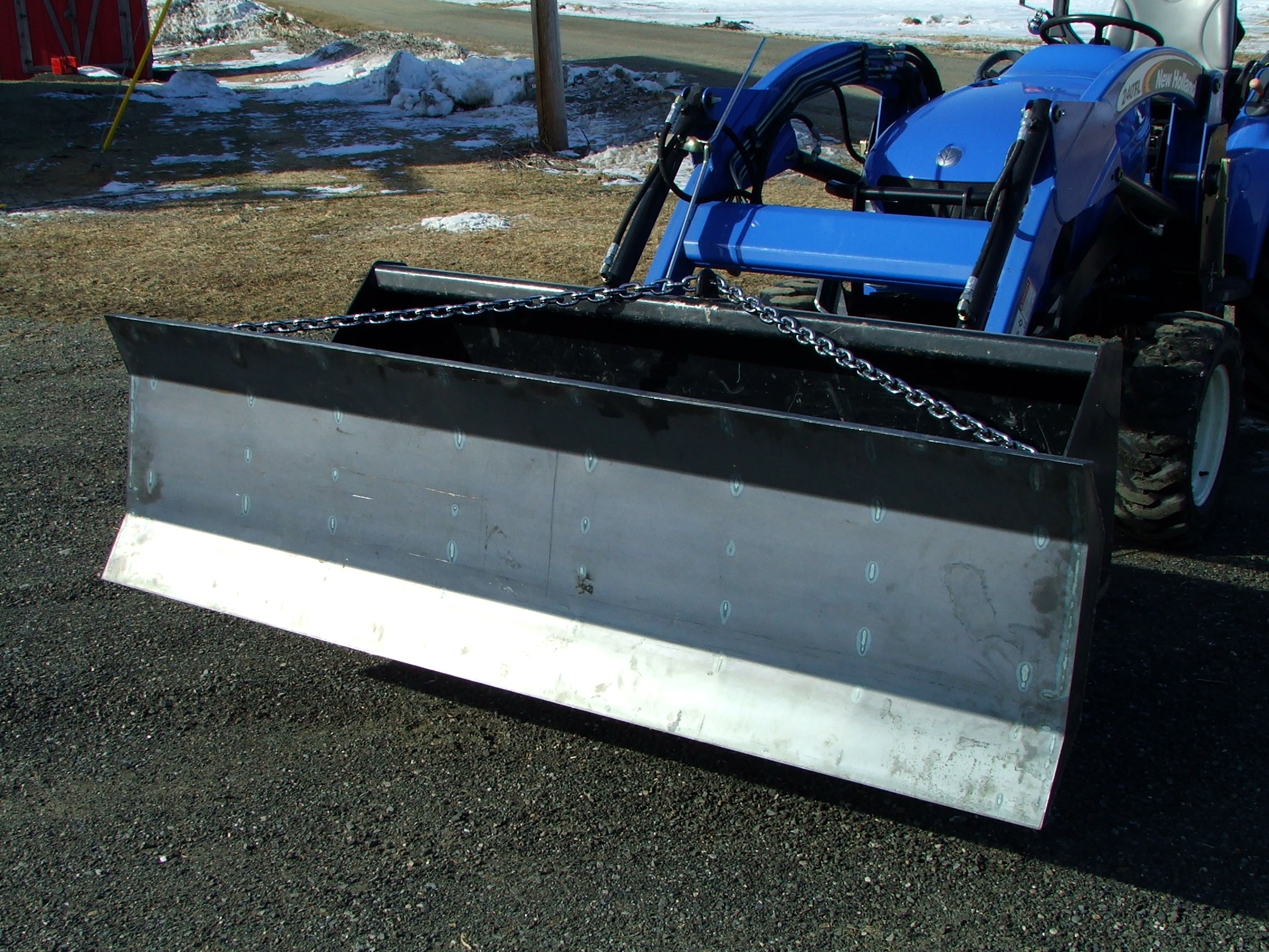

Cutting edge is on! Now to add sides.... Next weekend.
Played around with it, works well even in the hard frozen snow we have currently, or at least what's left of it. I suspect it'll be much easier to use once the shoes are on it.

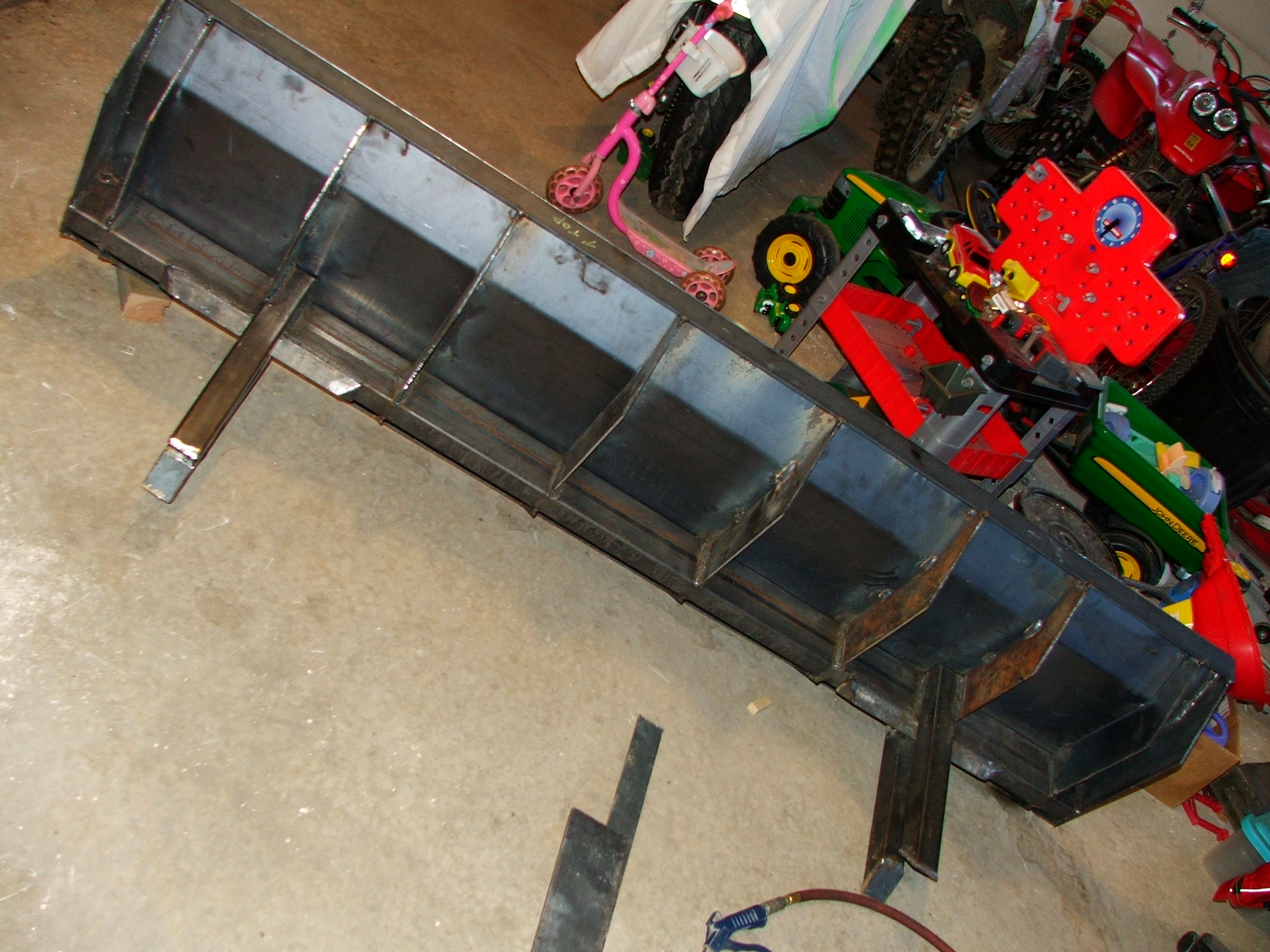

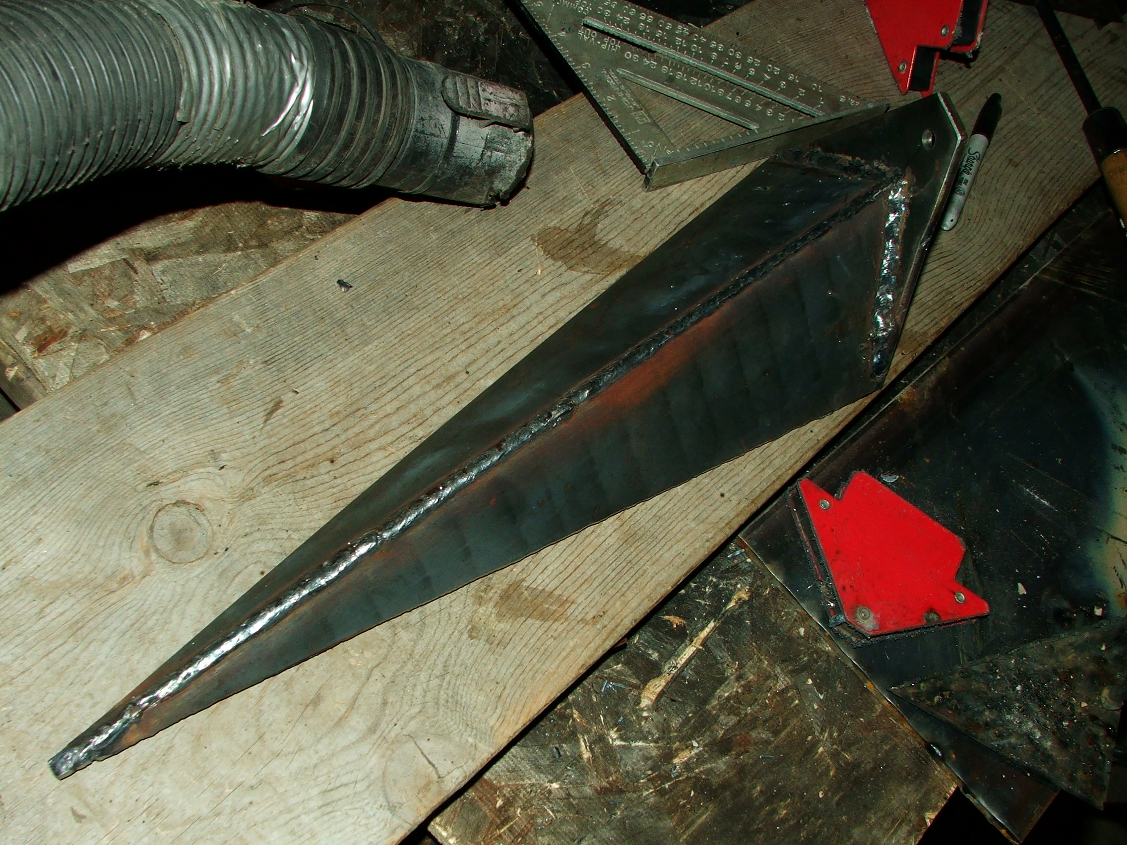

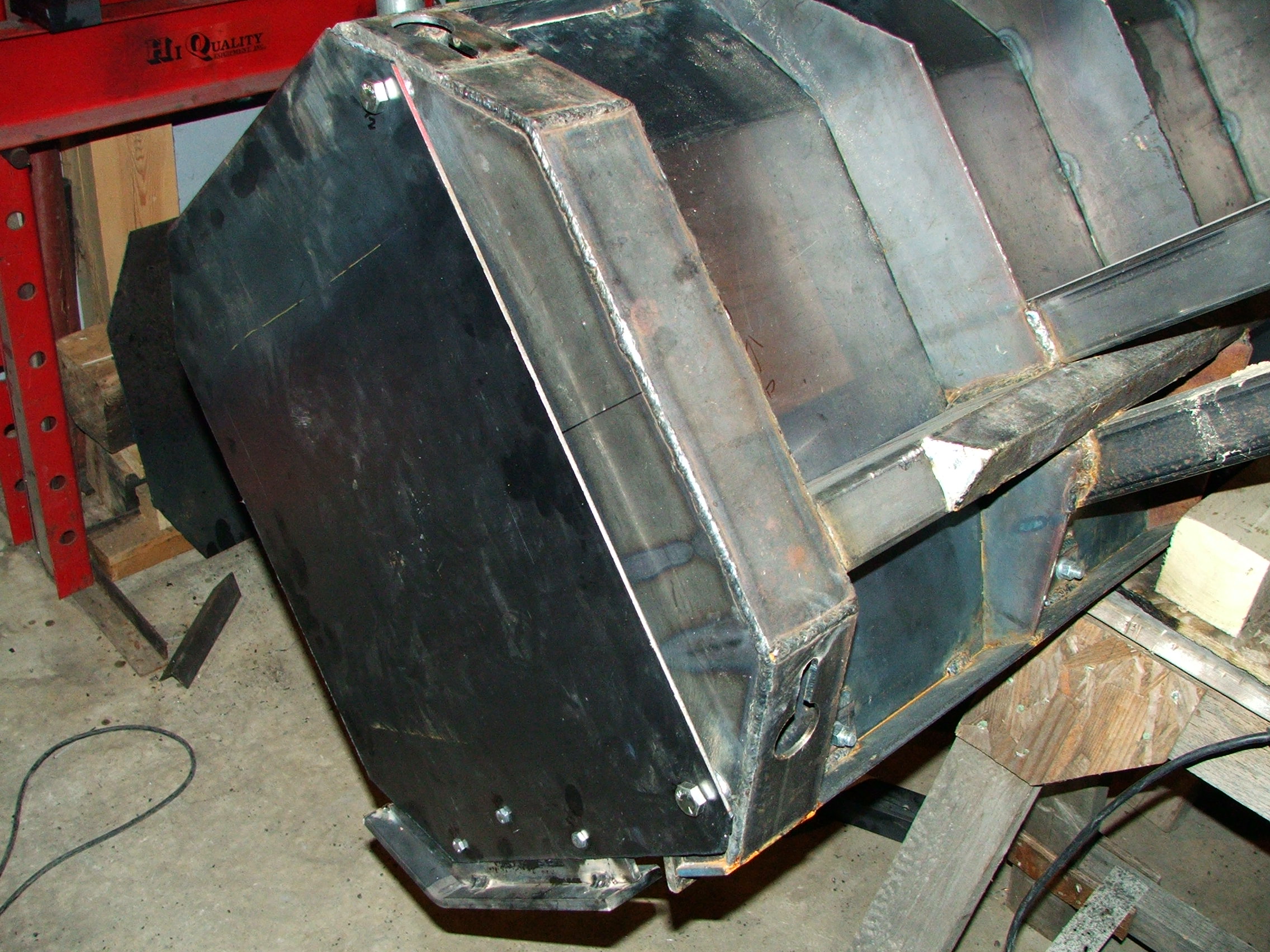

This has turned into a massive project. Worked on it from 0930 to 1900 and STILL is not done! Today made all four shoes (don't forget, two plows being made here) and vaporized enough metal to make all four end pieces, templates too, of course. Made a jig/template for welding nuts to ends of plow for fastening of ends. Woulda been MUCH easier had I decided this fastening method earlier in the game, like before the end webs were welded to the plow.
Also welded up a set of dies made from 1" round stock for bending the 3/8"x2" shoes in the hydraulic press. ****! Worked better than I ever would have imagined.
Now need to weld nuts to end of 5' unit, then make fancy braces for stabilizing ends. Then.... (huge heavy sigh) SHOULD be done!
End pieces are experimental, using 1/8" leftover from bending of skins. Not so sure it's heavy enough, but......
Oh yeah, and dropping what I guess to be 200lbs of plow on a Ryobi 4.5" grinder is bad..... Wonder if they'll warranty it?:(

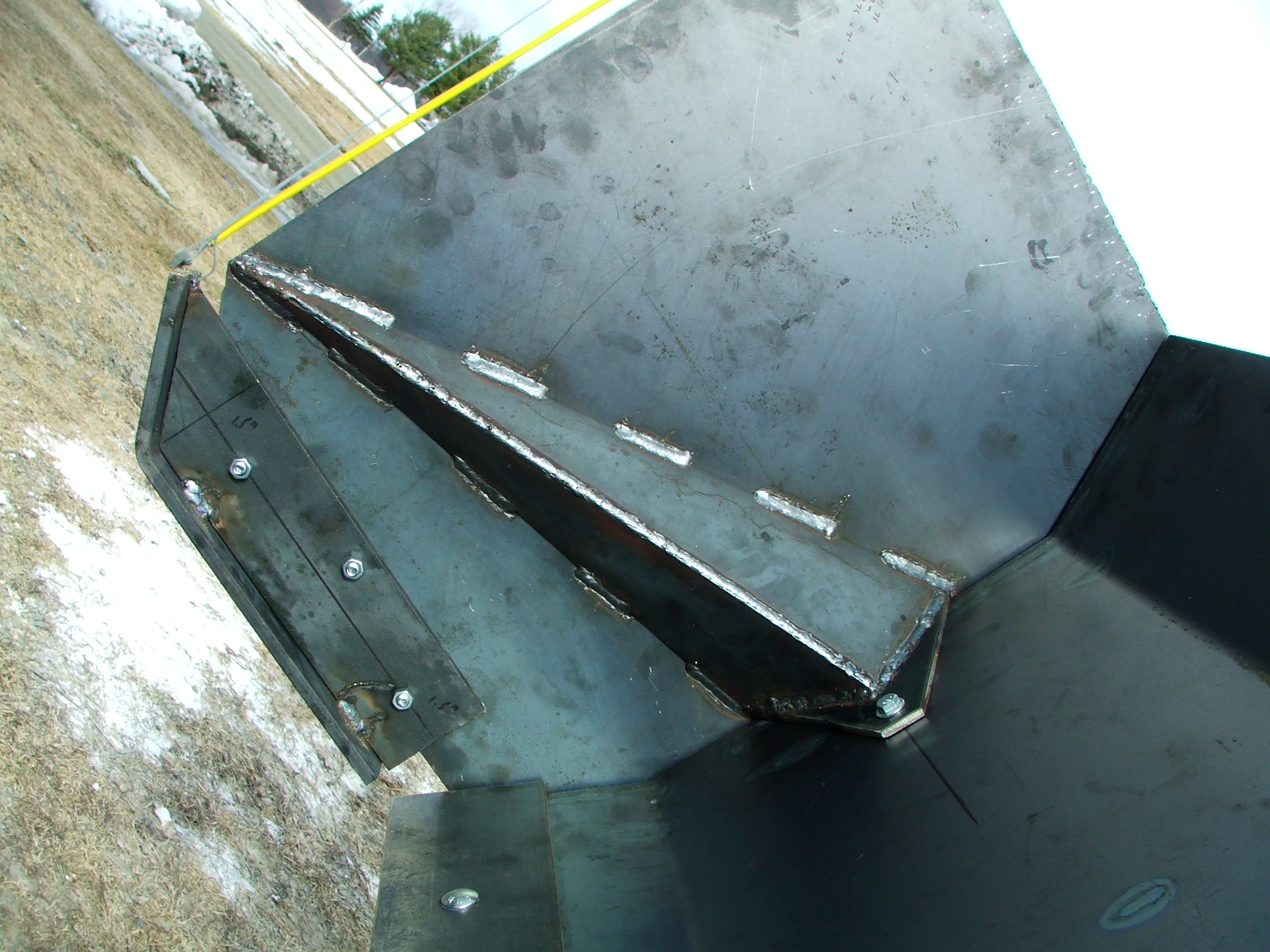

The reason the sides are short is because it's all I had for material. Curse these steel vendors who won't sell less than a full sheet!
Anyway, very close, should be done mine within an hour's labor. After today's measuring, calculating, duct tape mock-upping....... My cranium hurts!

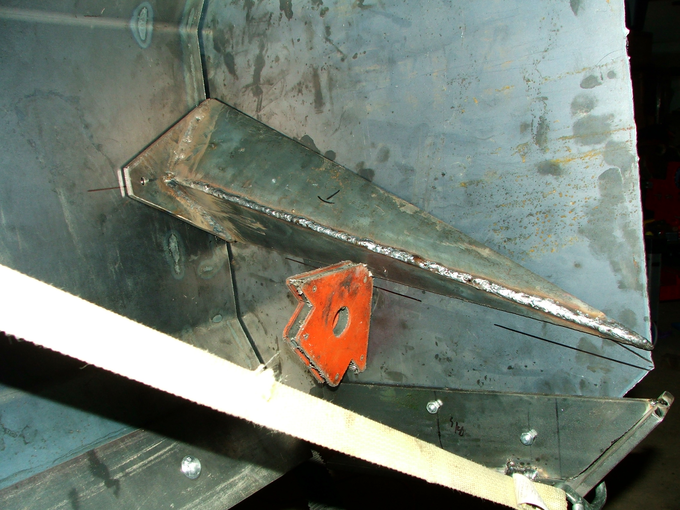

May end up doing a spar style support on the 5' blade due to time constraints and testing. Anyway, here's a pic of mine ready for the fancy type spar. I really like the eye appeal of the angular build.

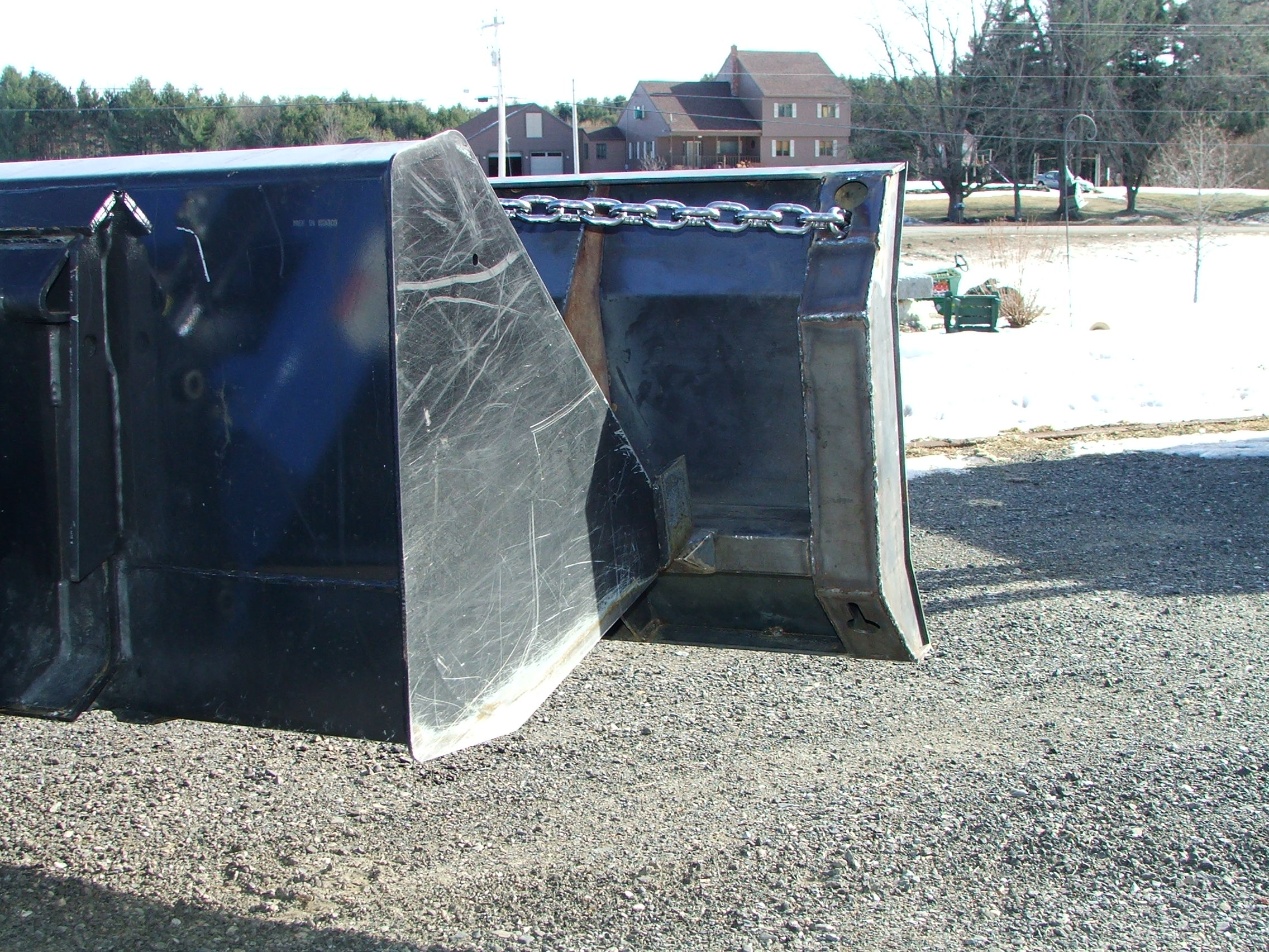

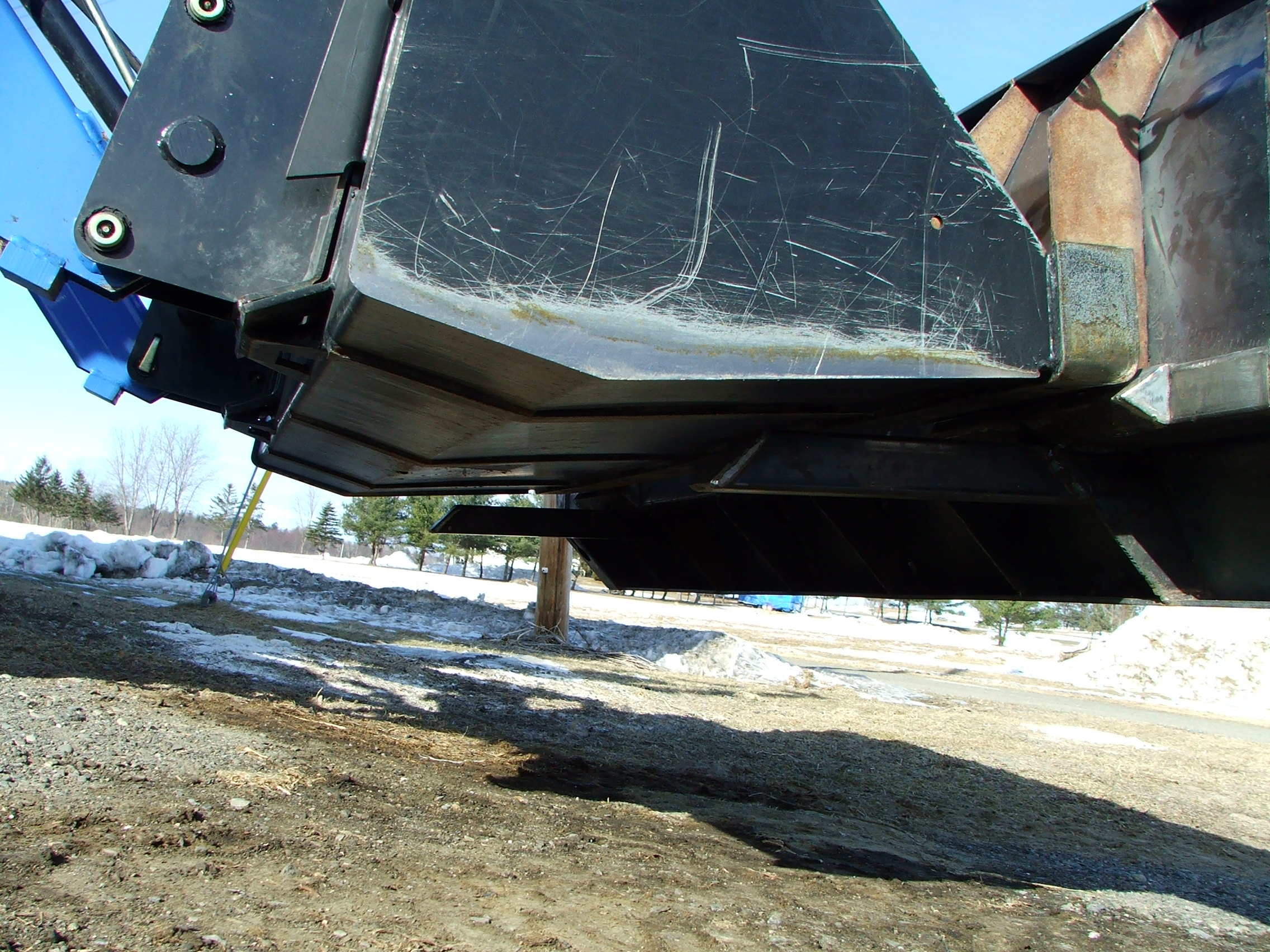

Finally (huge sigh of relief!) the 7' unit is done except final cleanup and paint. All I have left on 5' unit is drill sides and fab spars. A few hours.
Took it out and abused it on what is left of our snow. Seems to work and didn't tweak anything. Yay!
