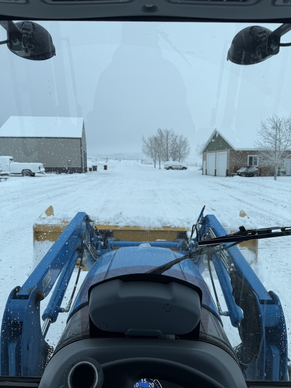

Cleared this last week with a new-to-me 8' pusher. It was roughly 8-10" deep. Definitely pushes better on the downslope, but chains could certainly help with the other direction. Decided to groove the a bit to see if it will grab better when I get a full box. Definitely moves the snow faster than my plow truck with a straight blade (parked on the left there)
