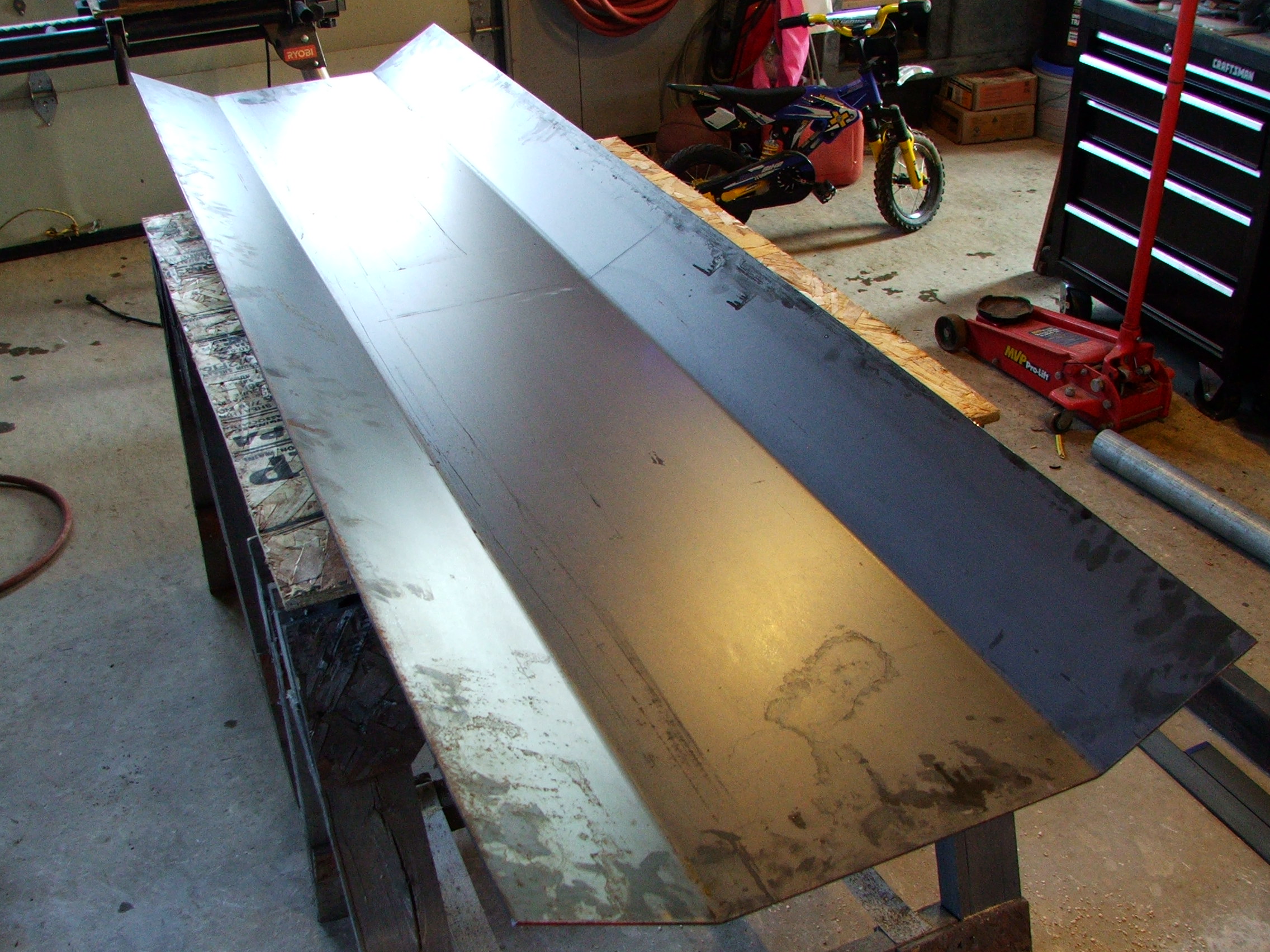

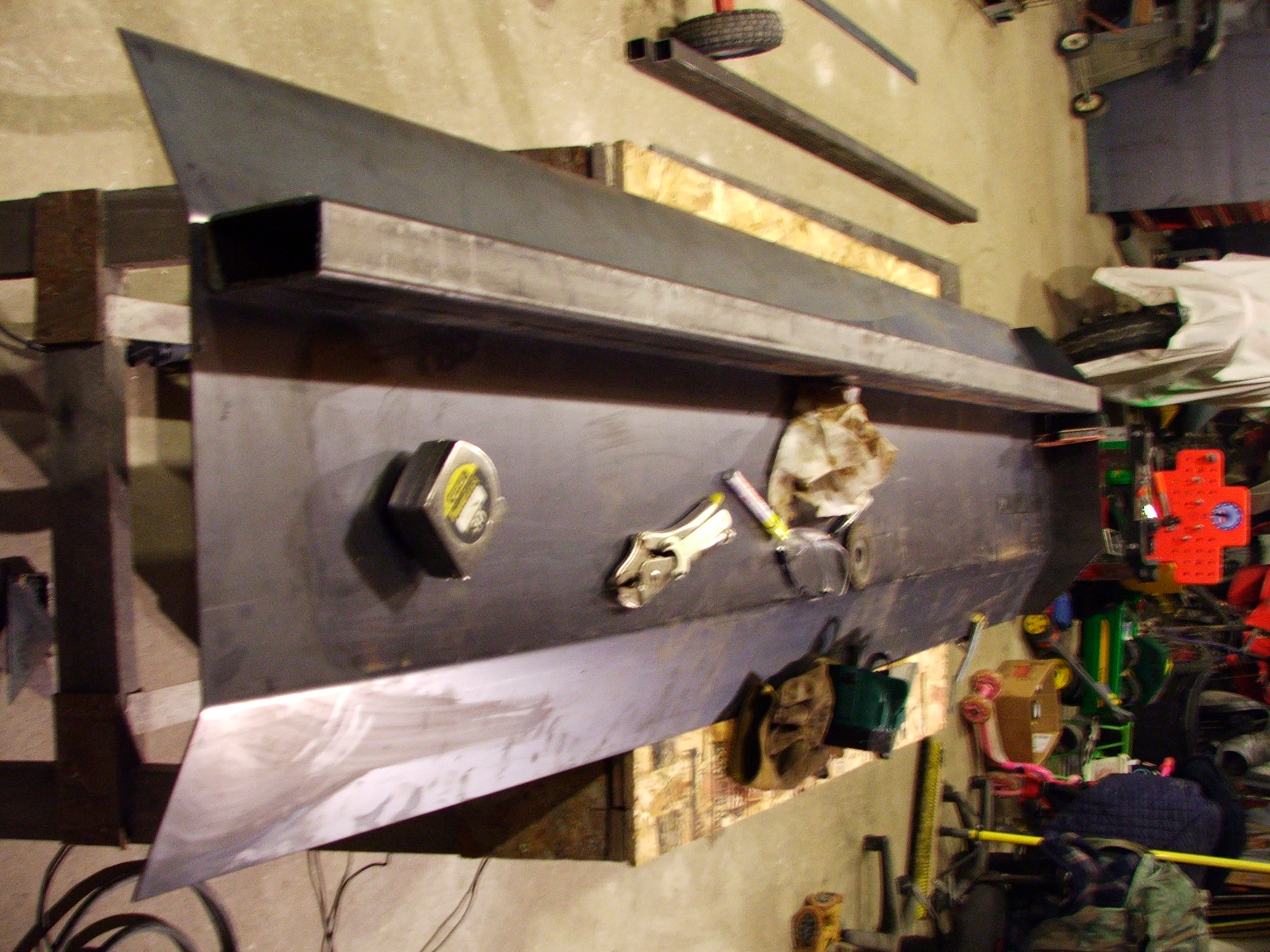

I finally started my 7' snow pusher. I'm also building a 5' at the same time for a friend. I'll keep posting as I move along.

Todays work:

Very nicely done! It will look great when its done.

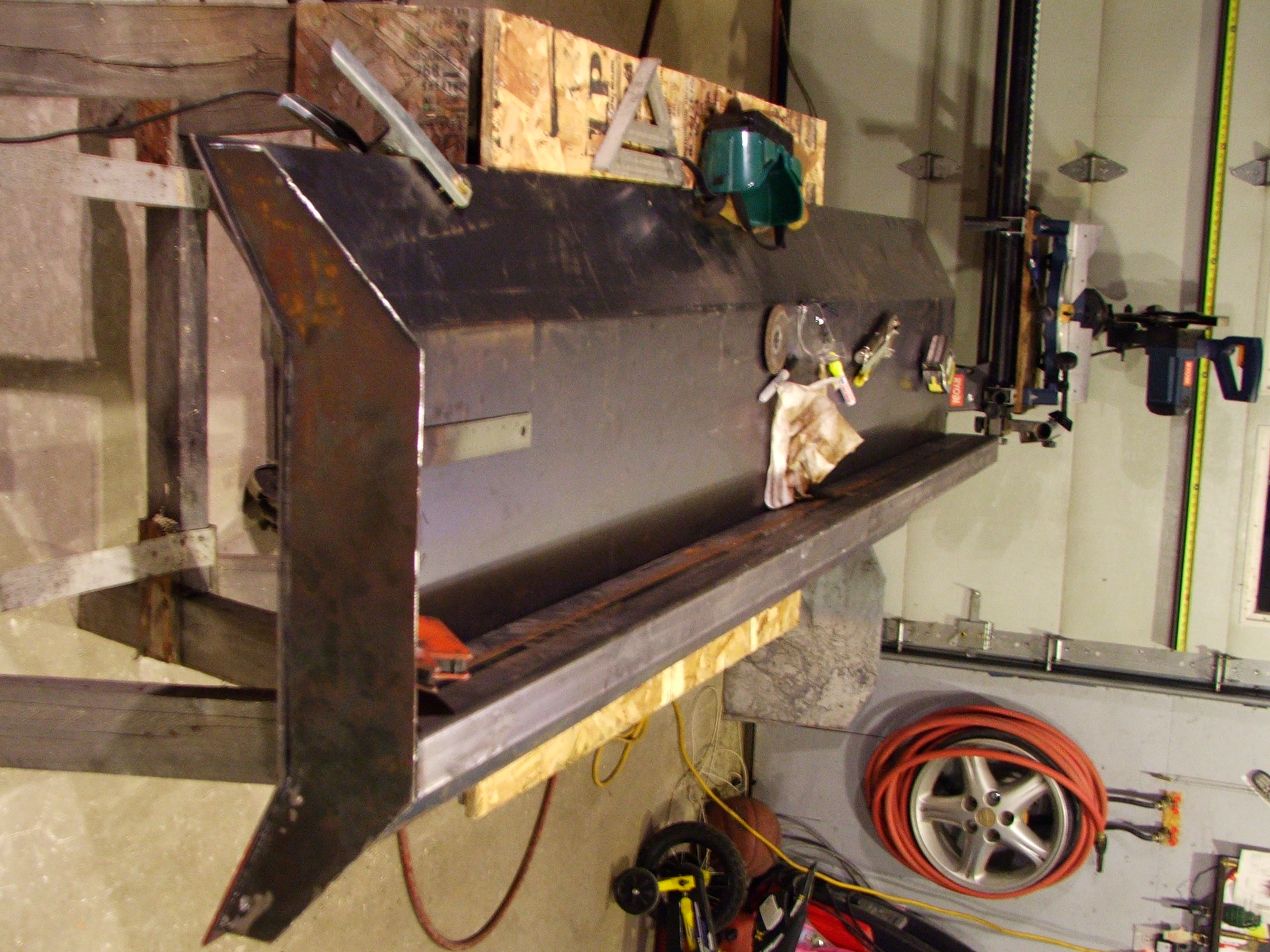

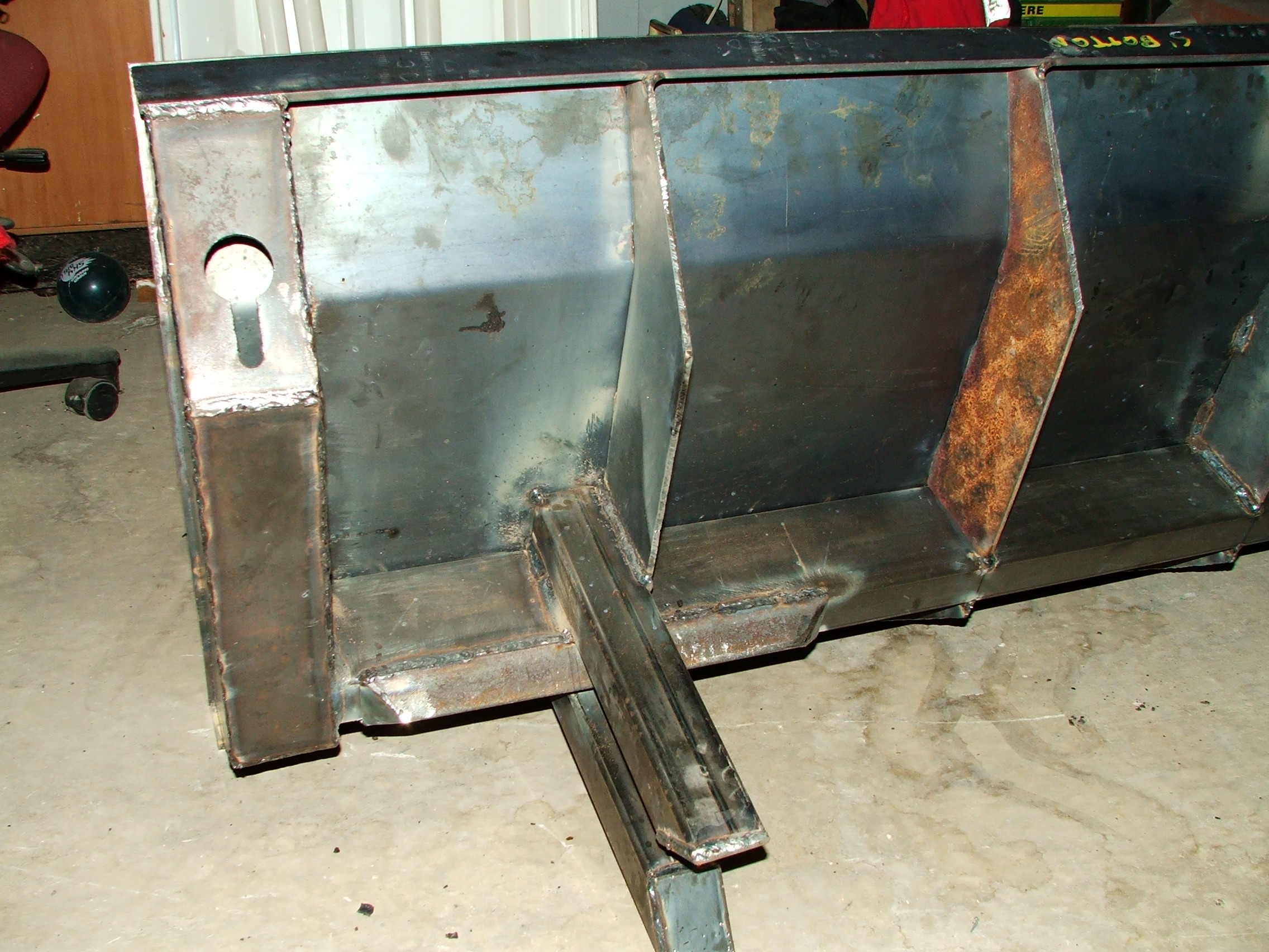

Day 3: Last nights pic was just a dry run with nothing welded in place. Made a little progress today, but still have rest of webbing, cutting edge, and a few other things to add. So far, as far as engineering goes, I'm happy. I have about 25lbs of rod that was given to me and am less than happy with the results compared to the 80AC stuff I've been using. It's a solid weld, I just don't like the finish.
Too bad I gotta head for work in the morning. I'll be able to do nothing but think of more things that need to be done until friday!

/ Snow pusher build #8
I made one of these from an old snow plow that had the whole corner twisted away. Anyways. This is a perfect use for the two bucket hooks on the end if you have. I just use one chain on each end of the plow up to the grab hood on the bucket. Not too much slop to it either. It works better than I thought it would
Great build job.PS I have even seem aone fashioned with wood..

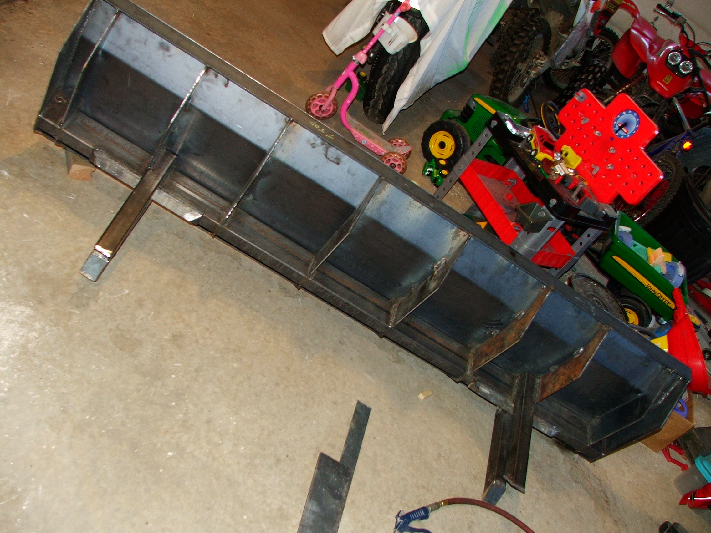

Sorry for the delay, missed this one. Yup, I wanted the extra reach and the versatility of having bucket and blade wherever I'm working at the same time.
Project is now 99% done with just finishing touches like cutting edge and clevises left to add. I started on the five footer before the ADD kicked in full bore.
I did just spend some time in the field rounding off clumps of topsoil and peeling up ice with mine. Definitely needs a cutting edge, but repeatedly brought the tractor to a stop with good traction. No damage, and the three angle setup rolls snow nicely.

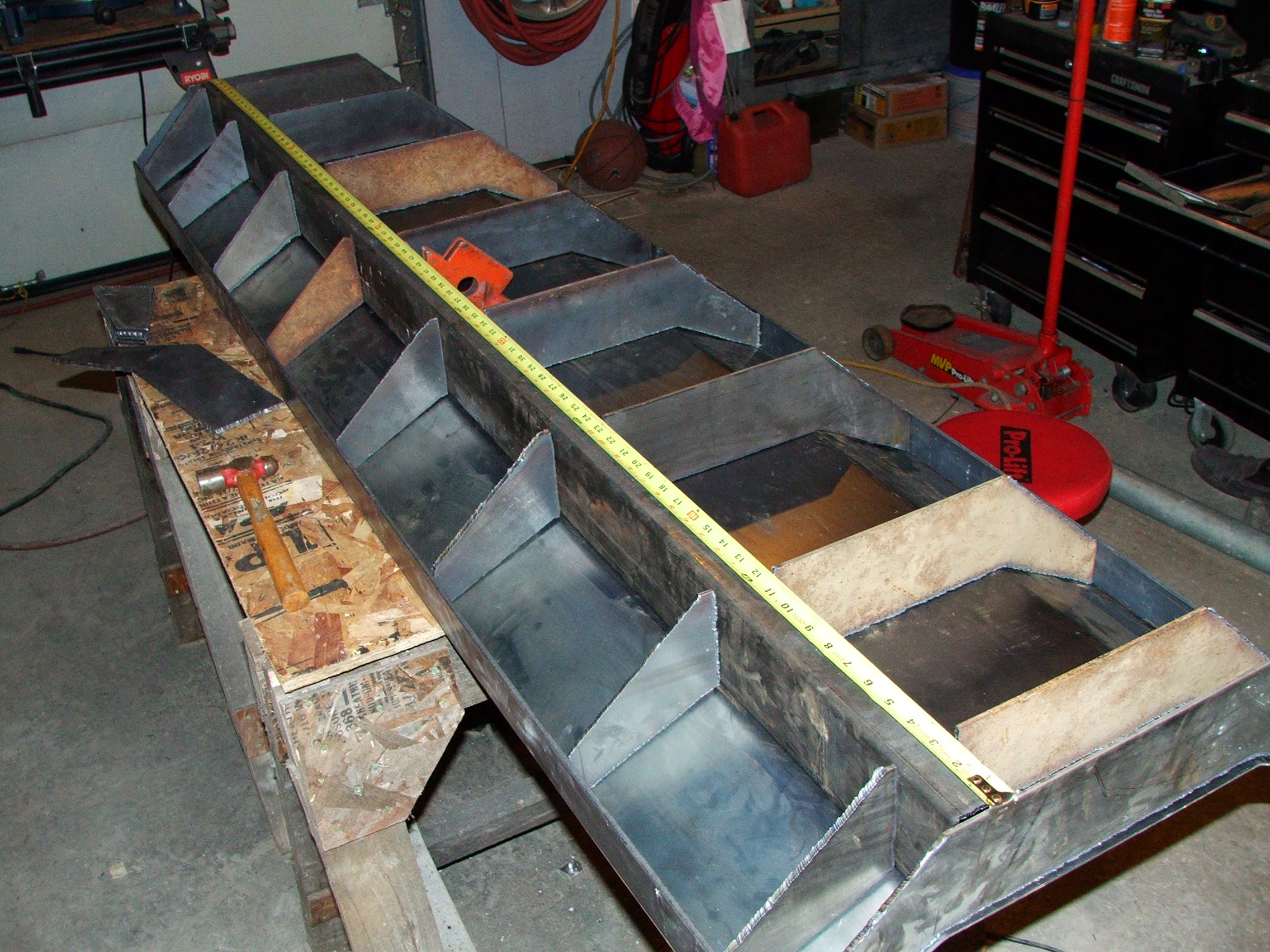

No sides yet, wanted to make sure it worked first. Not much has changed since last post other than all webbing is welded in.

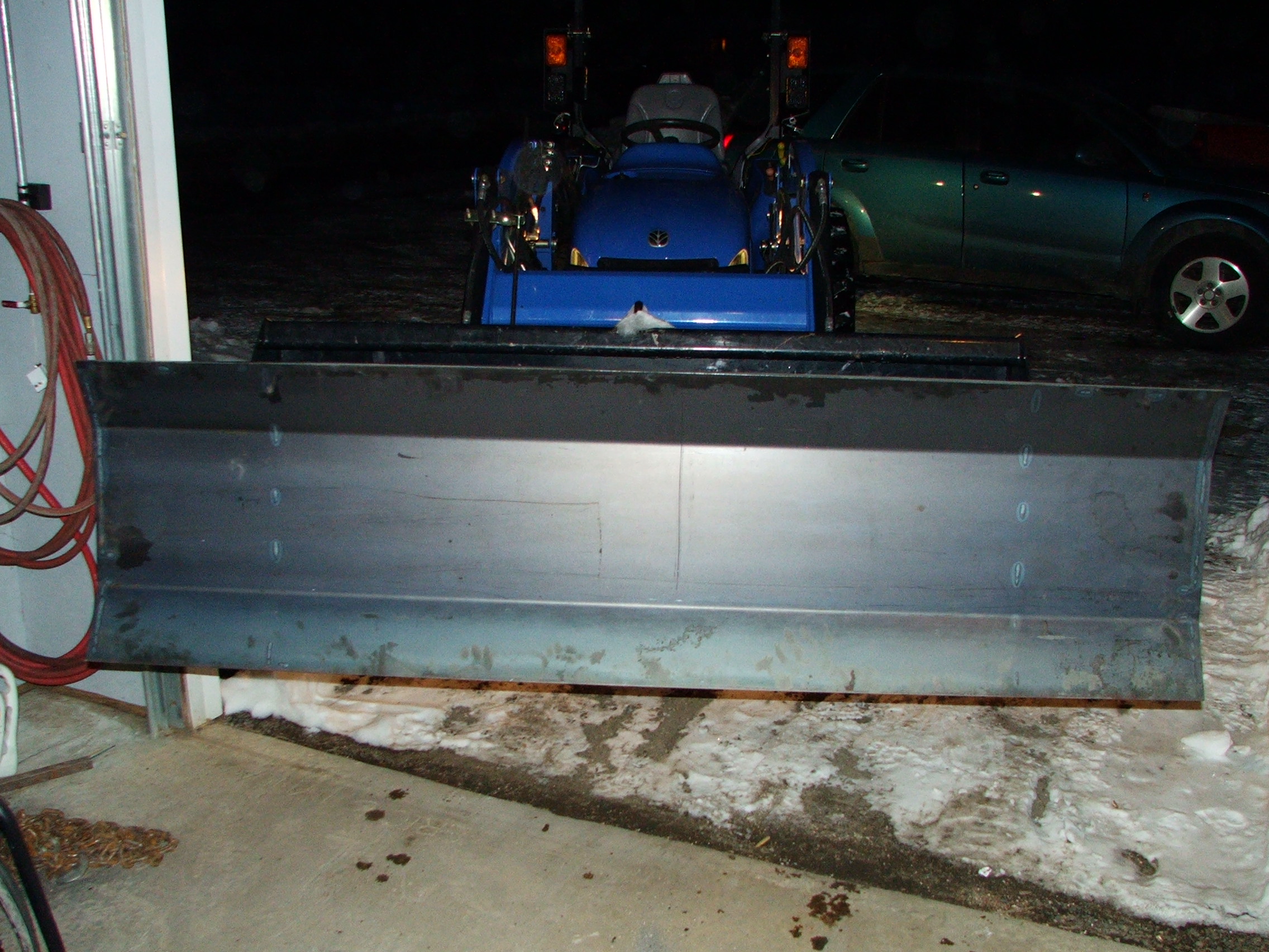

Just went down to restock the woodstove... Just happened to have the camera with me!

I like it..alot!!! :)

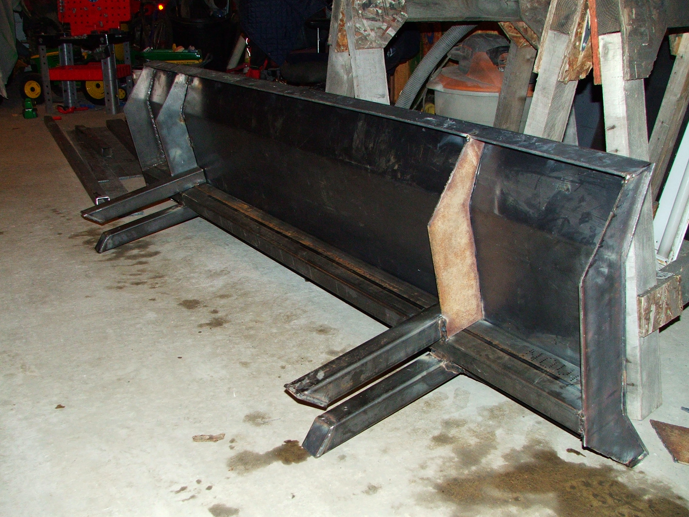

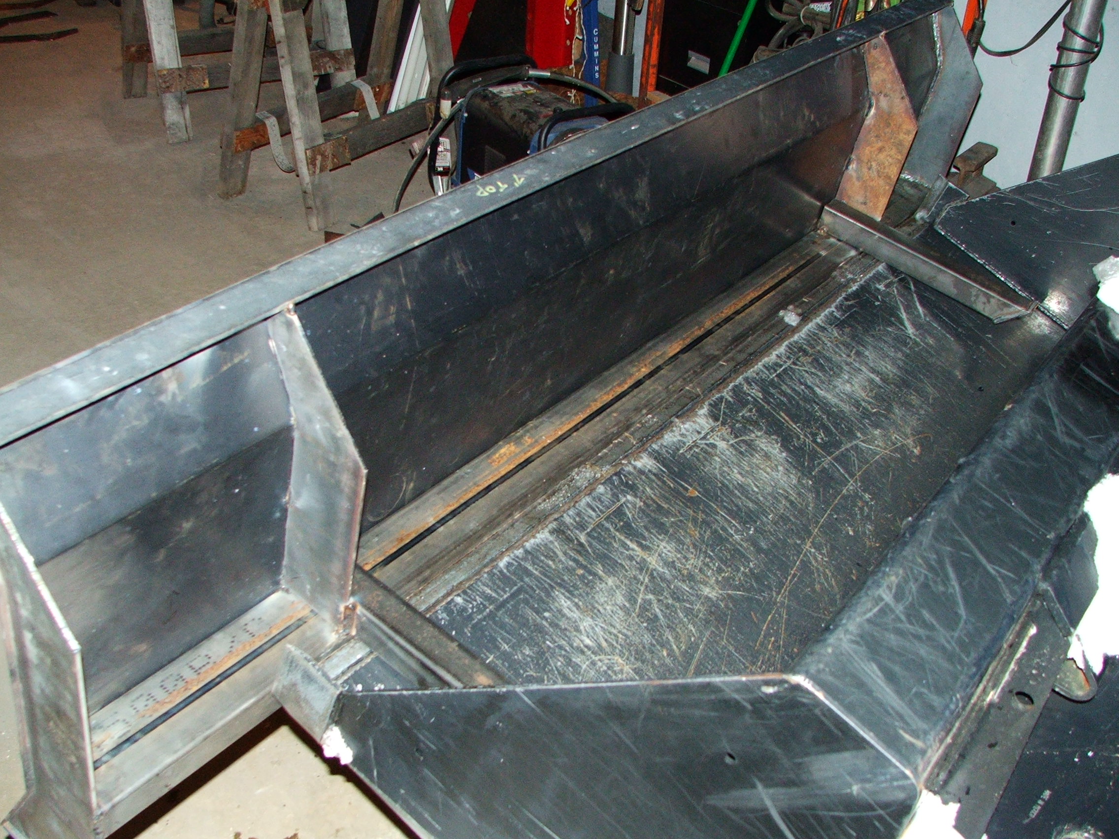

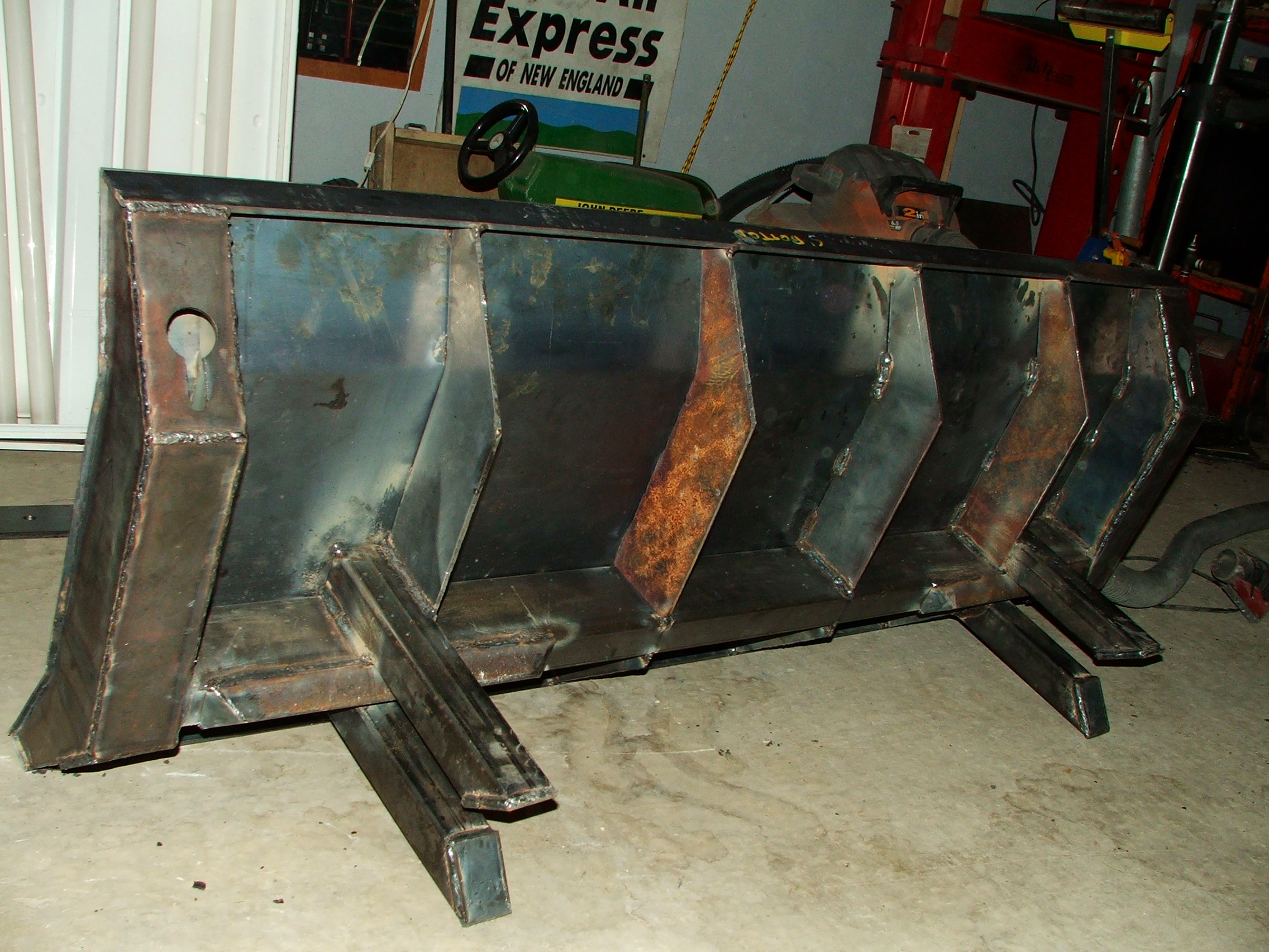

This thing done yet? Third weekend. Here's the five footer minus cutting edge. Looks like sides will be added later. All I have left on my 7' is to box in ends with snatch holes and add cutting edge. Again, sides will be added later. I need to source a 4x8 piece of 3/16" or 1/4". My local steel vendor won't split sheets and I can't justify buying a whole one.... Unless someone wants to buy one of these.:D
Welds are solid, but look like crap. I'm using a lump of FREE 7018. Price was right, but T80AC's make a better weld.

Very Nice job Haymaker!! Probably can't wait for some new either?;)
OK here's one of those stupid quesition that said I'd ask when I first
signed on, what holds it on the bucket? I see chain holes in the corners,
I'm thinking they go back to some hooks on the bucket with chains?!
Ok How dumb am I ?? :D

Very nice job, I'm saving this project to my favorites ( it just so happens I have everything to make one.......the reality is, I'll never find the time to do it). I'd like to barrow your design anyway, can I ask what angle the sheet metal is bent at?
