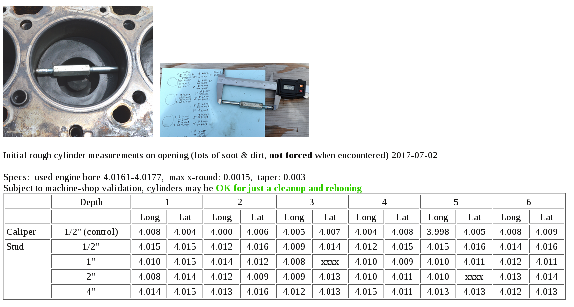

Opened the engine, not to bad at all, the cylinders were dry like the engine had not run for ages but provisional measurements are in the acceptable range so a rebore may not be required (maybe some kind of refinishing and then re honing). The crosshatch is quite visible in may places, I never built an engine that didn't need a +20 or more rebore. Tomorrow I plan to look at the pistons and bearings. I still don't know why it would not fire.
Another peculiarity is that watching videos about this engine and the p7100 pump I was under the impression that the pump lock-tongue would be visible at the proper timing BTDC, in this case 12.5 degrees . So I set the engine to TDC and backed off 12.5 degrees expecting to then see lock-tongue, but never did. Finally saw it if I did NOT back the engine off at all i.e. it's visible ALSO at exactly TDC. I'm a little confused, could it be that someone had improperly installed the pump, which then resulted in realy poor performance or total inoperabilty, and ultimately engine condemnation explaining that it hadn't run for maybe a couple of years?
I'm going to get these readings validataed in a machine shop while also getting the block hot-tanked. No rebore would mean (maybe) no new pistons and no boring (around here these two alone go for about $1800cdn).

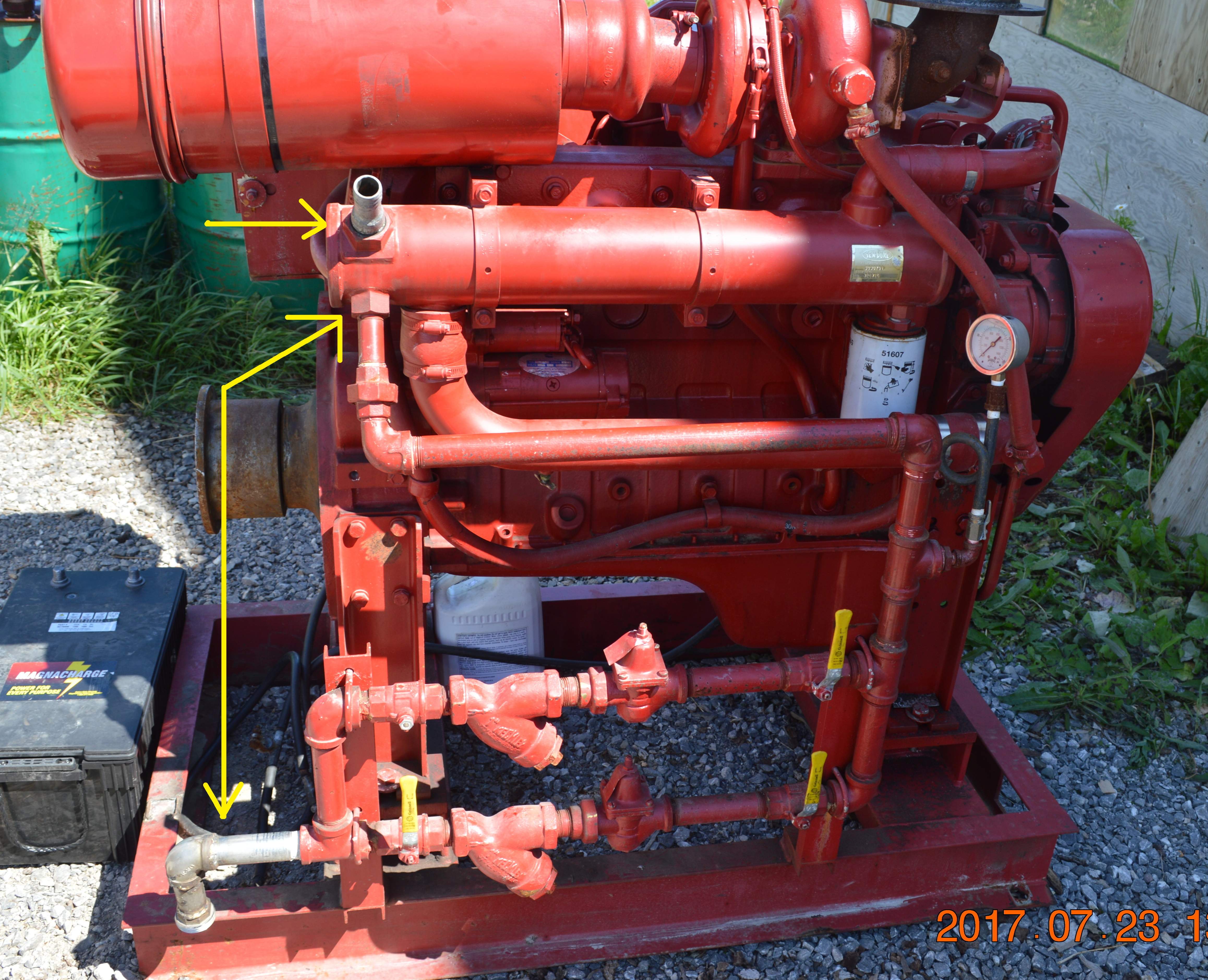

Just bagged another engine, now I have one for the truck as well i.e. this one is better suited for the blower. It's a 1998 industrial 12-valve suggested earlier in the thread by several members. It used to be a fire pump in a factory, they pulled it for unknown reasons. It gives me the flywheel housing that I want as well as more power (208hp@2100). I've never seen one of these and have a dozen or so pictures with questions but first things first.
It has a custom cooling system shown on this picture, and I need to hook it up to a hose before any extended running beyond a few seconds. The reason I need extended testing is the presence of some questionable sounding coughs above idle, could be nothing, or more.
I presume the upper arrow shows the outlet and the bottom ones the inlet line. What I do NOT know is how it's made inside, it appears strange (to me) that the inlet should be right next to the outlet unless there is more elaborate internal piping.
Once I get the cooling done I'll need to set up an oil pressure indicator but only if I cannot get the provided one to work (a later topic).
While on cooling, the existing system will have to be removed because it's water based and would freeze up in winter. If I use just coiled piping instead of a radiator (or a radiator) then the jacketted approach will not be needed.

That appears to be a water to water heat exchanger such as would be used on a engine on a boat so that you run your lake or river water through the small pipes that you have identified as in and out and then your coolant runs through the larger pipes. If you were to look inside the long tube there is probably a U-shaped piece of copper pipe with fins on it that goes from the inlet to the outlet and is surrounded by the engine coolant.
