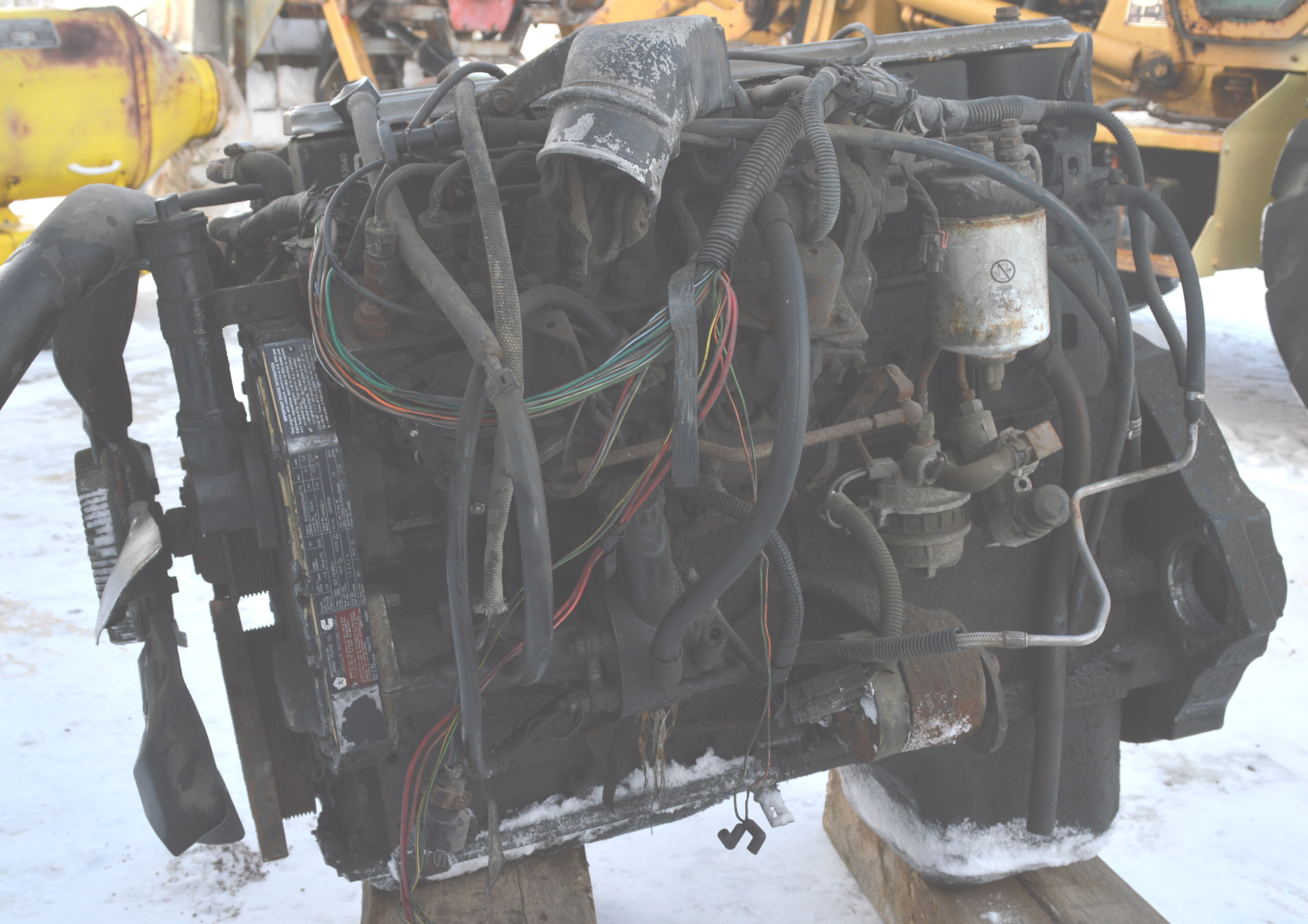

Those adaptors come out of truck like a single axle Freightliner or equivalent. They are readily available on eBay. I paid $600 CAD for the whole setup in post #108. I don't know what they are called. The same adaptor is available for just about any engine as it's a common mounting method in larger trucks. Start looking around for a truck wrecker in your area. I'm sure they either have one ar can get one.
They are available for a cummins with a starter mount on either side and also higher or lower on the block. Just edited to add that if you see a picture of one with a mount provision on one side, there will also be a mount on the other side.
One other thing I've been thinking about is that you are going to run into issues yet with the governor. Basically automotive diesel injection pumps only govern idle and top speed. In between is governed either by the foot feed (throttle pedal) or the cruise control. So if you want the motor to stay at the same speeds under varying loads you are either going to have to install an industrial style injection pump or rig up a cruise control of some sort to control engine rpm under varying loads.

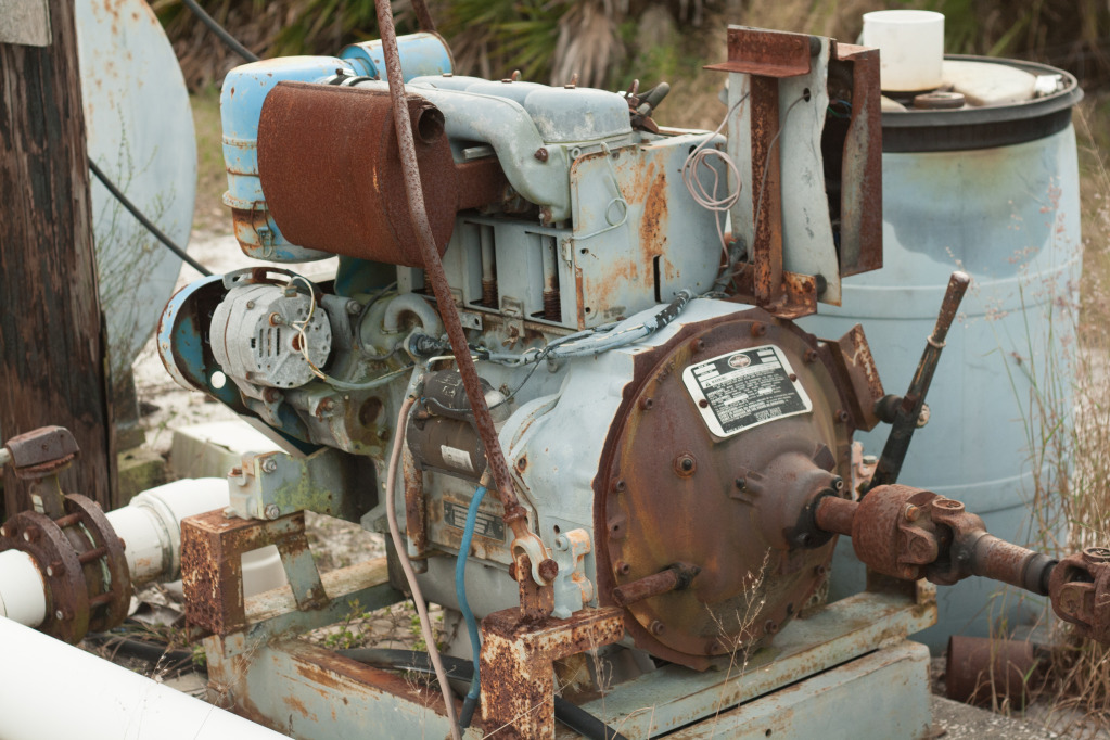

This would be another way of adding a governor. I'm pretty sure that this is what one of the previous posters had in mind.
The external governor is above the alternator in the picture. The throttle cable is attached to the governor and then there is a rod from the governor to the carburetor.
This is on a Versatile swather with a Ford 200 engine.
