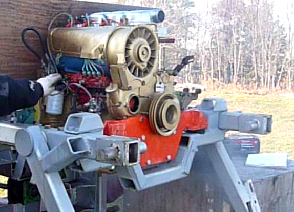

I wonder if this is going to require a "out of the box" engineering solution.
In a normal blower the auger gathers the snow and feeds the fan. The fan clears the auger and blows it through a chute to the side. What if a person had two fans? A conventional auger and conventional fan requiring the normal amount of power to do their job, and then another fan beside the regular fan, turning much faster, and all it does is suck air. It blows air through the chute at a high velocity, and the chute from the conventional setup blows into the high velocity air chute. The higher velocity chute would act like a venturi (a sandblaster gun if you will), the snow would mix with the higher velocity air and be thrown farther.
Not thrashing the snow around in the conventional blower at a high speed might require less horsepower.

/ Snow PUMP #137
You might look into the clutch housings as used on irrigation engines. I know they make them for PTO shaft drives and would expect they have them for belt drive also. That would give you a set up that could take the side pull of belts. Lots of 6BTs are used for irrigation, so you might find one used.
/ Snow PUMP #138
OK I sent these from my phone and I'll edit them on my laptop because that's just easier.
The first picture shows an adaptor and bell housing from a wreaked Chrysler 727 transmission. Notice the starter bolts and the 8 holes where it bolts onto the engine. I noticed that the Cummins you have still has this adaptor installed. They come in different configurations for different transmissions and flywheels. Notice how much narrower it is than the picture of the SAE housing I posted in post #108.
The second picture is of the pump housing of the 727. This would be really easy to machine out for a support bearing for an output shaft.
The third picture shows the transmission case from the side. It would be easy enough to modify the case so that you can run a belt if you end up going that way.
Also manual transmissions have a similar setup only they have room for a clutch inside.
