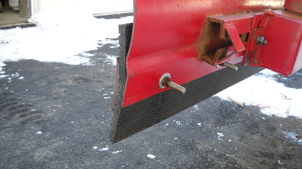

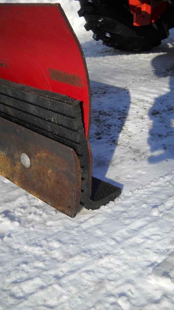

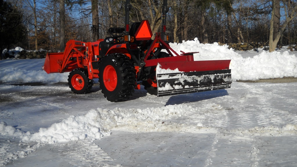

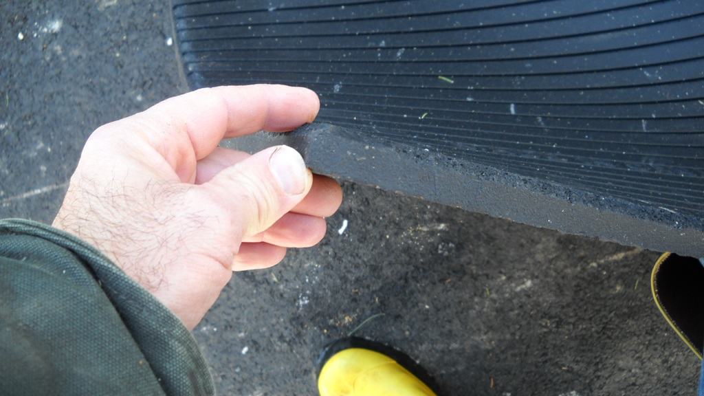

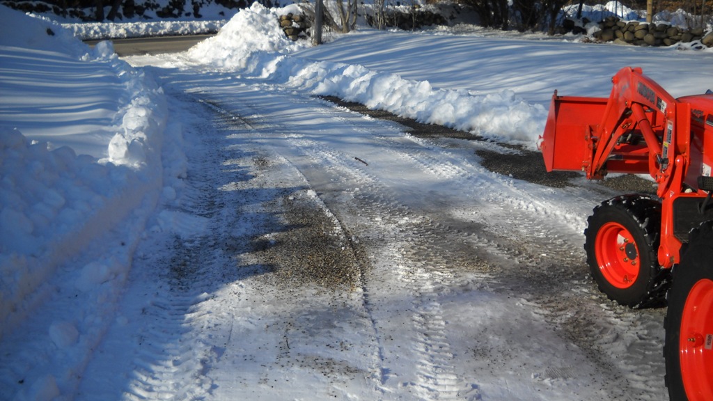

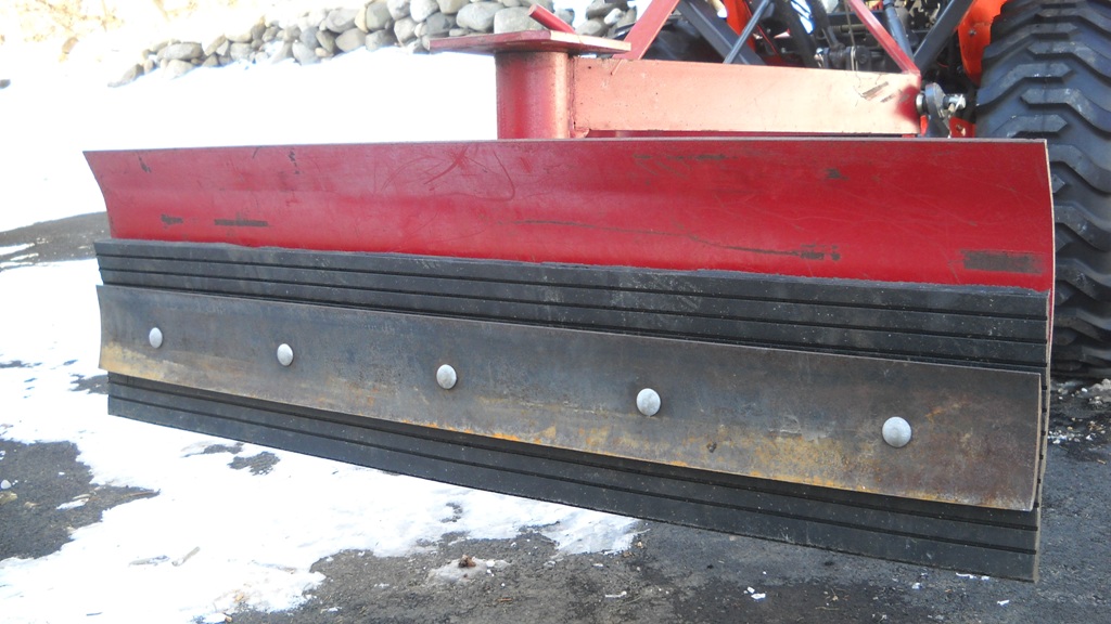

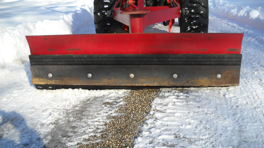

I just thought I would share something that I think worked really well for me. I knew well ahead of time I was going to be frustrated this winter plowing my newly installed stone driveway so I began to look at ways to mitigate the effect the cutting edge on my rear blade had on the gravel surface. Someone in the past posted how well ABS (not PVC) pipe worked when fitted to the blade edge. Sounded like it would work and purchased a 10 foot length of 2 inch for $20. I gave it a shot (well two shots). After the first storm of the year (12 inches) it worked like a charm....well almost until right at the end of the plowing the stone wore it down to the point it just cracked. I replaced with the second piece and it too showed major wear so it was evident this ABS pipe route was not going to work.
I then remembered someone here stated how well Horse Stall Mat worked as a blade edge (Tractor Supply 4'x6' mat - $39). So I run out and picked up a mat, cut a strip and bolted it on. The next storm (18 inches) it worked like a charm - actually pushed the majority of snow with almost no ill effect to the stone (which is small pea like gravel).
So, I now have an awesome snow blade for gravel, it wears like iron (after plowing showed no wear) and I can use the remainder as a nice foot mat in front of my work bench until I need to make another - hey I have enough to make 4 more!!!

Forget 1/4 inch'ing - as you can see I have 3 inches of the mat expoused below the cutting edge - all I do is drop the blade until it just hits the surface although I can drop it down furthur if I need more down pressure on the surface in one of the pics you will see it smashed on the ground and even under this condition the blade floated over the stone. I acually have more control like this than 1/4 inching. It would work just find with your 2360.

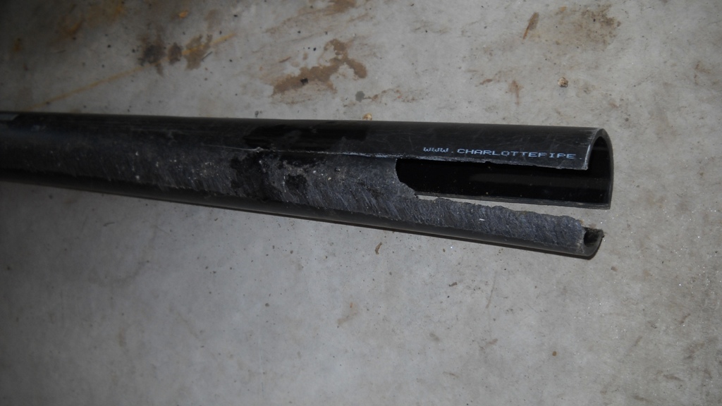

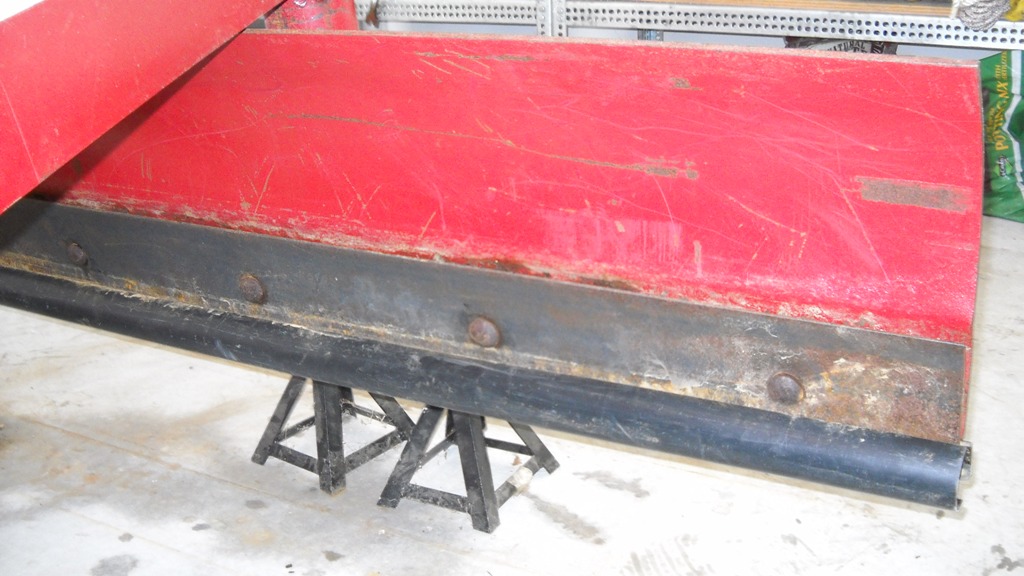

do you think it would work on a front mounted plow blade? I was going to go order some special UHMW pipe to put on the blades cutting edge ( Graingers $56/10' section). I tried the pipe last storm ( 22" ) but the cold shattered it. It did work awesome up to that point.
I am personally done with plastic pipe and anything to do with plowing. The stall mat material is very robust and resilient so I would assume it would work quite well when attached to a front blade lip - I would assume the cutting edge of the plow is bolted like a rear blade so it should be a easy install.

I did this before the winter of 2009-2010 for my backblade (plowing with JD2305). It came through the record snowfall winter just fine. I am still using the same edge. It works on my blacktop driveway whether the snow is powdery or 'wet'. In fact, last night I removed about 1.5" of slush from the pavement- it sort of acts like a giant squeegee! About the only thing it wont remove is a layer of ice. The idea was obtained from this site. If you do a search I'm sure that you will find more than enough info on the "how". I used a spade bit in a cordless drill to drill the holes in the strip of mat that was cut off a full sheet with a sawz-all.

I've been thinking of doing something like this but didn't know where to get the material. Also, I wouldn't have attached nearly as much to my blade as you did but I think that's a good idea so I'm glad I saw yours first.
Do you plow in reverse? If it's going to fold over like that, do you think it works better with the ribbed surface in contact with the ground?

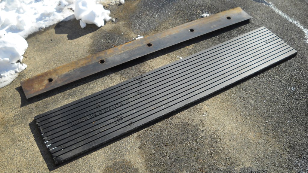

I bought 2 piees of 2" by 4' 1/8" steel and welded them together.
Cut it to the width of the plow.
Clamped the home made piece to the cutting edge with the bottoms lined up.
Drill 6 hiles through the bar and the cutting edge (this will wipe out some drill bits depending on your cutting edge).
Cut a piece of 1/4" thick machine belt 6" wide by the width of the plow+1" on each side. The overside allows it to be flipped over if needed for a fresh edge.
Use the home-made piece as a template to drill the holes in the rubber. be sure to center the piece with 2" top and bottom.
I used an angle grinder to slightly round the outer edge of the cutting edge and the bottom edge so it won't dig into the rubber.
Place the rubber on the cutting edge with the new bar on the outside and assemble with stainless bolts and lock washers.
I pulled the skid shoes all the way up and use them only for a resting point when the machine isn't in use. Place a couple of 2X4's under the shoes so that the rubber doesnt get deformed from sitting.
Done this with and ATV and 2 RTV's. Works great on everything. Doesn't dig up gravel once the ground is somewhat frozen. Won't dig into sod and won't scratch paved driveways.

It also looks like when it wears you can flip it over and get another years worth of use.

I used the same hole saw bit I bought to drill out the holes in my bucket for my tooth-bar. I drill one side almost completely through than drill from the other side - ya have to work it slowly since the rubber plug will be a #$@# to get out if you go drill only from one side and the plug seats itself in the bit.

I would agree I used more than I needed. but I like the idea of being able to not only flip it but reverse it if when the edge becomes worn and the fact I have a lot of material to squeeze between the metal edge and the blade. Make sure you get longer bolts!
Yes, I do plow in reverse and thought the same but ended up going this way as I wanted to have as much give to the edge when contacted with the ground. Its a work in progress so I may flip it but it does work great!
Yes but at the current rate that it wears it will be many years :thumbsup:
