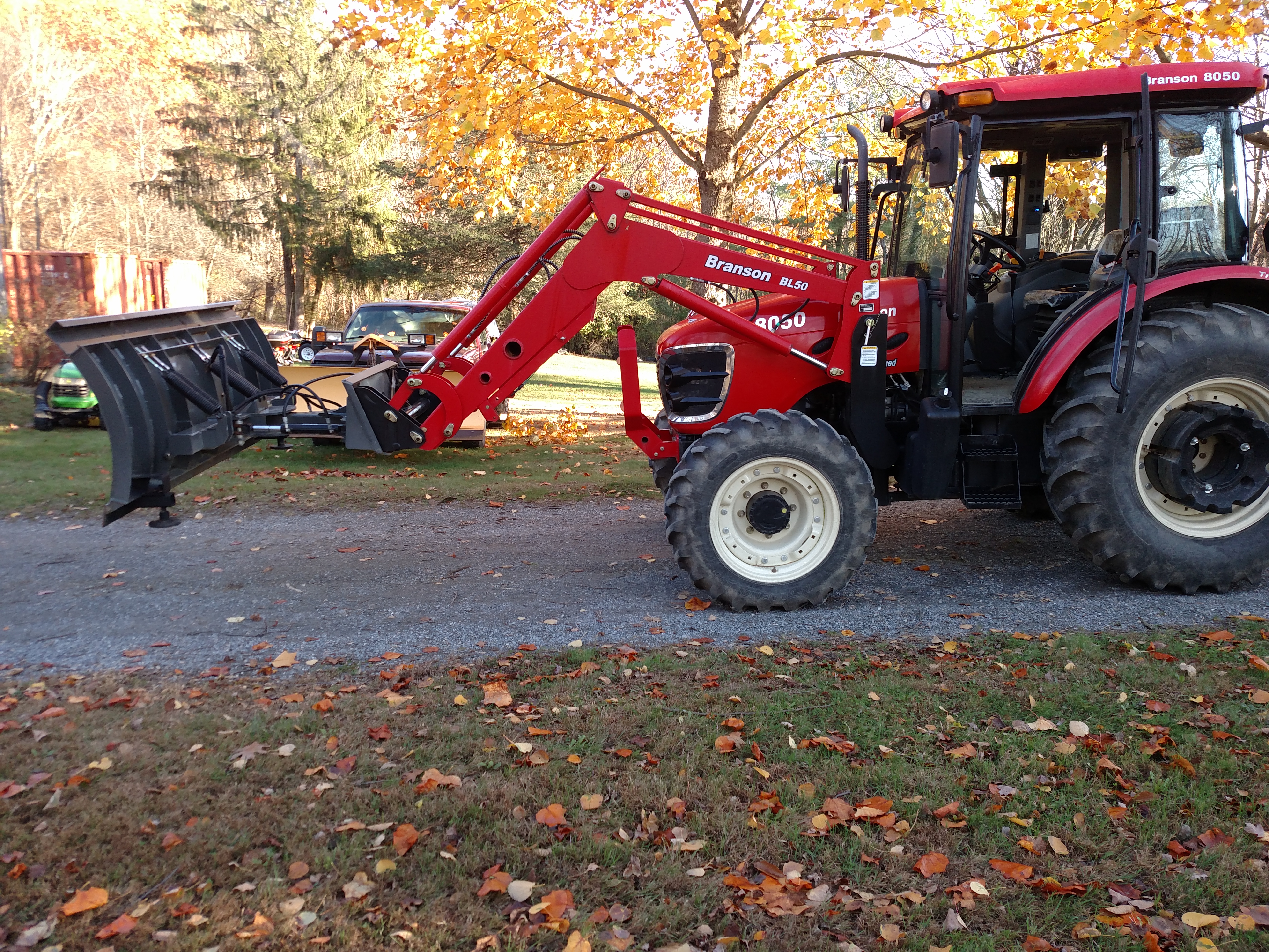

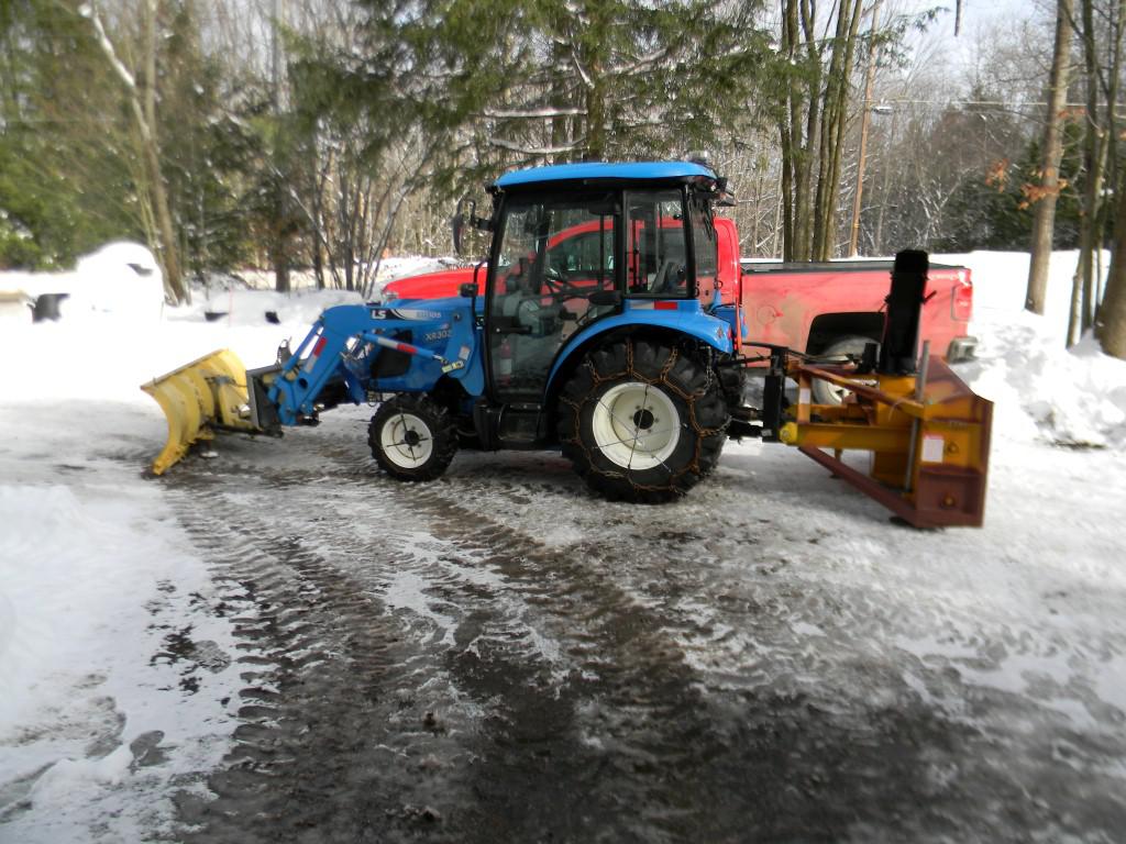

Mine is bottom trip but that wasn't a selection that I made. It just happened to be what was available. It helped keep the mounting frame higher. That helps eliminate dragging the frame on the driveway. Paul Short has a video where he mentions he had to add an extra pair of skid shoes to eliminate gouging the blacktop with the frame. I've only hit a couple things with it and the moldboard remains in the plowing position. I'm guessing that you'd be more likely to ride up over the snow if the whole blade flipped.

Nice rig.
Tempted to get a frame with lights.
Do not know if a frame with lights would work though.

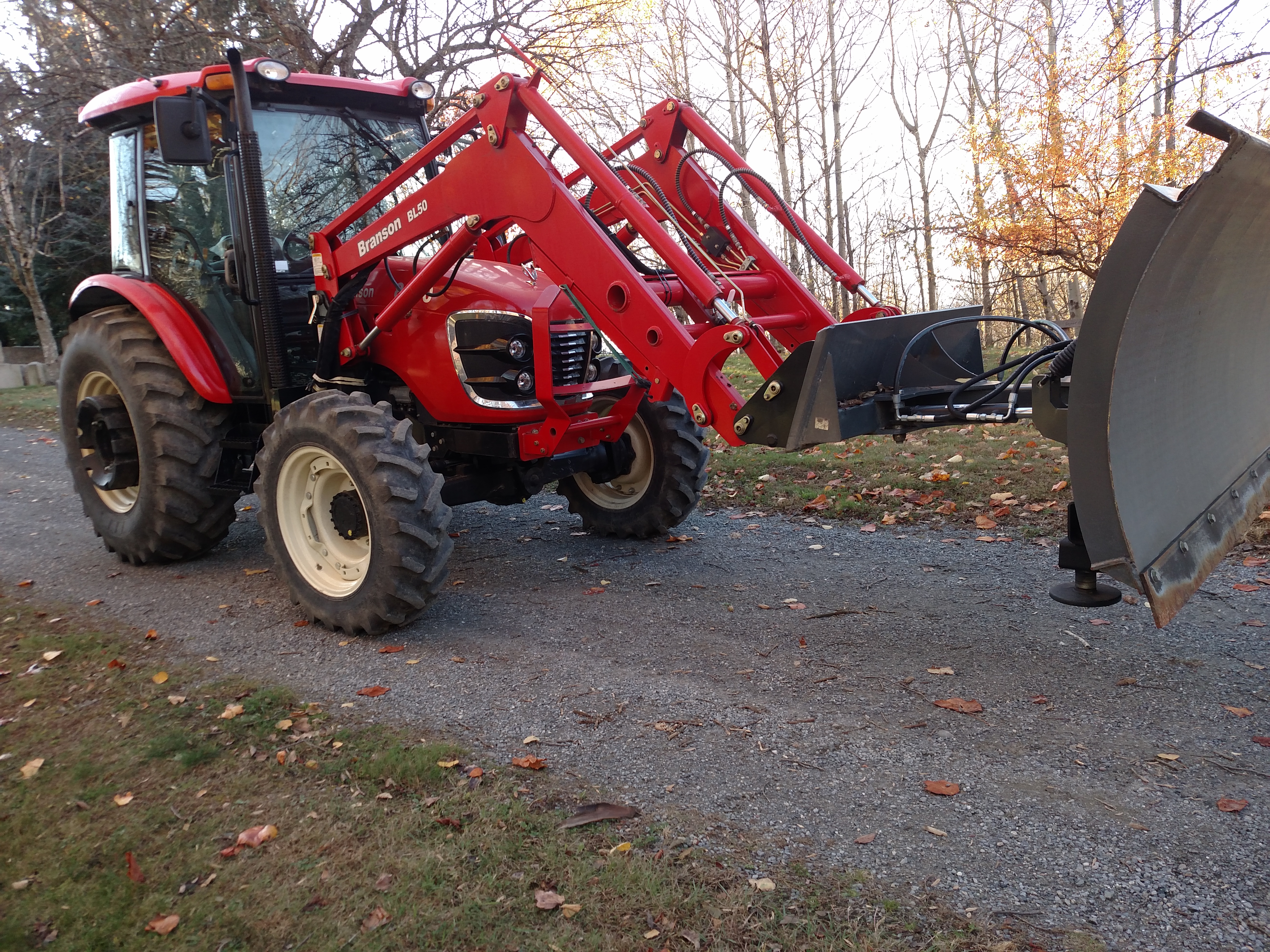

Mine is also a bottom trip (like Chims setup) and is 7 1/2'. I ran hydraulic lines from one rear remote to the front to operate the angle.
You mention lights on a stick? If you mean lights on a stick mounted to the plow blade I think that is a bad idea. I've seen lights mounted or attached to the plow and the vibration while plowing shook the bulb filaments loose. Mount your lights to the cab or ROPS.

Yes, planning on running a line from the rear remote.
Agree with your conclusion that the vibration from the plowing will kill the plow frame mounted lights.
